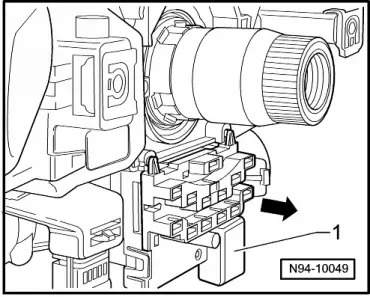

Also, I noticed my car doesn't have this under the "Steering Column"...
Not my car/photo
http://workshop-manuals.com/volkswagen/golf-mk5/images/golf-mk5-2424.png
Is it normal?
SWCM / SMLS before I had installed is 1K0 953 549 BC, now 1K0 953 549 CH (which is supposed to be compatible). The CH has like the space for this connector, which it doesn't exist in my car.
« Last Edit: June 09, 2016, 07:35:13 pm by supercati »

« Reply #8 on: June 09, 2016, 08:55:01 pm »
I sent that link as it recently resolved my g85 issues....
With regards to the above photo, your car does have it, it's behind the slip ring..

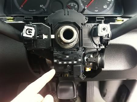

« Reply #11 on: June 10, 2016, 07:20:27 pm »
Here I am again with the updated requested @v4rley  :happy2:
With slip ring:
(notice this small metal piece there, I guess it is normal, right?)
After slip rinig removal... here's the weird thing: Where is my steering angle sensor???
Maybe with the other SWCM (ref BC) the steering wheel angle sensor what the slip ring itself? Honeslty couldn't find anything documented about this.
Should I buy a steering wheel angle sensor and install it? 1K0 959 654
« Last Edit: June 10, 2016, 07:29:47 pm by supercati »

« Reply #12 on: June 10, 2016, 08:28:23 pm »
Ah ok, looks like yours is built into your slip ring  :thinking:
