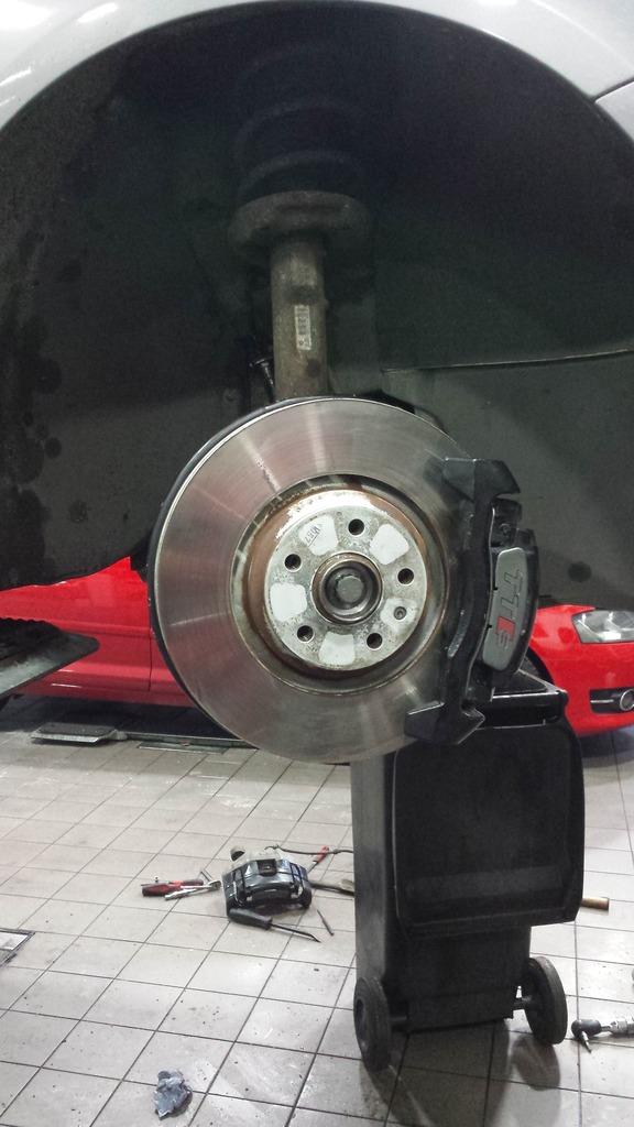

Audi tts front brakes

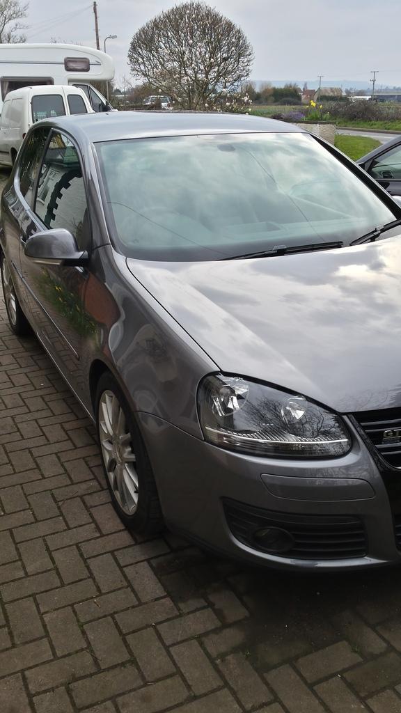

Here's a few pictures nothing special...

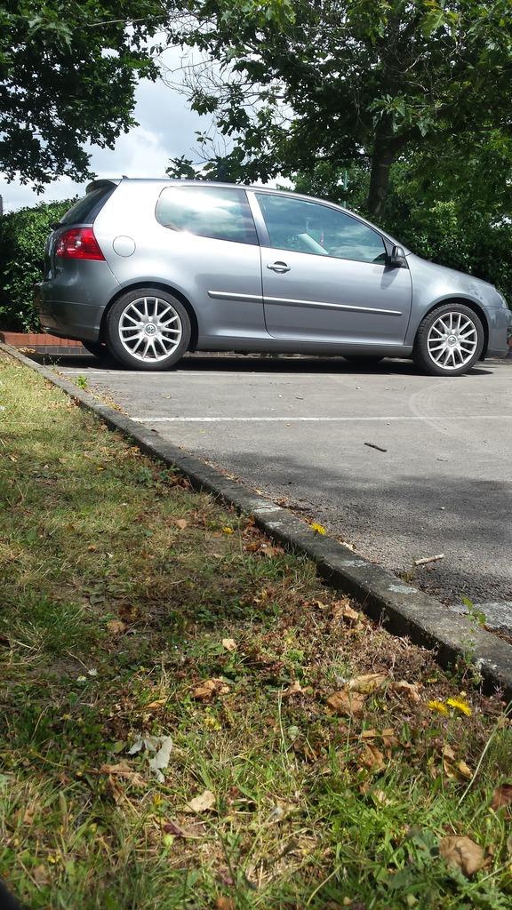

Now fitted my r36 rear anti roll bar not expecting much of a difference but it works really well with the poly bushed front end and powerflex anti lift kit.
Koni rear shocks are next on the list as I've got one leaking (as per usual on these). Here's some car park pics..

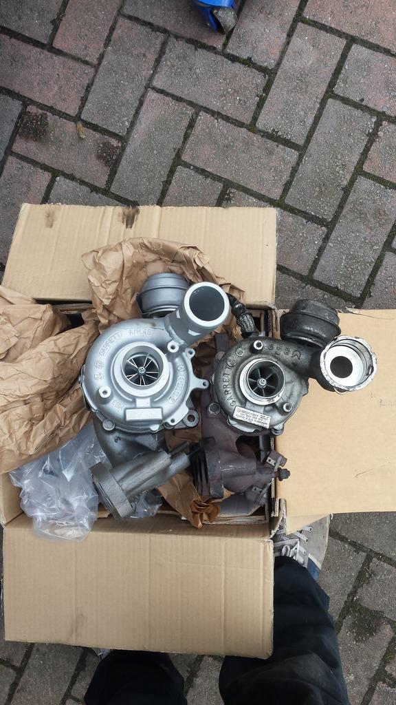

Added a intake silicone hose as my plastic one was split, and a little sticker... oh and MY BIG TURBO ARRIVED! Getting fitted next week and mapping Tuesday more to follow.

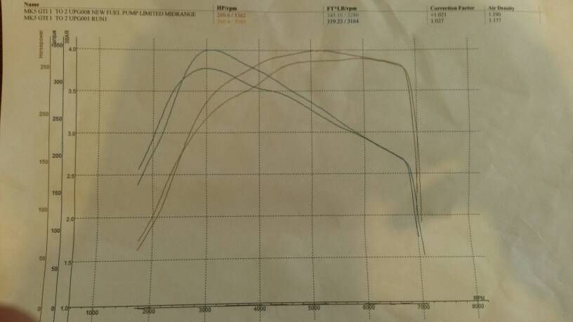

So gtb1756 went on nicely, took it over to narco tuning and got them to map it and make an oil return pipe, left it with them, got a phone call the next day saying it's all sorted and it's made 250bhp! They had to limit the torque due to standard clutch and flywheel so as soon as that's replaced it can be adjusted.
So first impressions I'm very pleased with it, little smoke, pulls so hard from around 2000rpm all the way round now! Rev's so well and is such a smooth drive still really happy with it.

looks good Joe and the like the graph of the new turbo

Hi @Joelewis55 loving that dyno printout! I'm in the dilemma where I don't know if I should go GTB2260 on tubular manifold initially with standard injectors for around 230BHP with the prospect of 300BHP with +120% injectors and Sachs SRE clutch next year, or just be sensible and go cast manifold + 1756 and stock clutch with similar figures to you. I guess your turbo and map has cost less than 1000 quid?

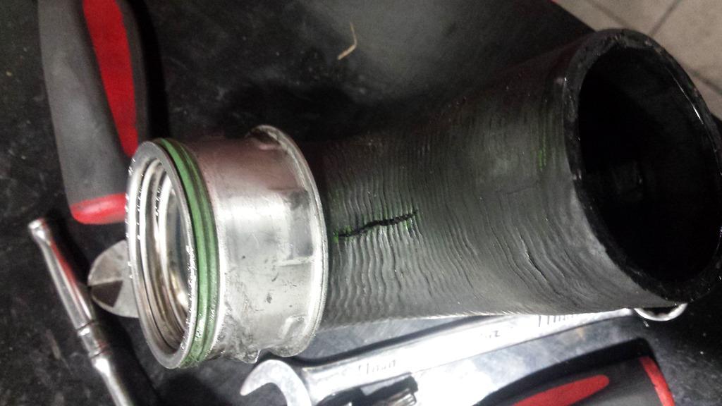

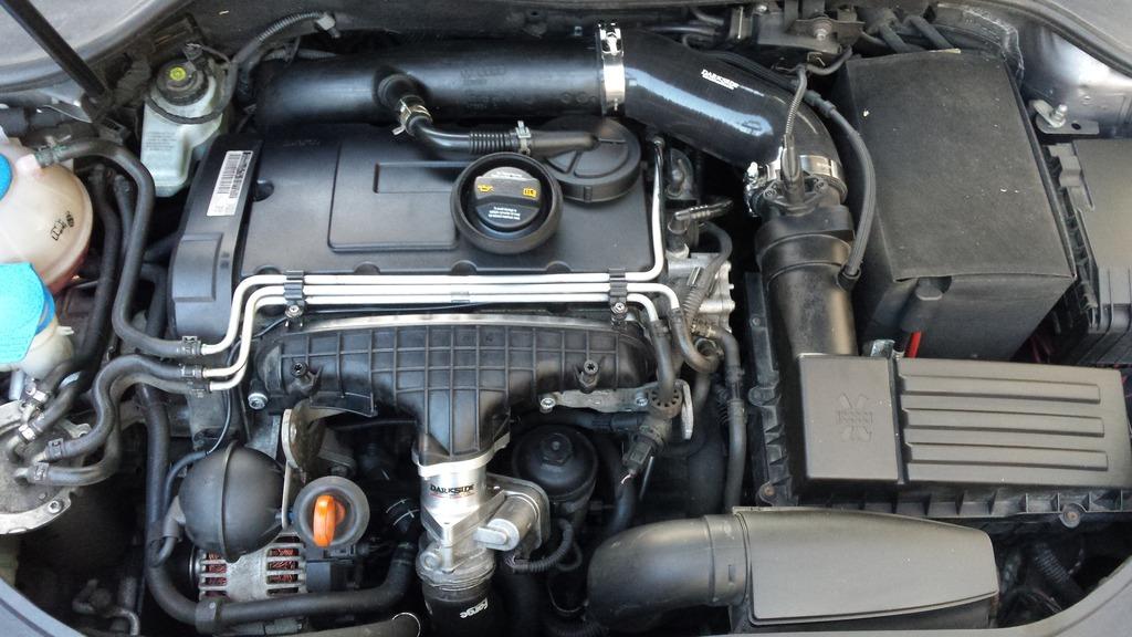

Done some more bits to this recently, need to take a few more pictures but here's what I've done.

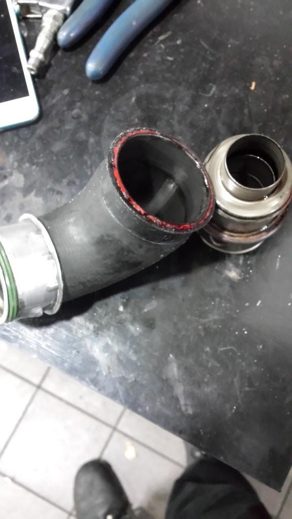

Firstly I had a boost hose split, the turbo outlet pipe so replaced that, pictures also show the insert I removed to fit onto the larger turbo.
Then I got a 2.5" straight through exhaust system (to match the 2.5"decat downpipe) made with a single silencer and a centre hidden tip. Still need to get photos of this but it makes a nice sound especially with the popcorn limiter. Although not too loud when normal driving so perfect really!
But I was still losing boost so I got an s3 alloy intercooler and fitted that. No pic's but you all know what it looks like and it's hidden anyway.

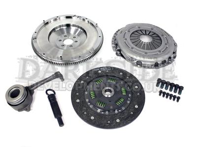

Then my clutch started slipping and dual mass was rattling. Ive done 10,000 miles since bigger turbo was fitted, unknown milage on standard clutch but I have done 35,000 on it with between 180bhp and 250bhp (140bhp standard). So I fitted a darkside billet single mass and sachs race clutch kit.
Pedal is heavier and you do get a rattle at idle up to around 1500rpm then it dissappear's.
Diffinately felt a big difference with this cars pulls a lot harder. So with this fitted I can go back for mapping adjustments at Narco.
Hopefully with the less restricted exhaust, s3 intercooler and new clutch + flywheel set up I can get a few more ponies and torque should increase from 320lb/ft to around 400lb/ft!
Still keeping it stealthy
Future plans after mapping on Monday are to do a top end rebuild, as engine has done 100,000miles now. So will be replacing all gaskets and seals cleaning head ports etc and also adding darkside developments stronger valve springs as it likes to rev so much. Contemplated arp head studs but don't think they are worth it.
Let me know what you think, I will post pictures of exhaust and new dyno figures on Monday hopefully.
