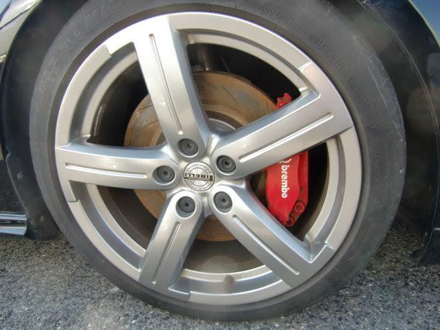

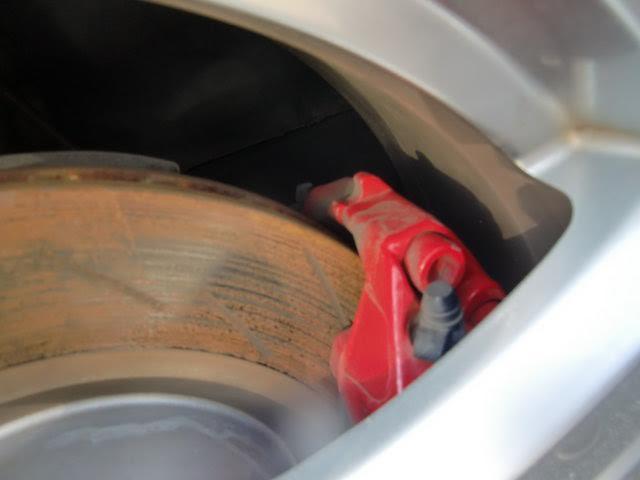

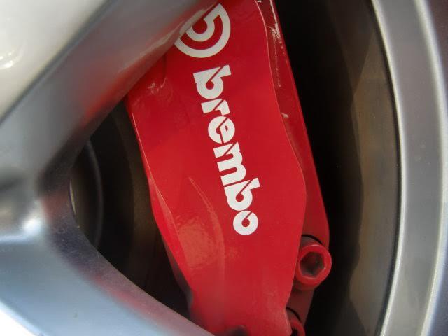

These are my brakes..
Anyone know what they are? they were on the car when I bought it.
caliper looks exactly like the MK1 Cupra R ones and disc size also looks like the right size (323mm). I'm pretty sure there was a guy a while back why had these on a MK2 Cupra and said they had been an option either at the start or in another country. Something weird like that.
