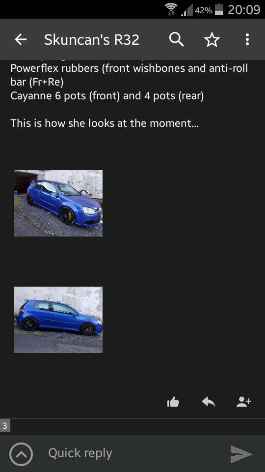

I have just replaced all the suspension, wishbone rubbers, anti roll bar rubbers and brakes all round..
Current list of updates:
Bilstein B8 shocks
H&R springs 20/25mm drop
Powerflex rubbers (front wishbones and anti-roll bar (Fr+Re)
Cayanne 6 pots (front) and 4 pots (rear)
This is how she looks at the moment...

how do you find the 6pots?did you change the master cylinder?

Thanks... yes i changed it to a TTRS vsersion 25.4mm... really straight forward swap...
at the moment i have not really bedded the brakes in... the car inlinement needs to be done, and its booked in... so not wanting to drive her, if the inlinement is quite out it will kill the front tyres and they are new !!!
