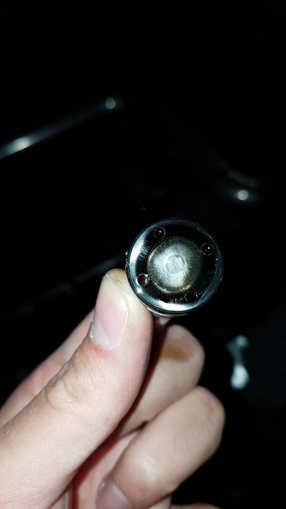

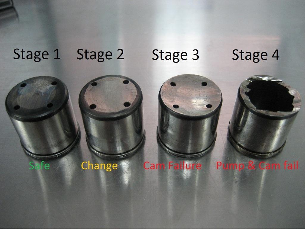

Checked the cam follower today, the car is currently at 80K with no documents to say the cam follower has been changed. Looking at the condition of the follower and the o-ring on the HPFP I would say it looks like it has been changed. I think I will wait to replace it until I do a full service in the coming weeks.
