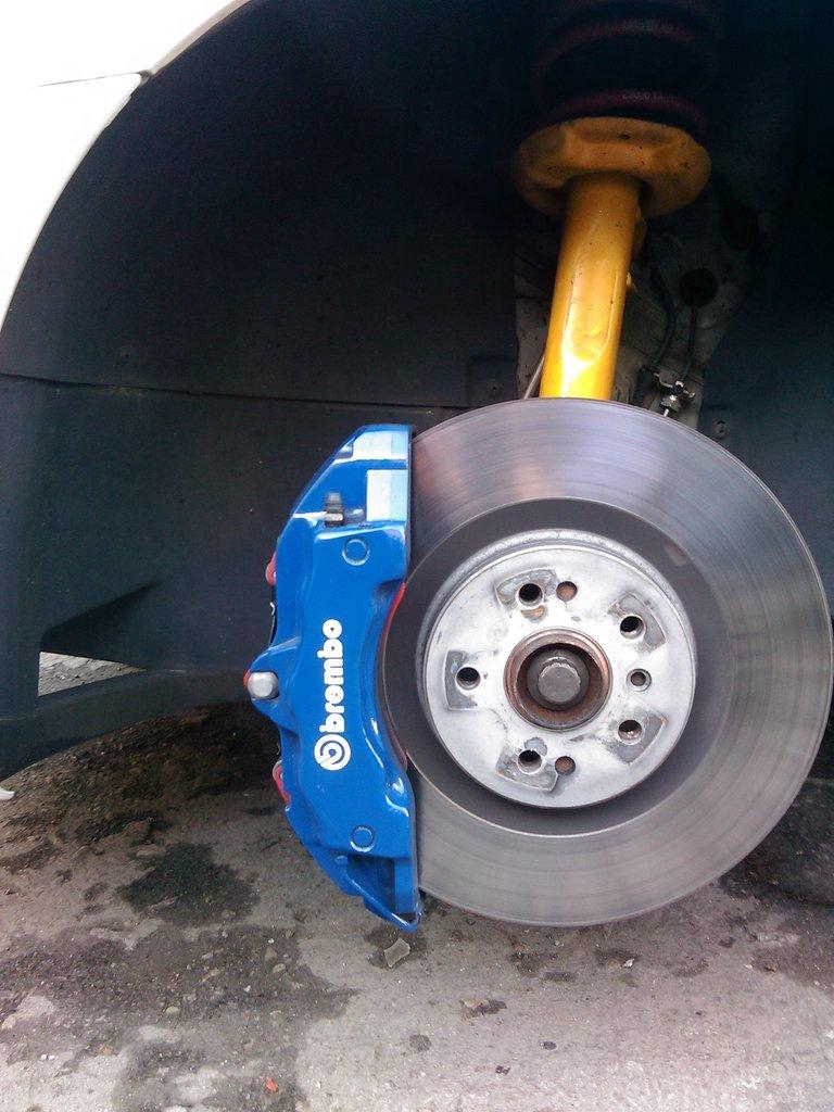

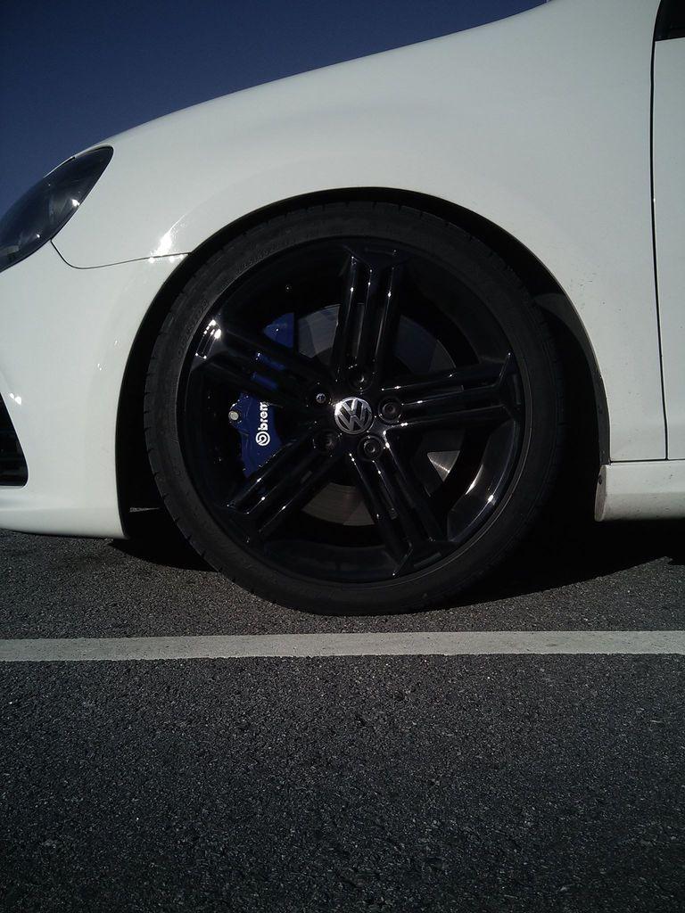

I have a friend with Talladega reps with the ET45 and 8Jx18 that just needed to shave a bit of the calipers before painting them to get them to fit without spacers.
I'm still waiting to receive the better adaptor kit from Epytec that will be fitted when I remove the SuperPro ball joints. The ET of the MB ML450 discs is incompatible with biggert ball joints: TT and SuperPro.

That's pretty good news @Shoduchi If I do decide to shave them, I'd probably only need 3-5mm spacers, which I'd be happy with. That blue caliper with black wheel combo looks nice!

Spoke design matters a lot. I think you can shave off 2-3 mm since they're so buff.
