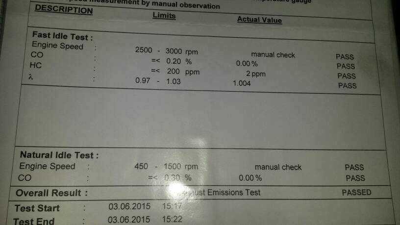

If you give me a second I'll post up my emissions results.

« Reply #9 on: August 30, 2016, 05:33:15 pm »
Exciting stuff this...
Stock exhaust and stock map:
Full Powervalve (200 cell) and Stage 2 map

Looks like you passed with ease.

0.00% CO for the standard car, wicked!   Kind of at odds with all the soot these TFSIs build up on the tailpipes though!
Not sure that 0% is actually possible but it's obviously below permissible limits  :happy2:
