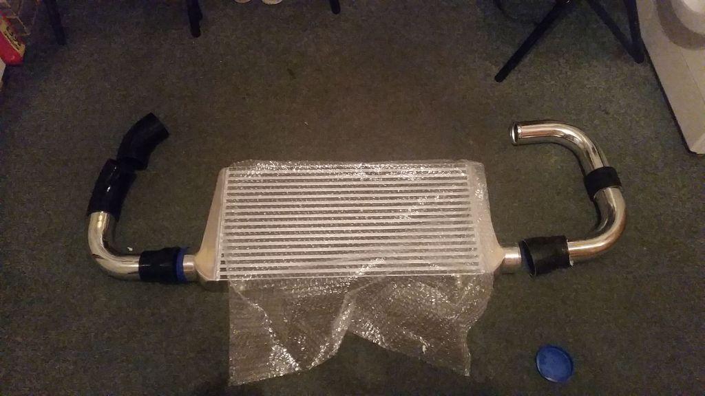

I got mine from Ebay. they seem alot more expensive than they used to be. was about 8quid per alloy pipe but now its like 12-15quid a piece. we had to cut some of the pipes down so the intercooler was sitting correctly. I think it was ASH silicone where I got them from.
its 3inch reduced to 2.5 from the intercooler

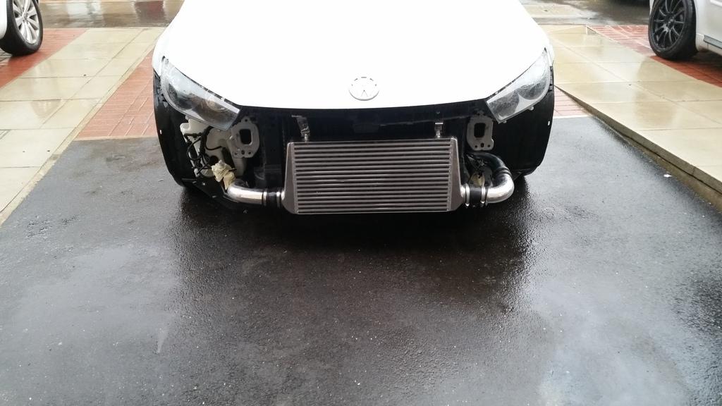

I got a pic with the welly cooler if that's the 1 you meant?
It's actually massive lol  but I'll get a picture up tomorrow

Offline Paradox1
  • -Given: 41
  • Posts: 1038
Re: Edition 30 Welly Cooler guide?
« Reply #12 on: September 15, 2016, 09:29:14 am »
Cheers mate.  I'm only going Stage 2 at the most, so that's what....330-340hp?  That's plenty for me, so the S3 should suffice  :smiley:
I need to sort the chassis out before going big with the hp anyway.  It can barely contain stage 1, let alone 2!
I think you will probably be alright on standard intercooler to be honest. but obviously it will help keep things cooler. If your heading for no more than 330-350 id go witrh the cheapest option, either Ebay or S3 cooler.
Offline Paradox1
  • -Given: 41
  • Posts: 1038
« Reply #13 on: September 15, 2016, 09:39:38 am »
