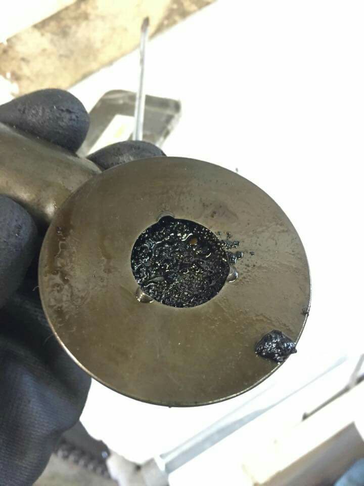

Also if it's got no history on the next oil change I'd whip the sump off and clean the pickup pipe mine had full vwsh but longlife services and mine looked like this after 150k, mates gti had a blocked pickup at 80k he bought it with no history.
