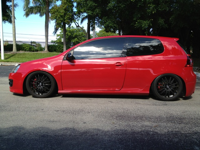

The car currently...
When it just had the Eibach Sportlines

@ROH ECHT Every time I see your car I always love the stance. And the wheels, are they TSW Nurburgring? Interesting what you say about the H&R Ultra Low coilovers. I'm itching for a bit more drop over my H&R springs, but I'm not keen on a harsh setup. What would you compare the Ultra Lows to, in terms of comfort? I know it's hard not to be subjective! I'd like to think there's a way of going lower without making the car a bone-shaker. You boys over the pond have lovely smooth roads though don't you??!
(Apologies for thread drift)
Thank you for the kind words...and my apologies to the OP as well if this is off topic and unhelpful. Yes they are Nurb's. I selected them for the look, fitment, but mostly because of their 18.4 lbs vs oem 29 lbs difference. When I rode in my VW tech's mk5 with ultra-lows...they were smoother ride than the Eibachs were and probably equal to new stock ride...only I couldn't remember how that was due to the time that had passed. There are pretty good roads here...but over the past few years to a decade it seems there is more patch work on deteriorating roads than there are proper refurb jobs being done on them. Must be allocating money elsewhere and just squeaking by where roads are concerned. My wife hates riding in my car. Having done both front and rear ARB's prevents one corner to move seemingly freely from the other side making you feel everything. That's when driving rather pedestrian...start tossing it about and it is amazingly smooth and glued. This...why I suggest to most that a rear ARB is a very good upgrade for the scary understeer you get if you overpower it once or twice in a curvy but you will retain the comfort. Begin on its lightest setting for restraint and tighten if needed.
You can go crazy low with the ultra-lows...this is very close to what I am shooting for and can be done with them. Not as low in the rear though: http://www.golfmkv.com/forums/attachment.php?attachmentid=79727&stc=1&d=1320687331
