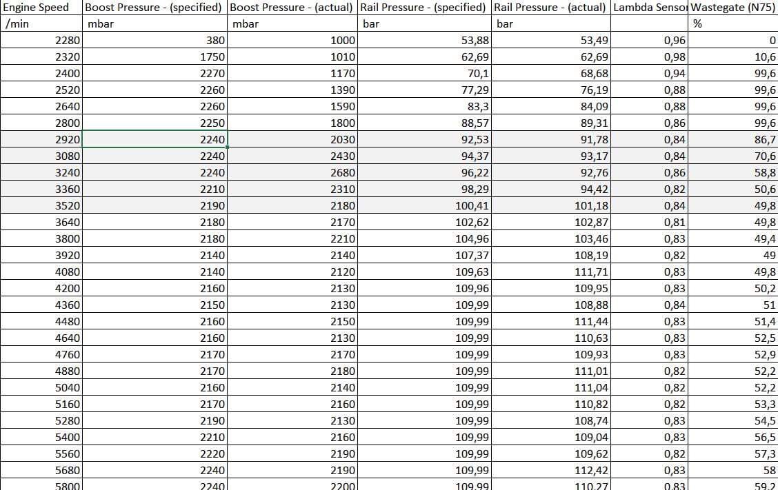

I got Revo stage1 map few months ago and since than I have always strange filling when Im accelerating, like engine is lossing power. Today I finally got my VCDS and did some loggin.
Looks like my turbo overboosts every time I go full throttle. Is my wastegate closed for too long? Or if anyone got some other idea what should I check?  :smiley:  :thinking:

i kind of have the same senario with my APR map i beleive. But i might be wrong so appologise but its compressor surge.
Does it happen about 3500 rpm to about 5000 rpm?
I think so. Did you try to do anything about it?  :smiley:
To me it only happens (overboost) when i go immediately from normal driving to full throttle.

@Charlie23  Do you have any boost and rail pressure logs from your car?
I've noticed that somewhere around 3000rpm my rail pressure falls bellow specified (grey area on pic) and that's exactly when overboost happens. Is it possible this is somehow connected to overboost or to computer taking away that extra boost?

@LencTPH - No sorry i dont i had it logged at GotBoost in Bridgend. And funny enough i had exact same problem first of all and we found out i had a lazy fuel pump. So i had the fuel pump & cam follower changed with new and the fuel loggs where then perfect, the Turbo pressure loggs where peeking spot on etc etc.
The fuel pump loggs where something like (sure someone could do this better)
At idle it was something like -0.5
Full throttle it was hitting +59.6 but slowely droping down then to +12.67 then to -1.34  something along the line of that if it makes any sense??
And once the pump was changed  it was something along the lines of -0.3 then throttle +23.9 then drop straight back to -12.63 etc etc
Hope that makes sense to you or to someone that kind of knows what im on about hahaha
BUt in the end of it all we found out the Ecu was sending the turbo (such) pressure and the turbo was then regulating it blah blah

You have a nasty boost spike. How is that related to a bad mechatronics?

Unless the DSG clutch is slipping then it won't be the cause.... what you are feeling is a big torque spike that the ecu then catches/corrects and backs off..
