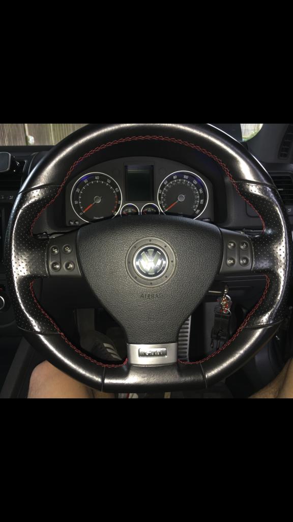

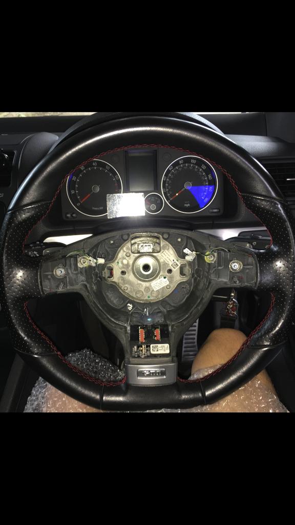

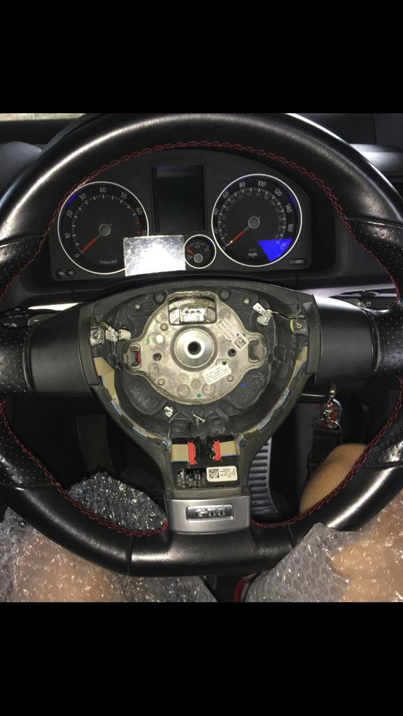

I did this mod the other month if your car has cruse control, highline display and dsg like mine it won't need coding. Here's some pics to give you a idea of what to expect.

« Reply #6 on: October 30, 2016, 12:36:50 am »
Thanks again for the replies..
Pics were great to see. :)
