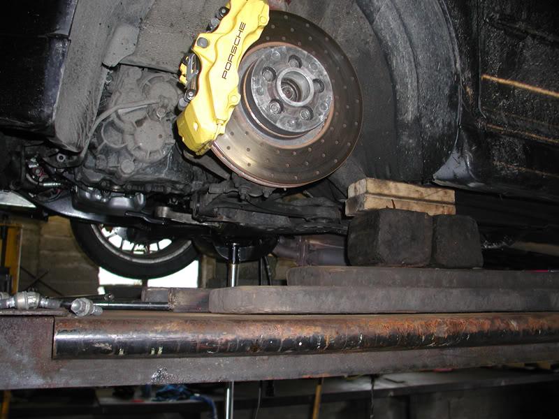

They are sizeable calipers and can be made to fit effectively, here are some GT3 RS calipers on a Mk4, these are over 90mm wide but with some wisely chosen wheels and some adaptors we managed to get them on a mk4 with no poke
