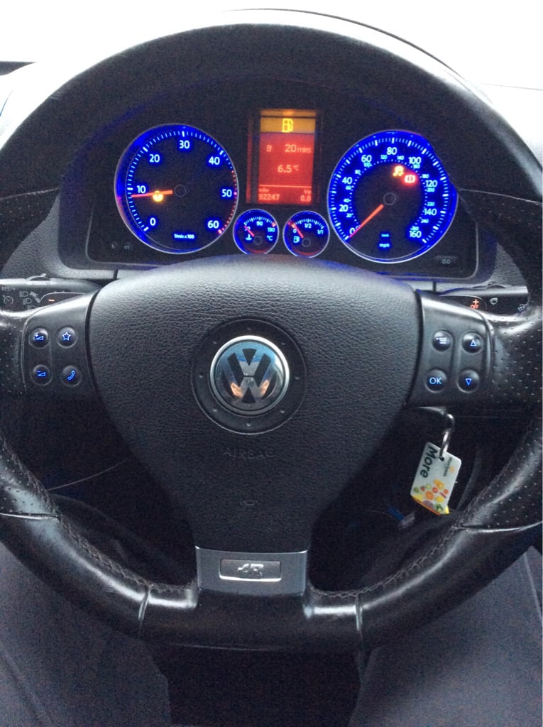

Right I've done this so far. Now two lights are showing
