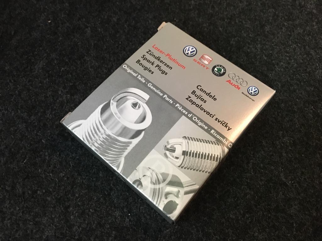

Also what plugs is everyone running at the mo, genuine VW best for standard?

Hi, are NGK IRIDIUM IX SPARK PLUG BKR6EIXLPG the ones to get?

I'm using NGK 7's spark plugs in mine with a stage 1 tune but they state there good for stock -> 2+

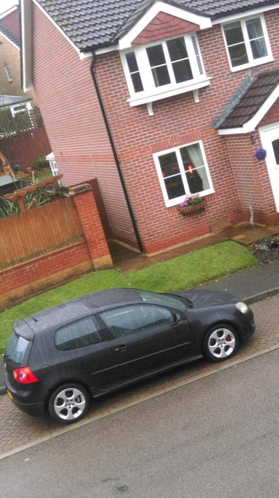

« Reply #5 on: November 24, 2016, 02:27:37 pm »

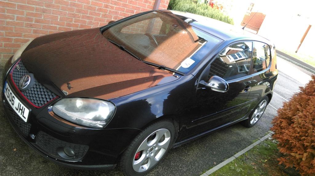

Apologies for the poor pics.
Day it arrived:
On the drive:

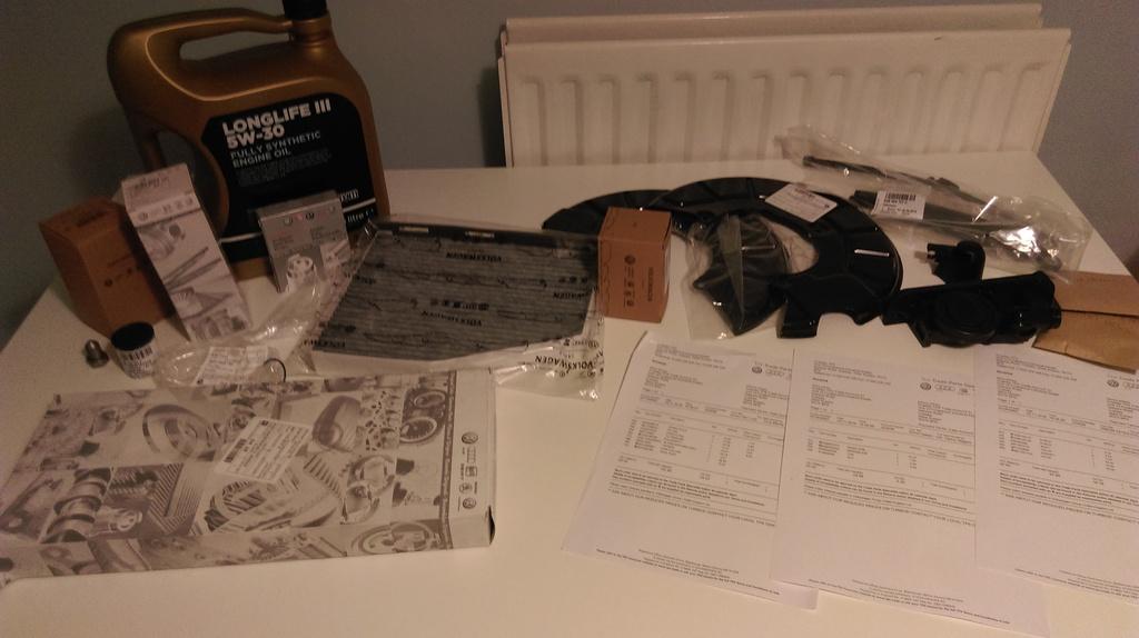

I have always said I'd never own a black car. But hoping with all experience I now have with detailing I'll be able to bring this back to life. Maintaining plus living with may be a different story, I know I have OCD with my cars.
Anyway, treated to a full goodies from local TPS
Full filter, air, oil, pollen, fuel
Oil
Spark plugs
Cam follower and HPFP seal
PCV and new gasket
DV (Revision G)
Front brake shields and bolts
Rear wiper arm, blade, cap and new nut
Hopefully getting to my brothers garage this weekend to get up on the ramp and give car a once over plus fit some of these.

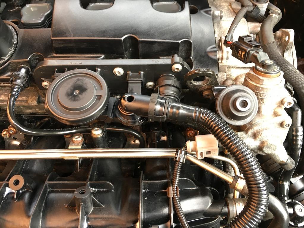

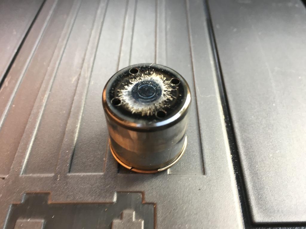

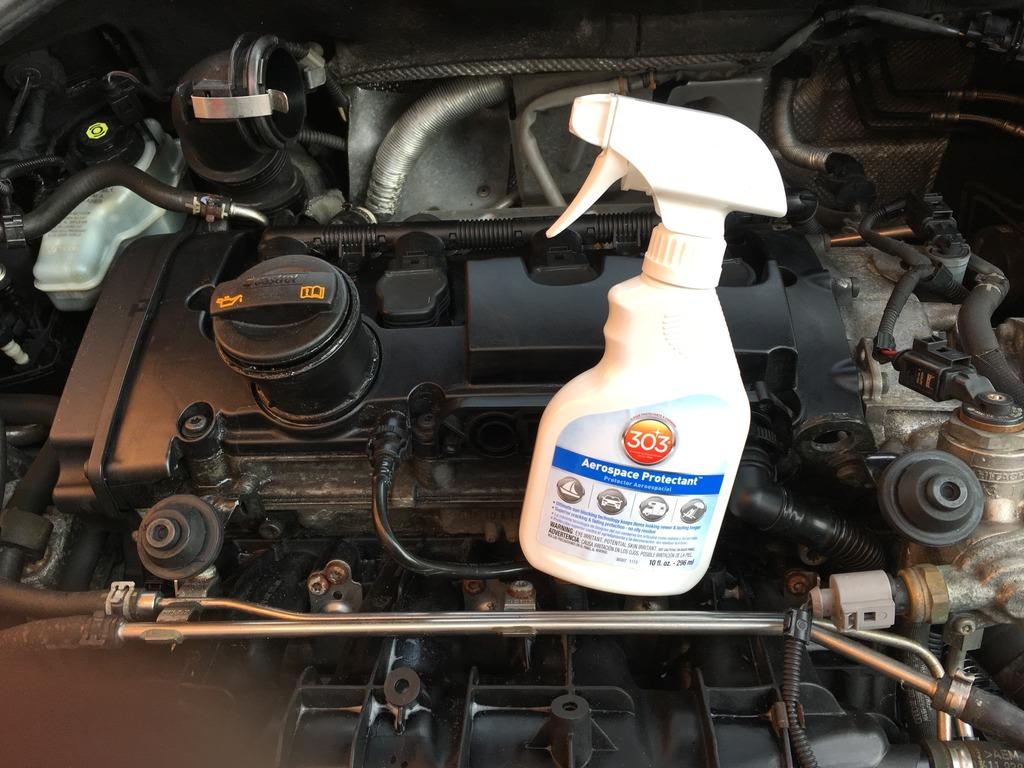

Which meant I could put the mk5 in the garage and make a start on cleaning and also got along to my brothers garage to get it up on the ramp for a once over plus service.

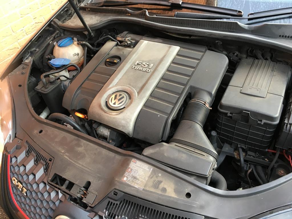

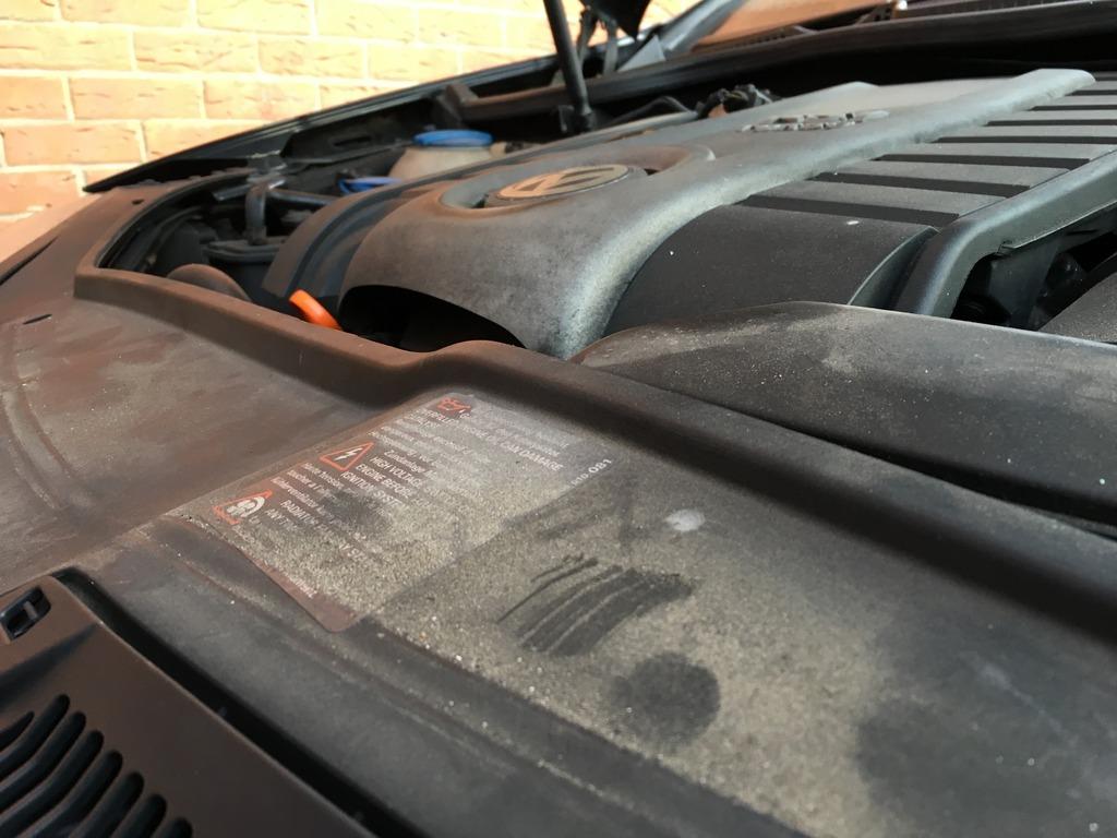

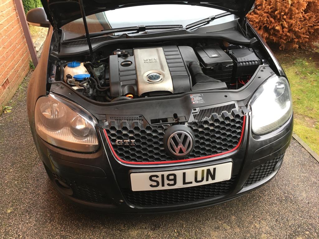

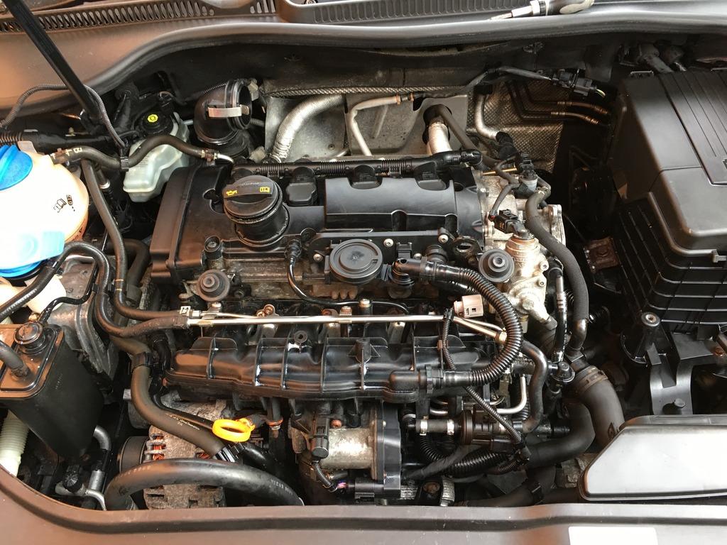

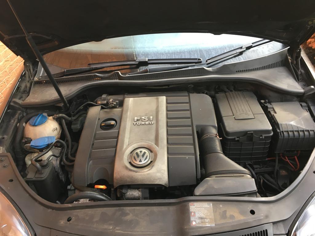

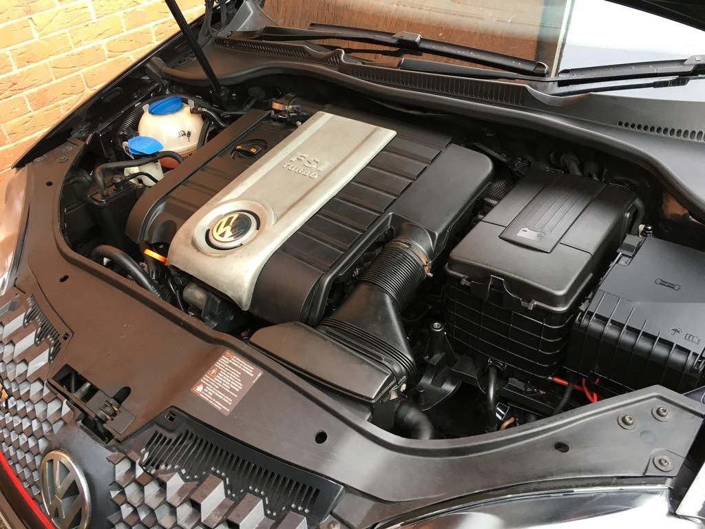

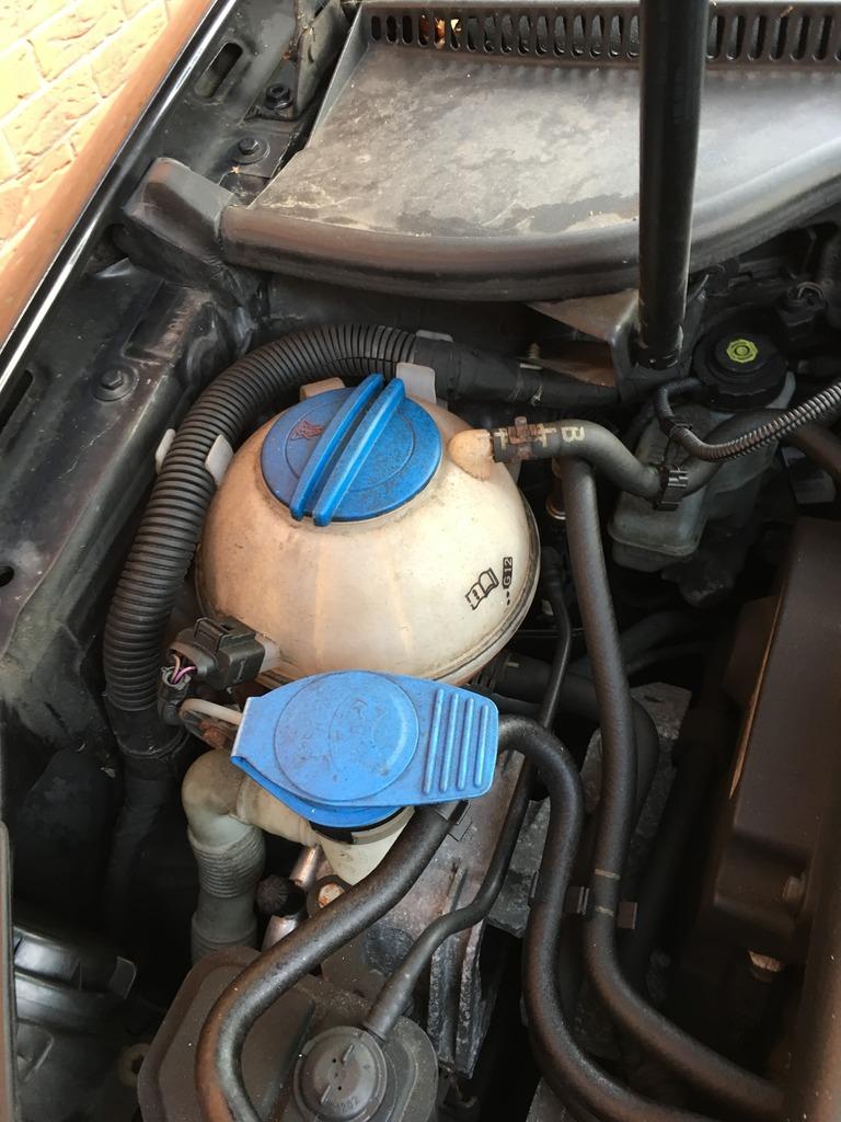

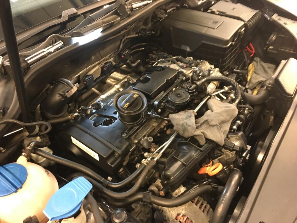

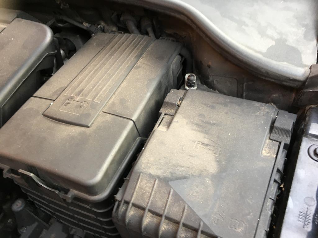

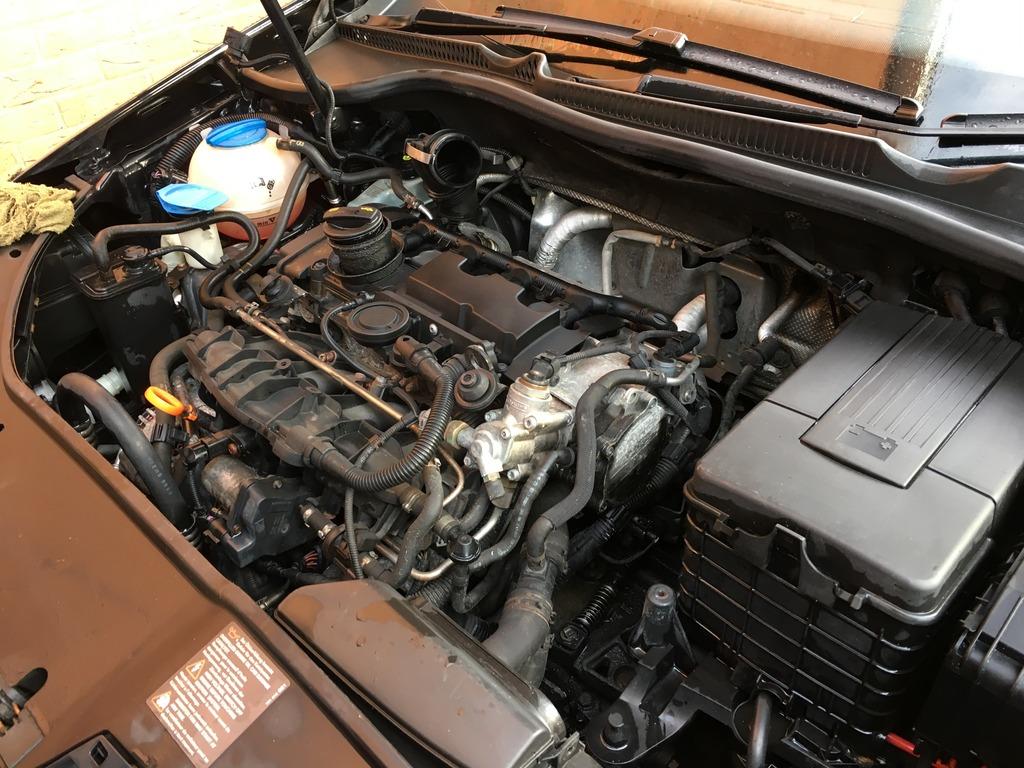

I've made a start under the bonnet, this is what I was greated with:

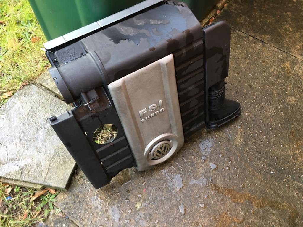

Started buy giving a full de-grease and wash. Making sure all sensors taped up and dry. Then removed engine cover as had a few bits to fit/replace:

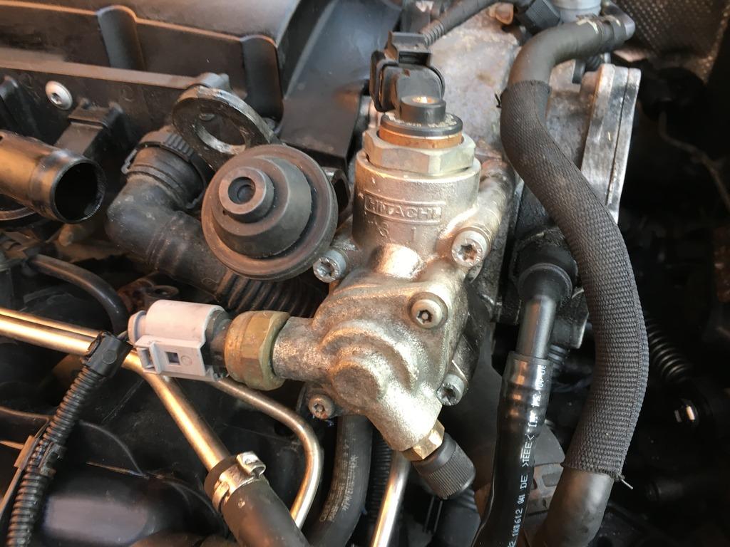

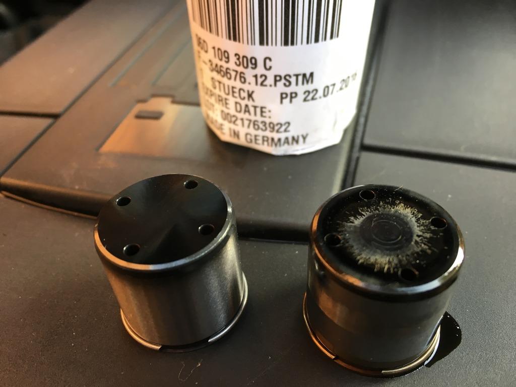

New Cam follower

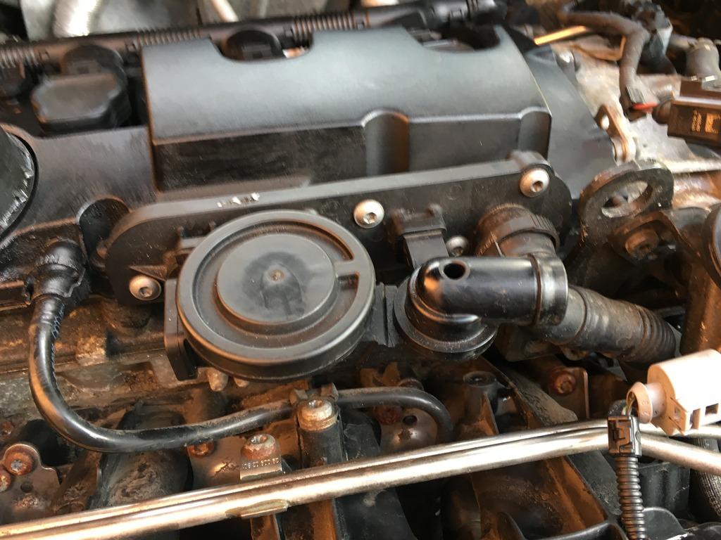

New revised PCV valve (R)
Cover off:
Trusty mk5golfgti.co.uk fitting guide:

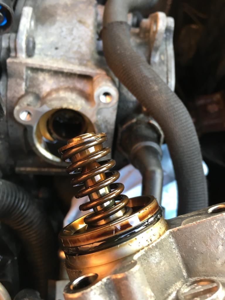

Much easy on this one than my old red mk5 as that had the two metal pipes! This only the one and the rubber. So took my time and all done in no time. Car is on 131K and no sign than been replaced before...
Defiantly needed it!!
New vs old:
Checked cam and luckily no sign of wear. Don't know why VW doesn't put these in service plans!

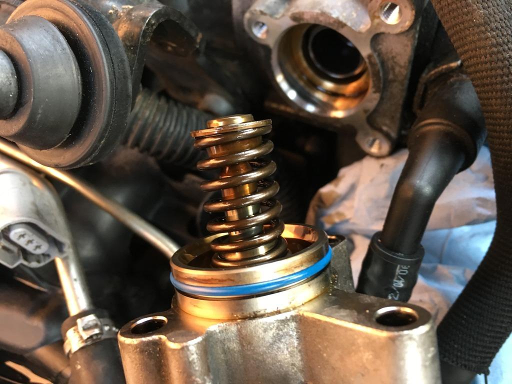

New HPFP seal:
Job done:

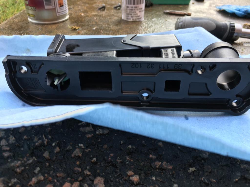

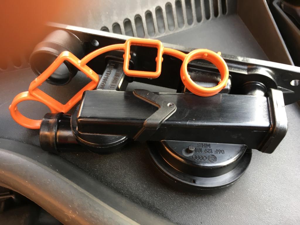

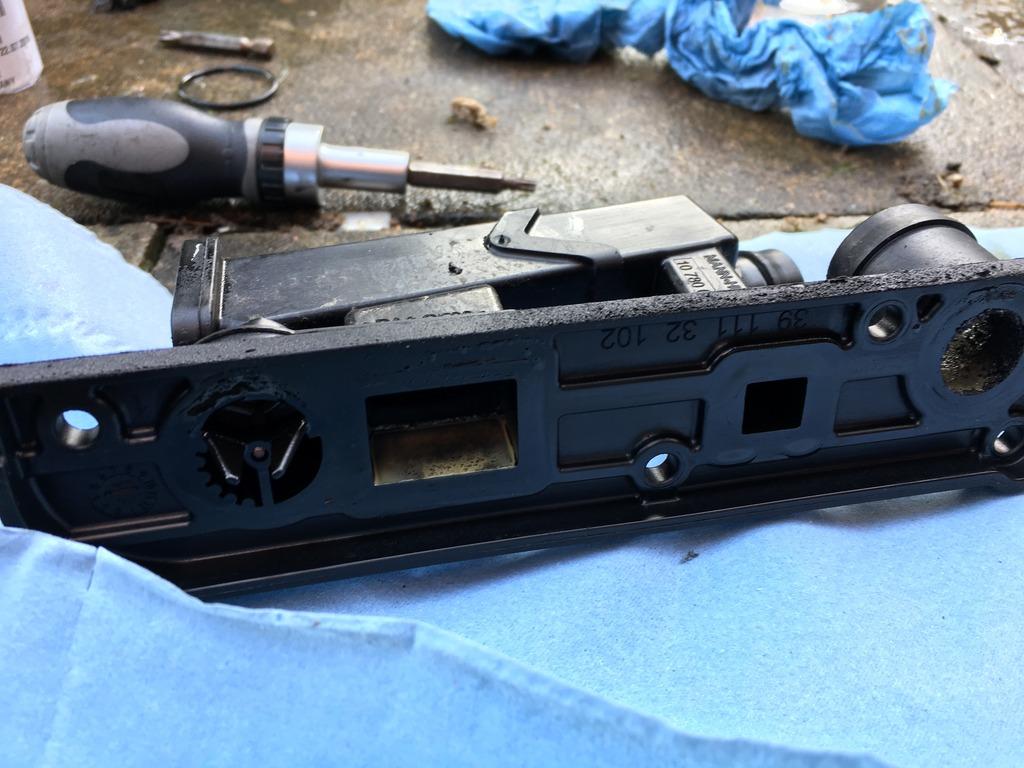

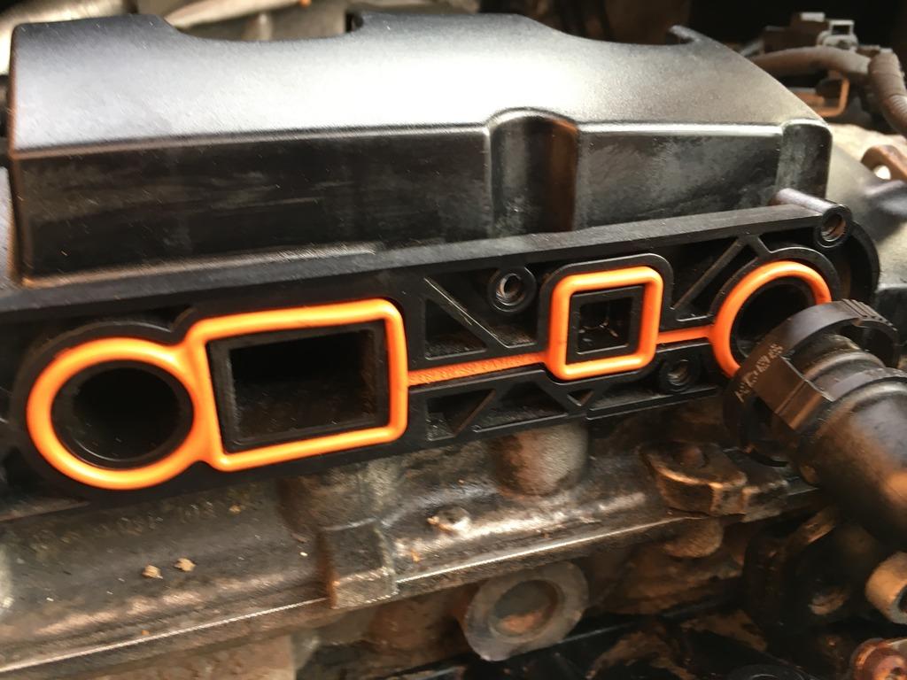

Next job revised PCV valve:
Old:
New:
Whilst off gave everything a good clean:
All back:

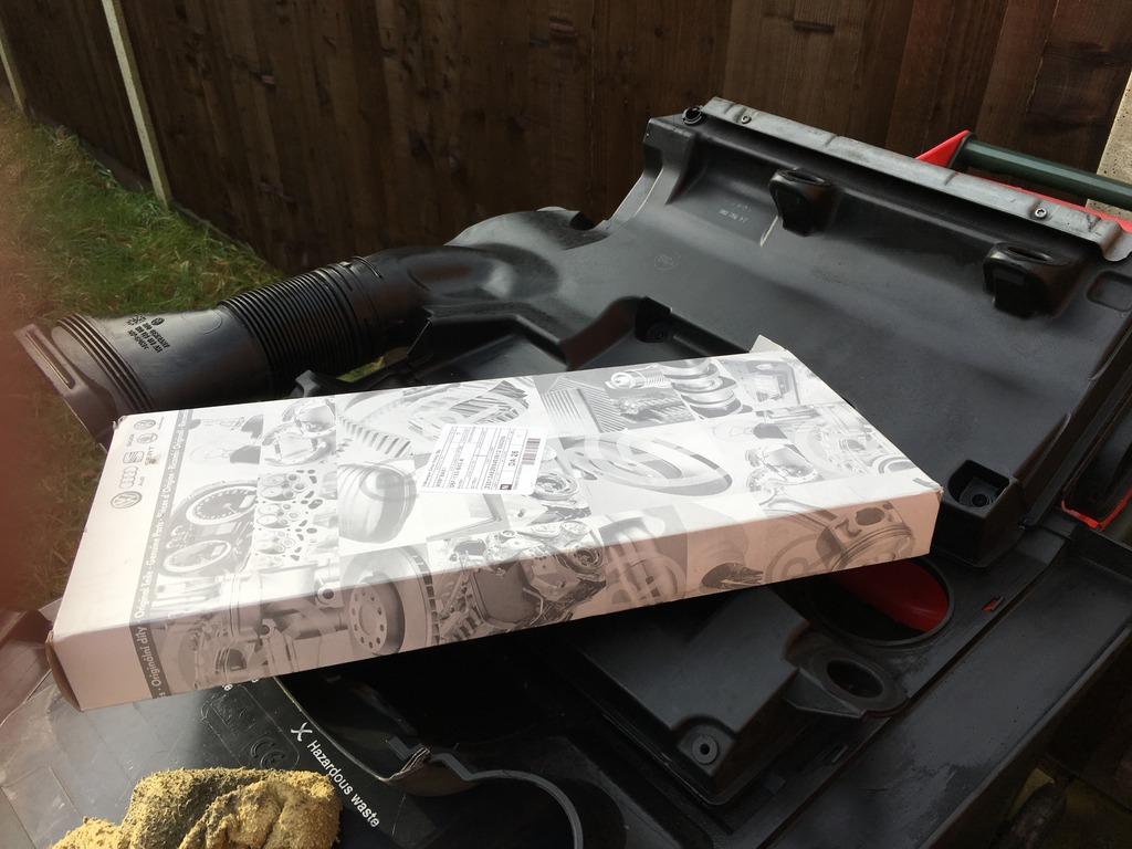

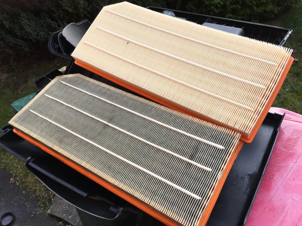

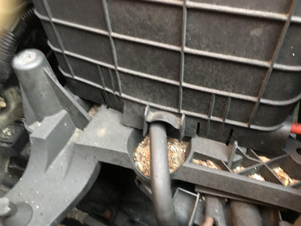

New air filter. Just gone for OEM for now, not sure if go down performance panel filter or induction kit further down the line:
Needed doing!

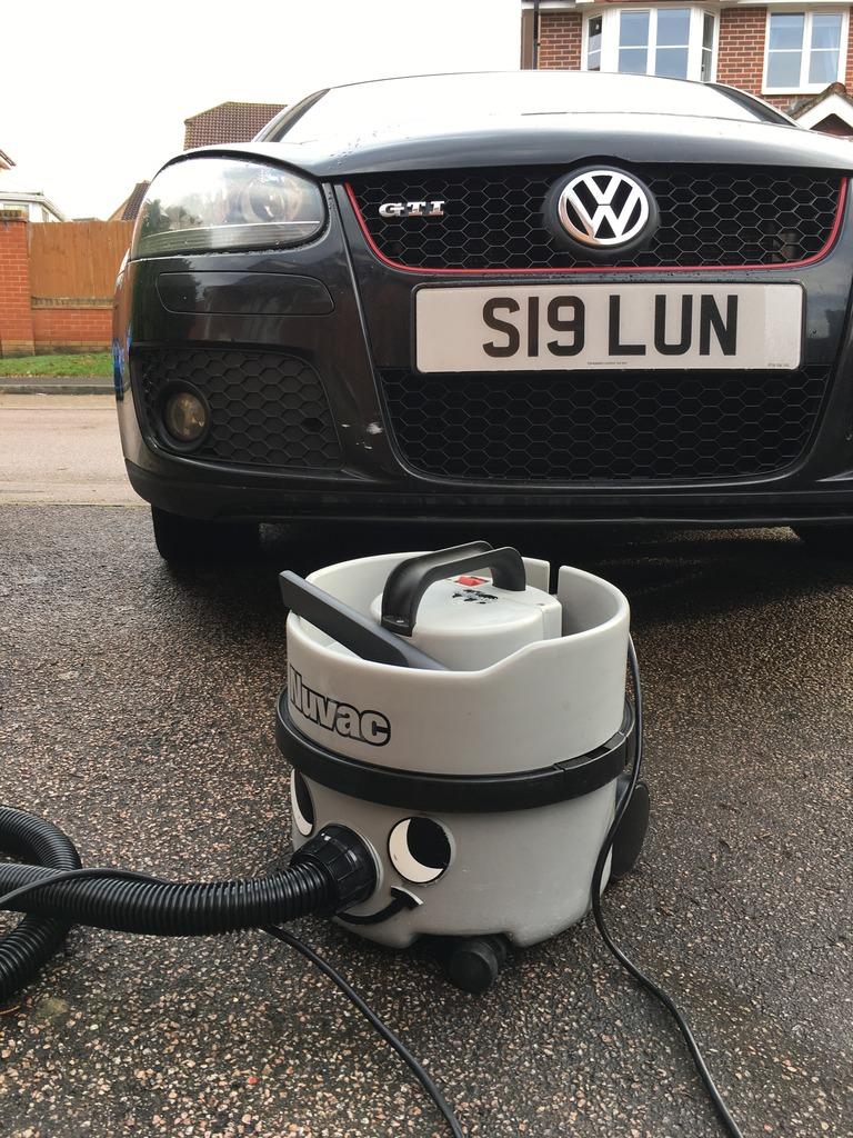

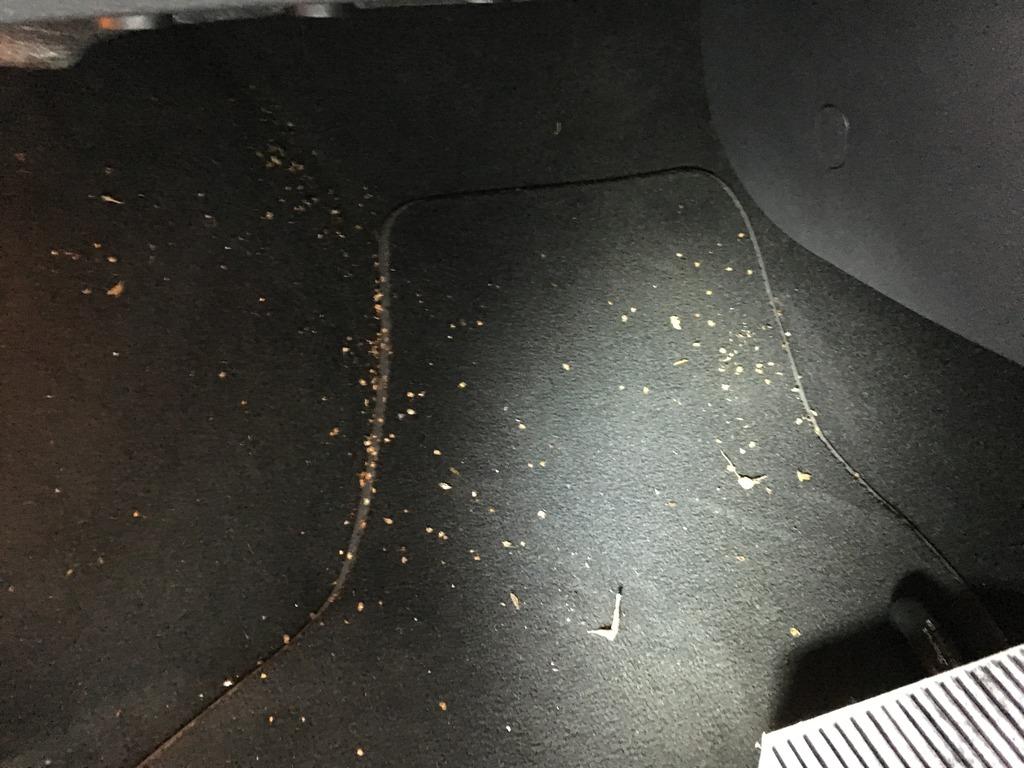

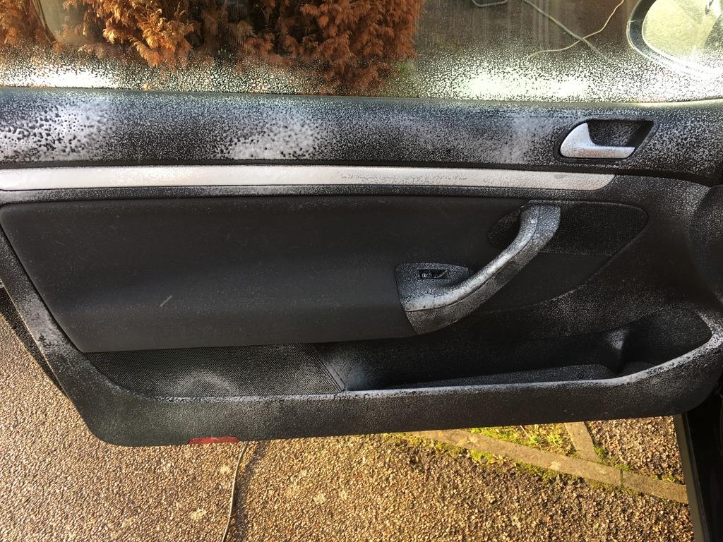

My birthday last week, only person I know pleased with a hoover as a present! lol

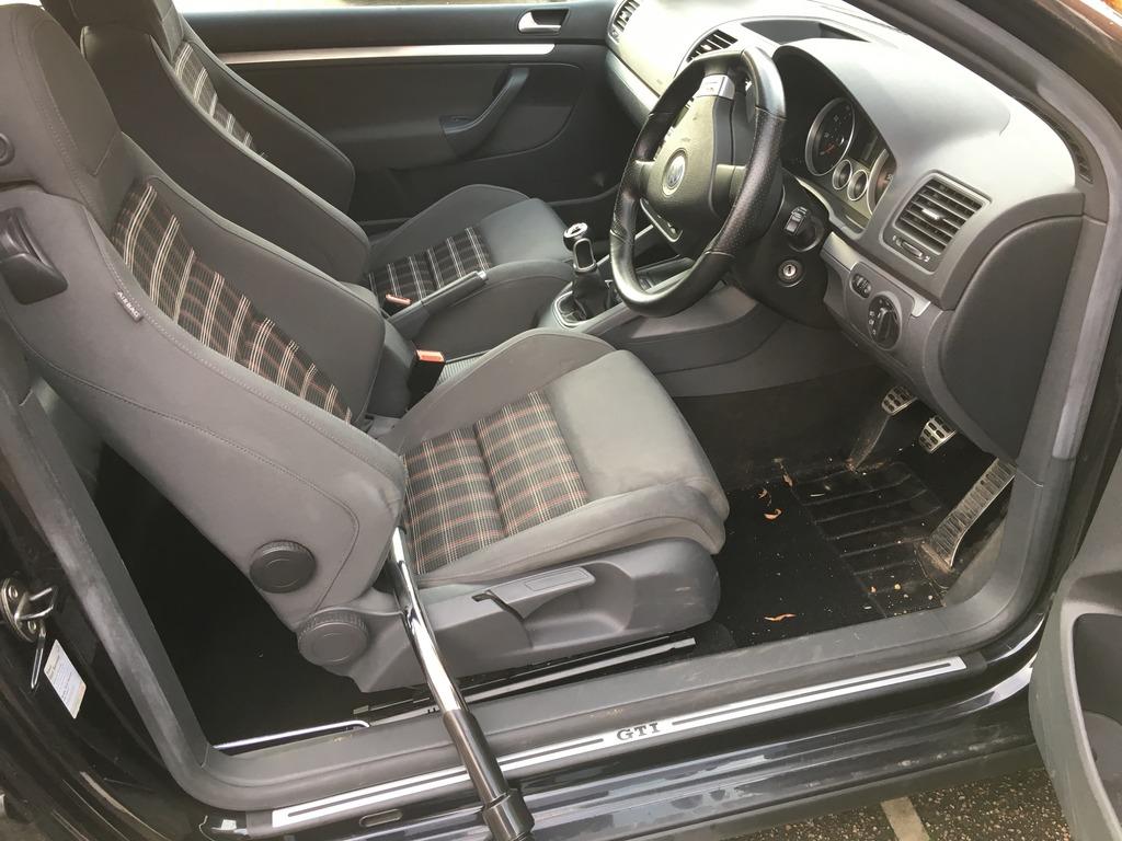

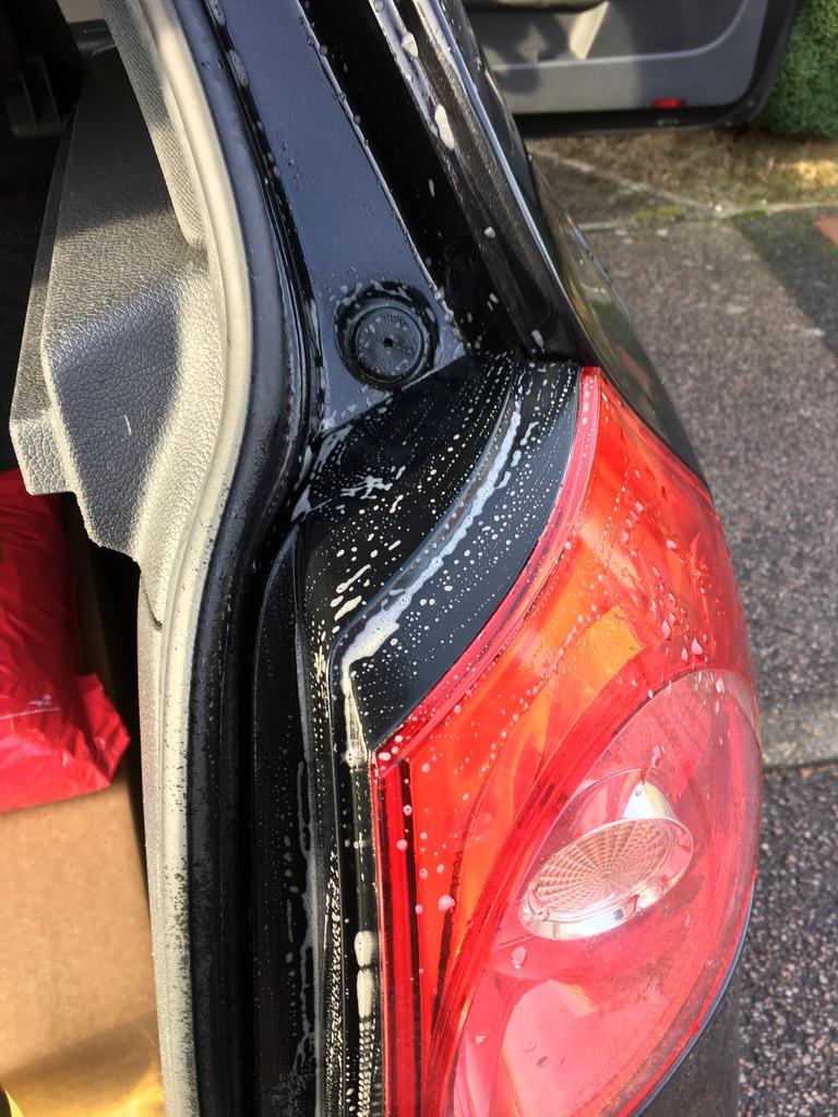

Meant was able to make a start on the inside of the car.

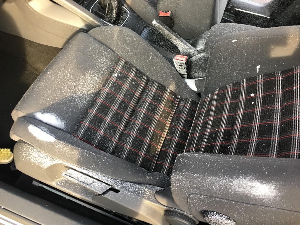

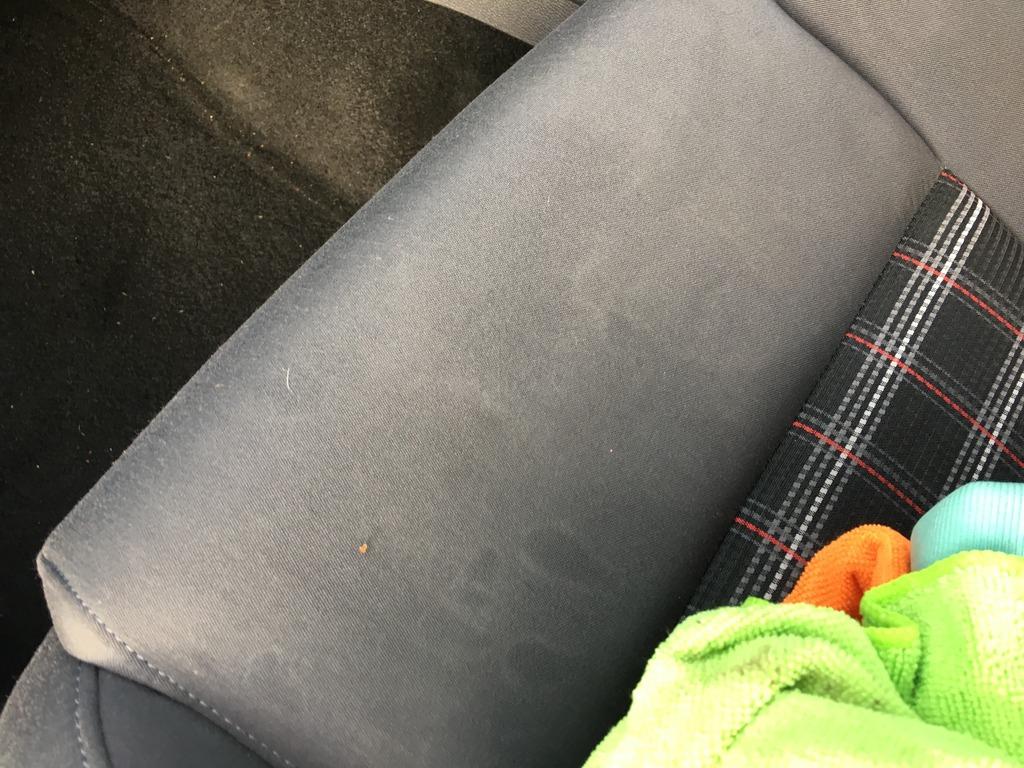

Full hoover
Wet vac
Spray foam clean fabrics
Woolite fabrics
Spray clean plastics
Clean windows

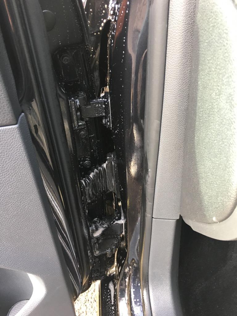

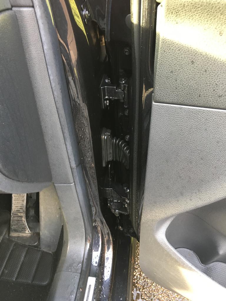

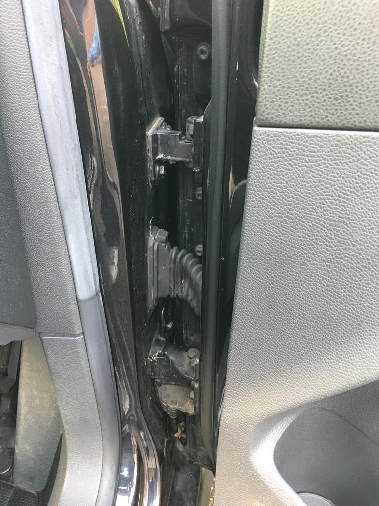

Door/boot shuts

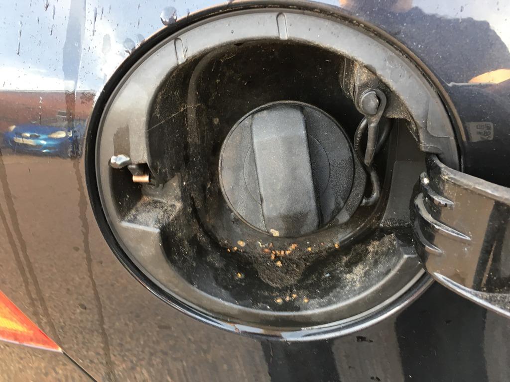

Inside petrol cap
Nice to get some cleaning done. Will get some better after shots up once better weather.

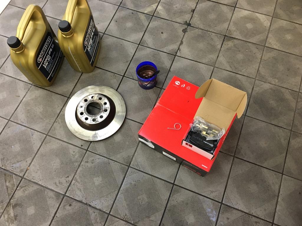

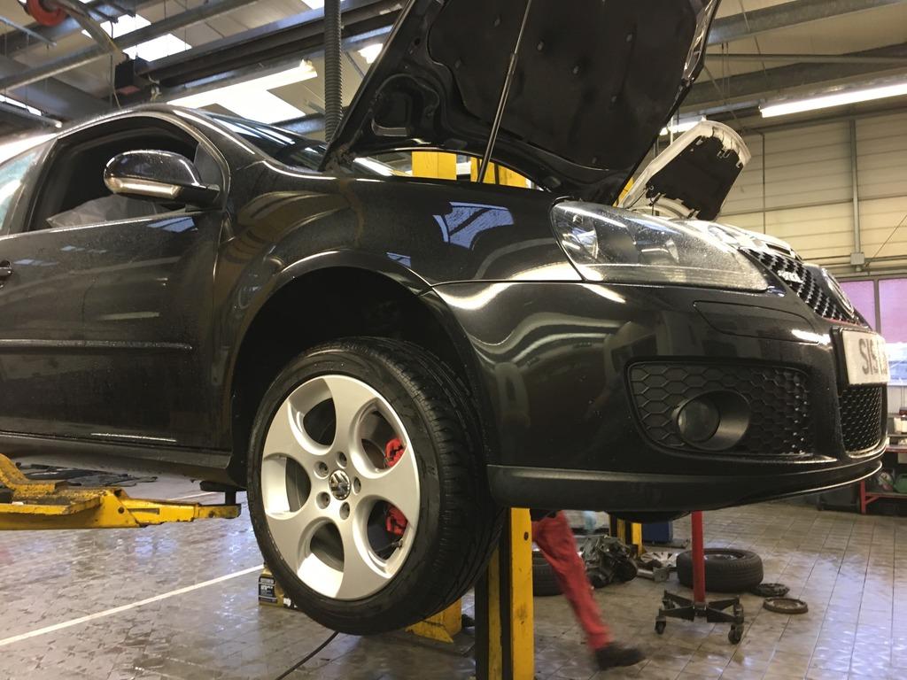

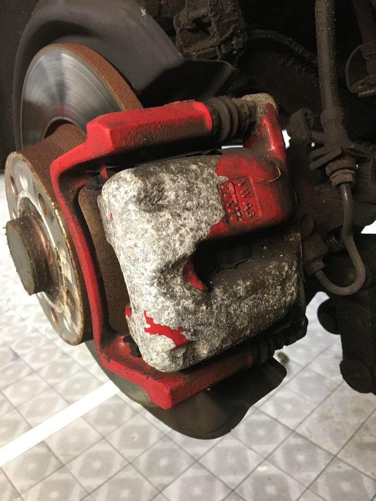

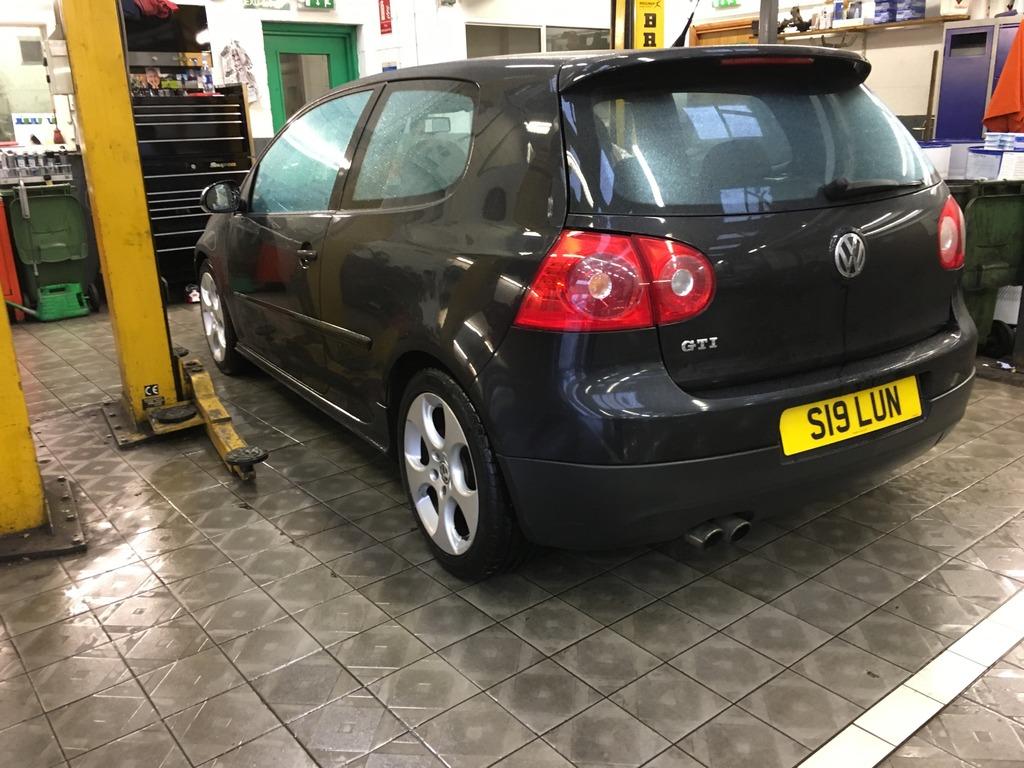

Got the car into my brothers garage to get a few jobs ticked off the list:
Full service, genuine VW parts
Oil
Oil filter
Pollen filter
Fuel filter
Spark plugs

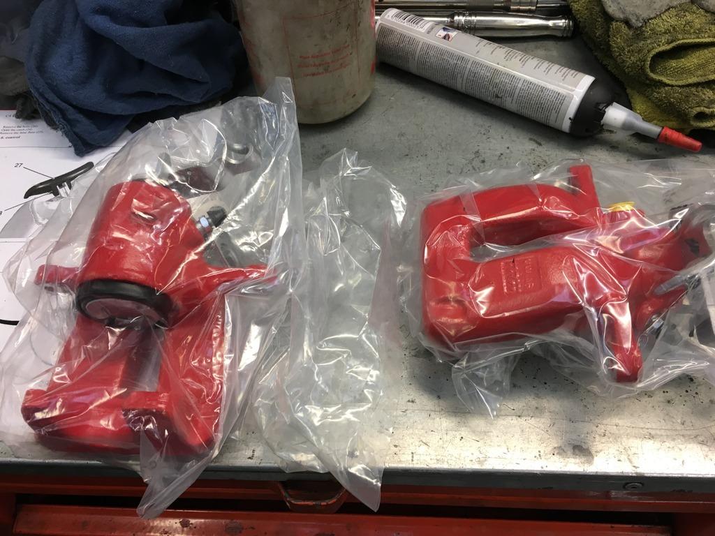

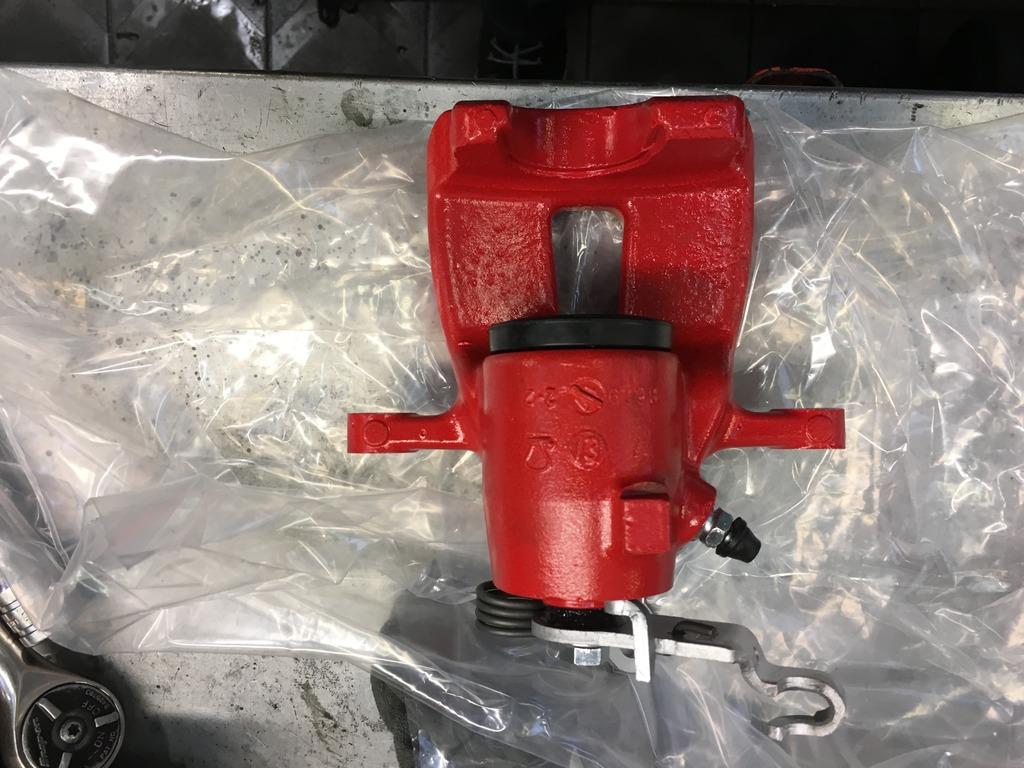

Plus got a pair of new rear calipers and Brembo disc/pads
In the workshop:
A few of the goodies:

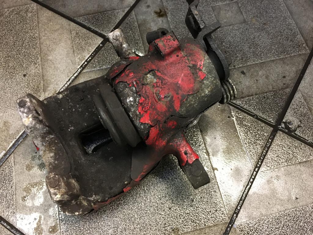

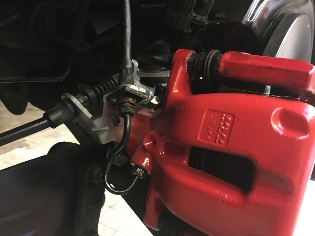

New rear calipers:

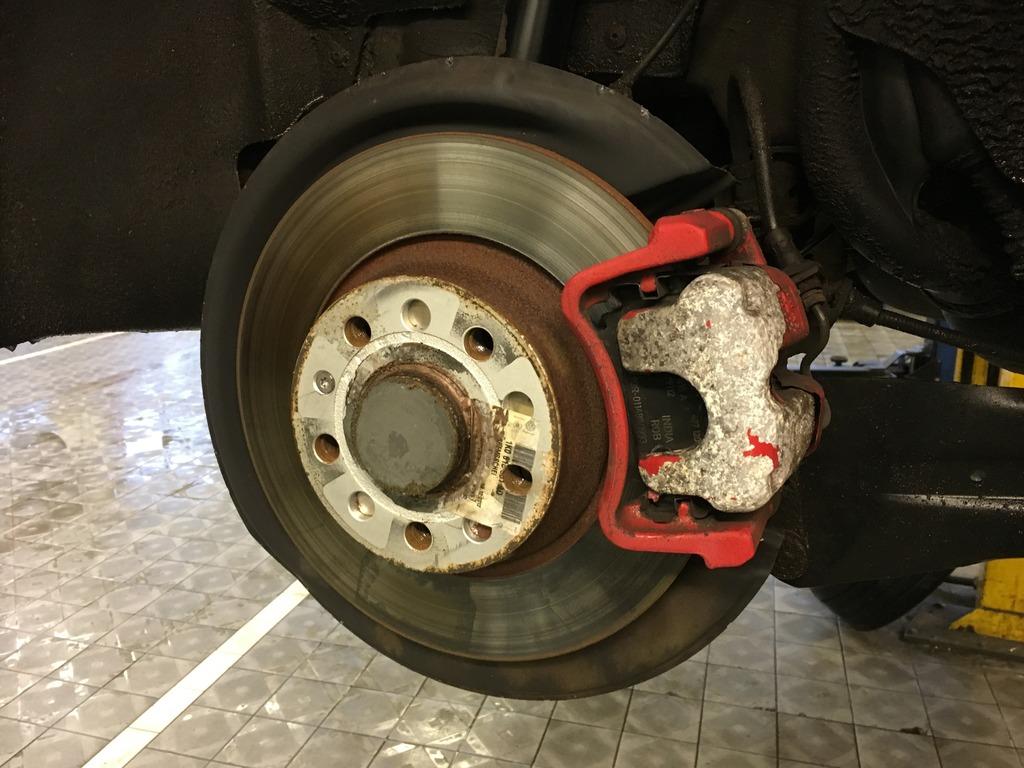

Up on the ramp for service:

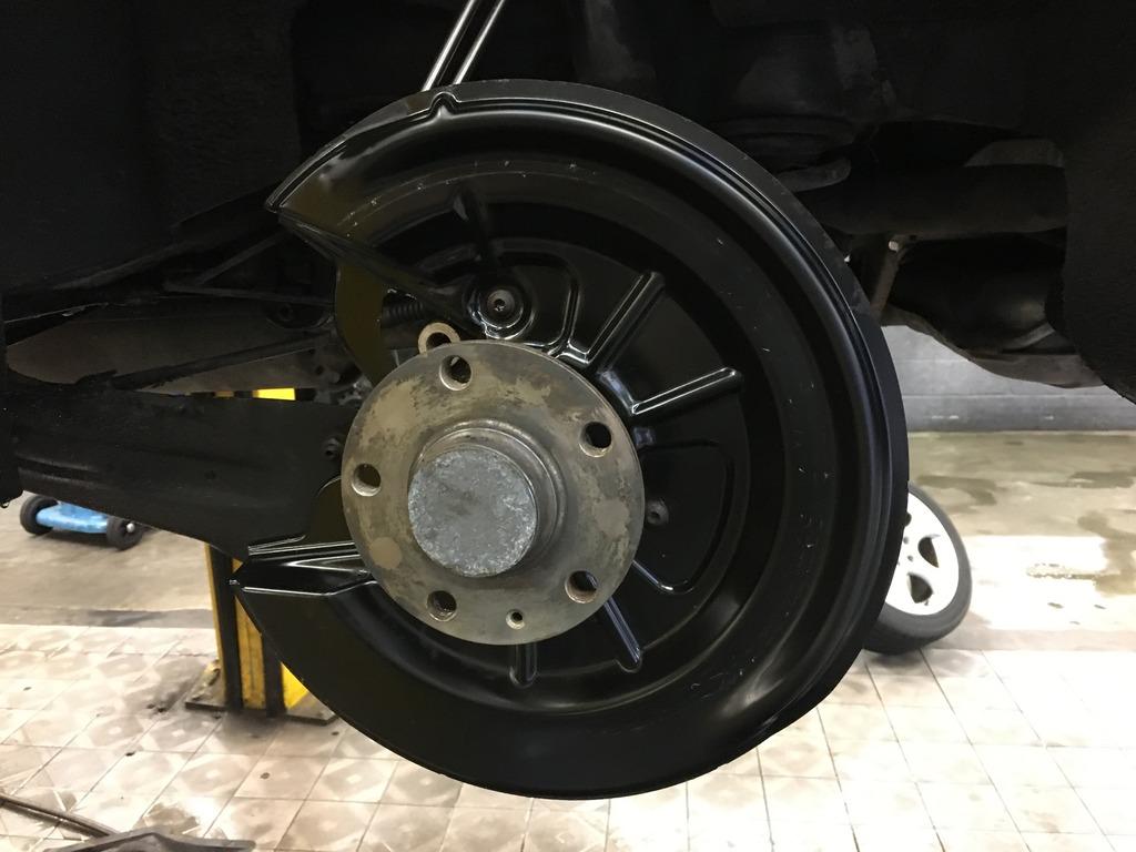

Rear brakes before:

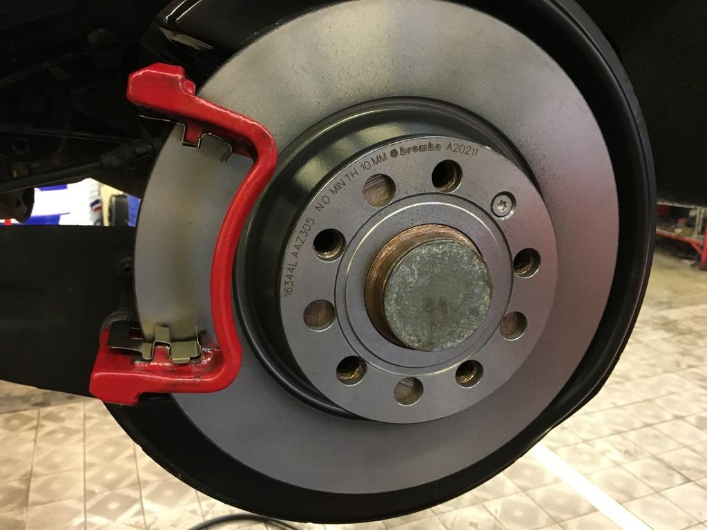

calipers/discs off:

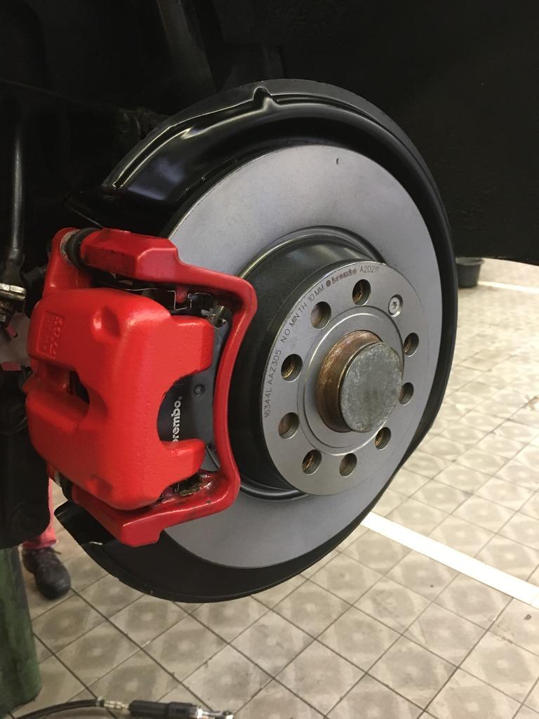

Gave all a clean up:

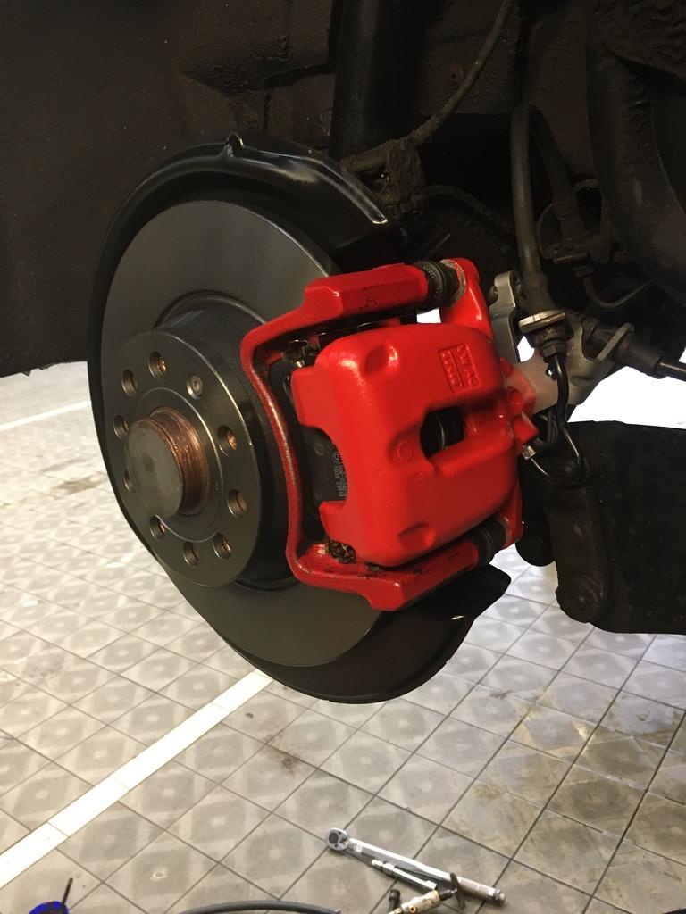

New ready to fit:
Much better:

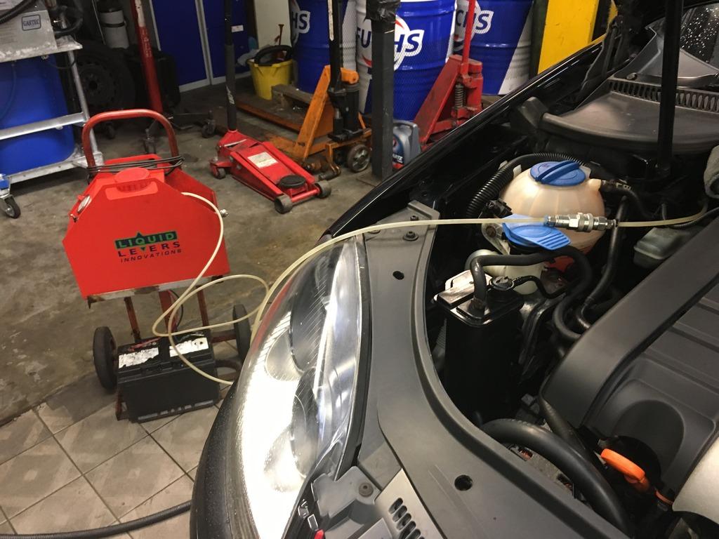

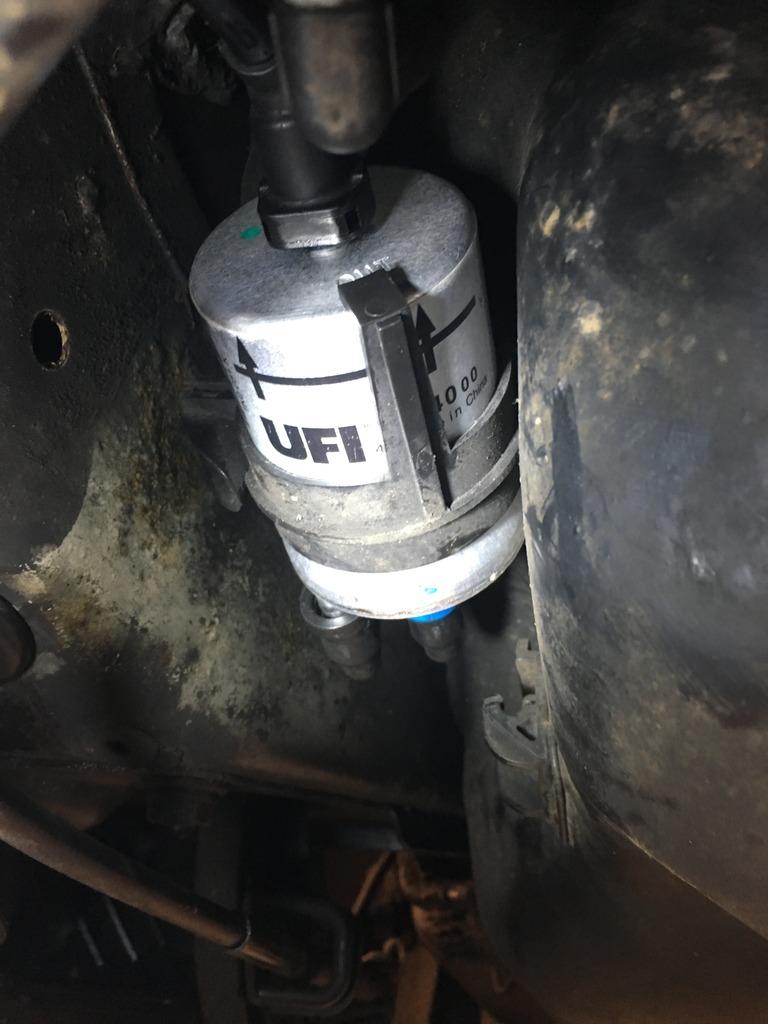

Bleed the brakes and new fluid:

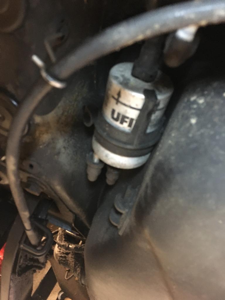

Old fuel filter:
New:

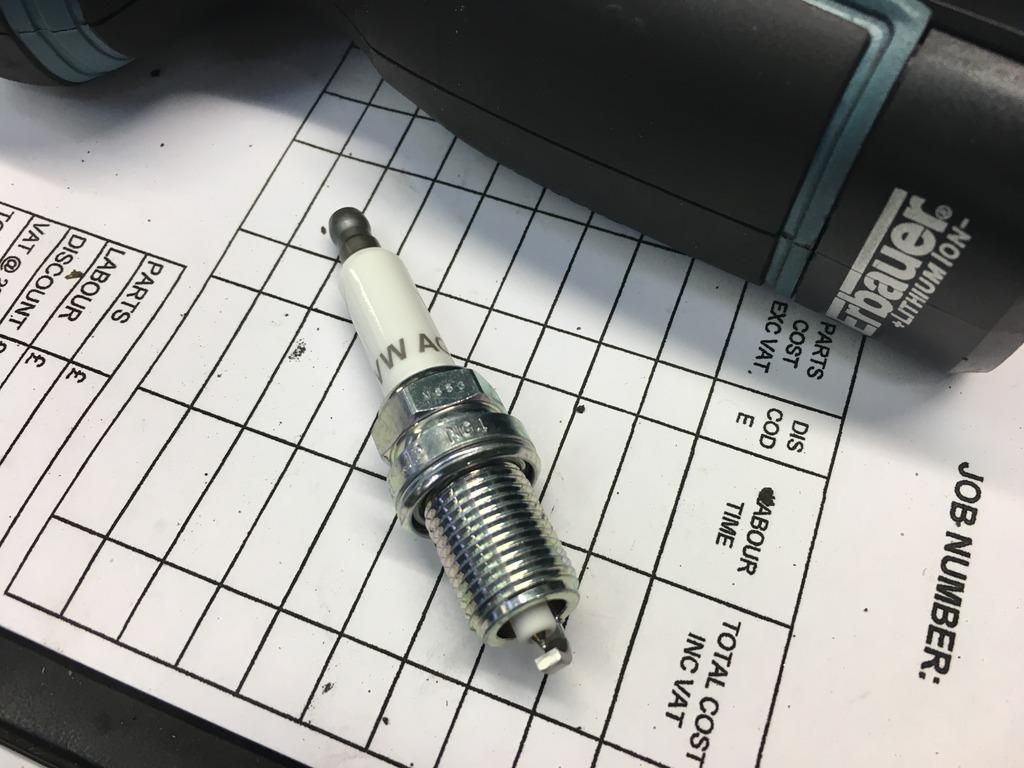

Plugs:

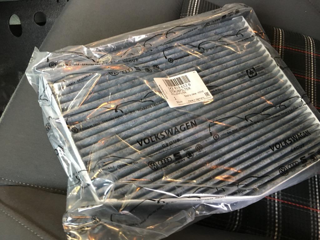

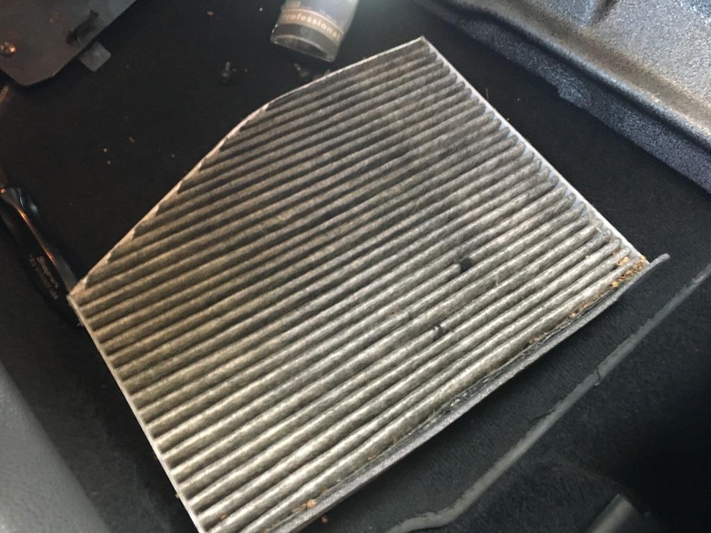

Pollen filter:
Old a bit messy:

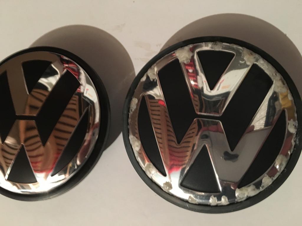

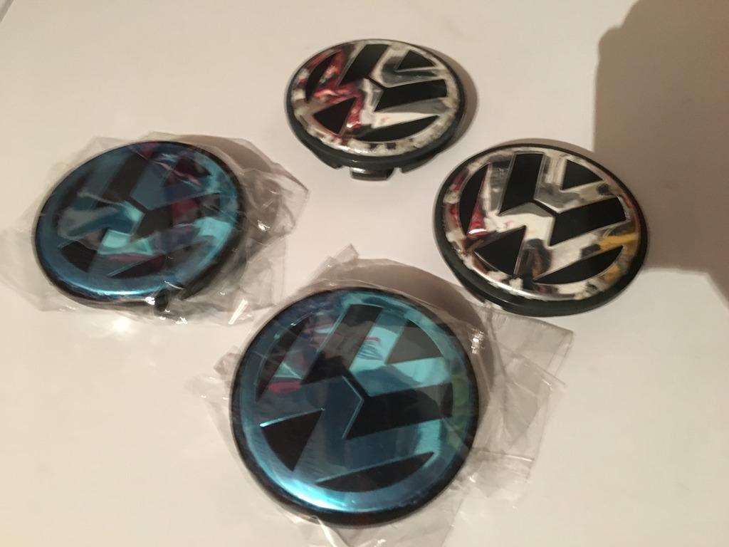

New centre caps:
All back on the ground and a little test drive. Much better after service plus rear brakes. Have new front discs/pads and shields to fit next.
