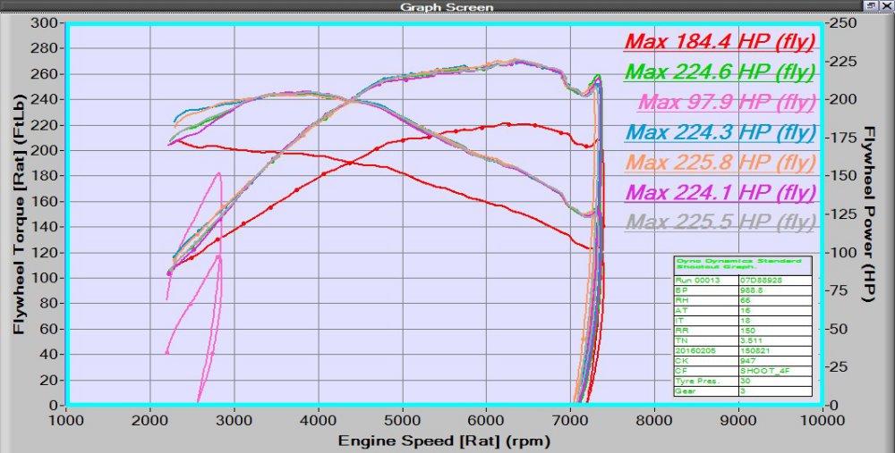

The standard pump fuel in Ireland is rubbish!!
More like American fuel than U.K. or rest of Europe fuel. 95RON at best over here.
When my car was mapped initially (same tuner as fab5freddy) it only made 184hp and 200ft/lb bog standard. And 224hp - 240ft/lb after stage 1 map. Most UK cars will make 200hp standard and 240/250hp after stage 1.
So we're starting with a deficit.
When I asked my tuner his thoughts he commented on the possibility of the ECU pulling timing to compensate for our rubbish fuel. He's certainly seen it before.
Now that I'm running the NF I imagine the car (hopefully) has an Octane somewhere closer to what it's designed to have (circa 98/99). Therefore it's probably performing closer to its design specs!
It will be very interesting to see if a car like Shoduchis, which is used to a diet of 98RON, will see an appreciable difference from the booster??
Here's my Dyno plot for anyone that's interested...

That's exactly why I went for it. It was the knock protection I was after. E85 is unobtanium in Ireland. And water meth is quite a lot of hassle so I thought I'd give this a lash!! My personal results (grant it only on my butt Dyno) have really surprised me. Joe Power (who is Irelands Niki Gower - and good friends and a collaborator with Niki) swears by it.
Since my stage one Map (Dyno print above) I've fitted new red coils, a DV+, a full 3in TBE exhaust, and a ramair oversize induction kit.
