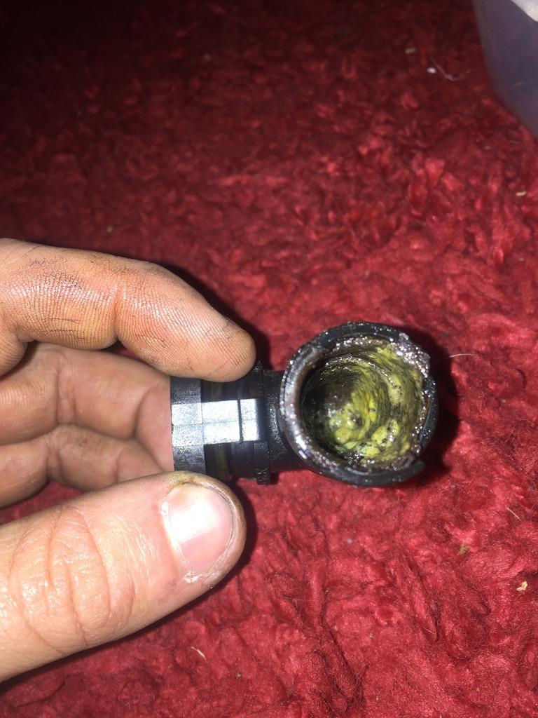

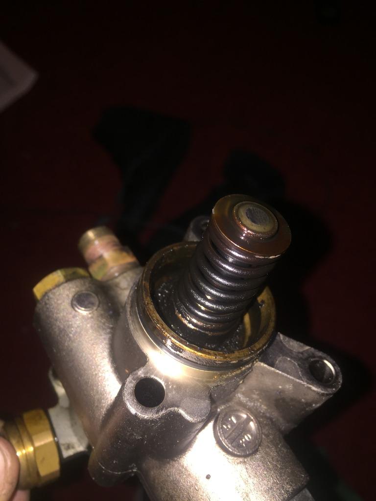

Scanned with cheap code reader and came up with p2293. I couldn't find exactly what this meant. But something to do with fuel pressure. When i removed hpfp to check cam follower, the spring of the fuel pump was covered in oil, as was the follower. There was also a pool of oil in there, not just a little. when removing the pump i had to move the thicker pcv pipe on the right out the way to get in at the banjo bolt. as i did this it snapped and it was full of milky gunk. Also got a little under the oil cap but i thought that was normal with short journeys.

The oil on the hpfp and the puddle in the cam chain cover is normal. You want that bit swimming in oil - that's what stops it from going bang.

Right thank you i can put my pump back on!

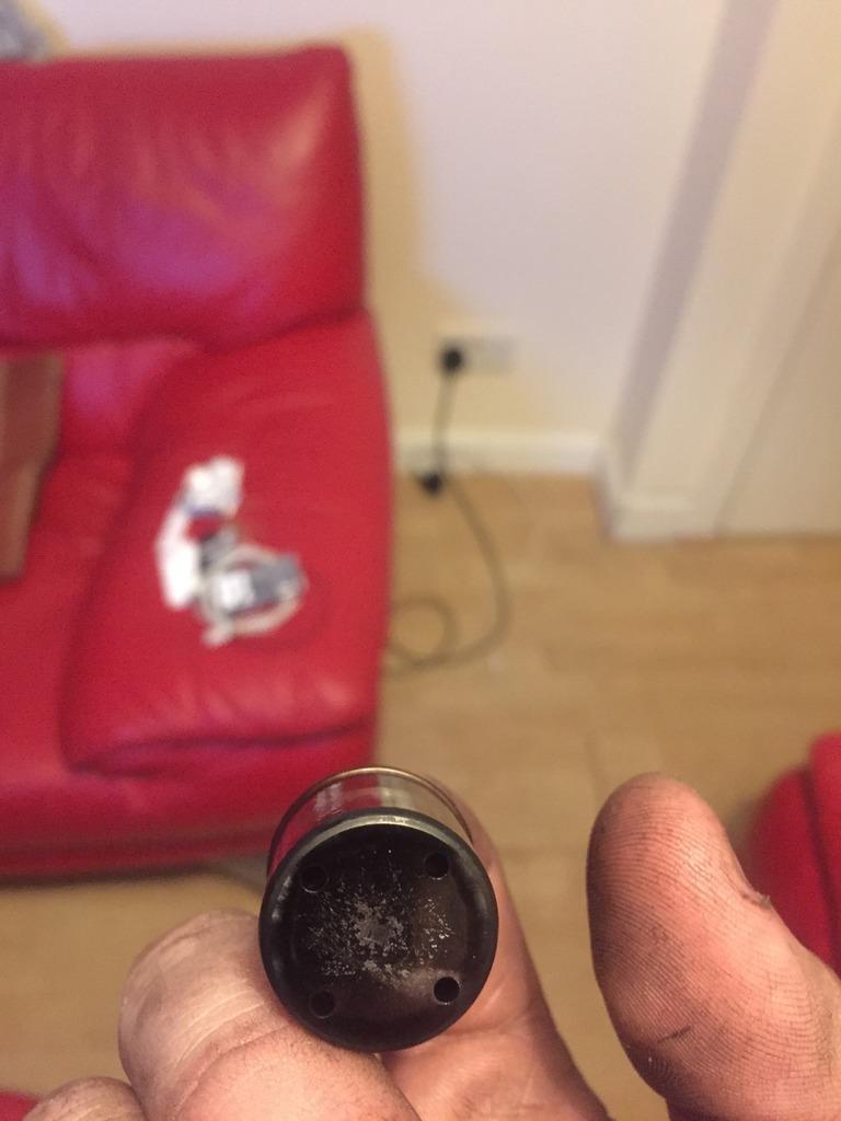

With the pcv, what is the thicker pipe on the right called? Not the one that runs to intake manifold. Ill post pictures when im home from work.

The one that runs down to the block? Not sure what it is called. Be careful with it as they can be brittle.

Yeah i know, i've snapped it already  :doh: thats how i discovered it was all milky inside.
