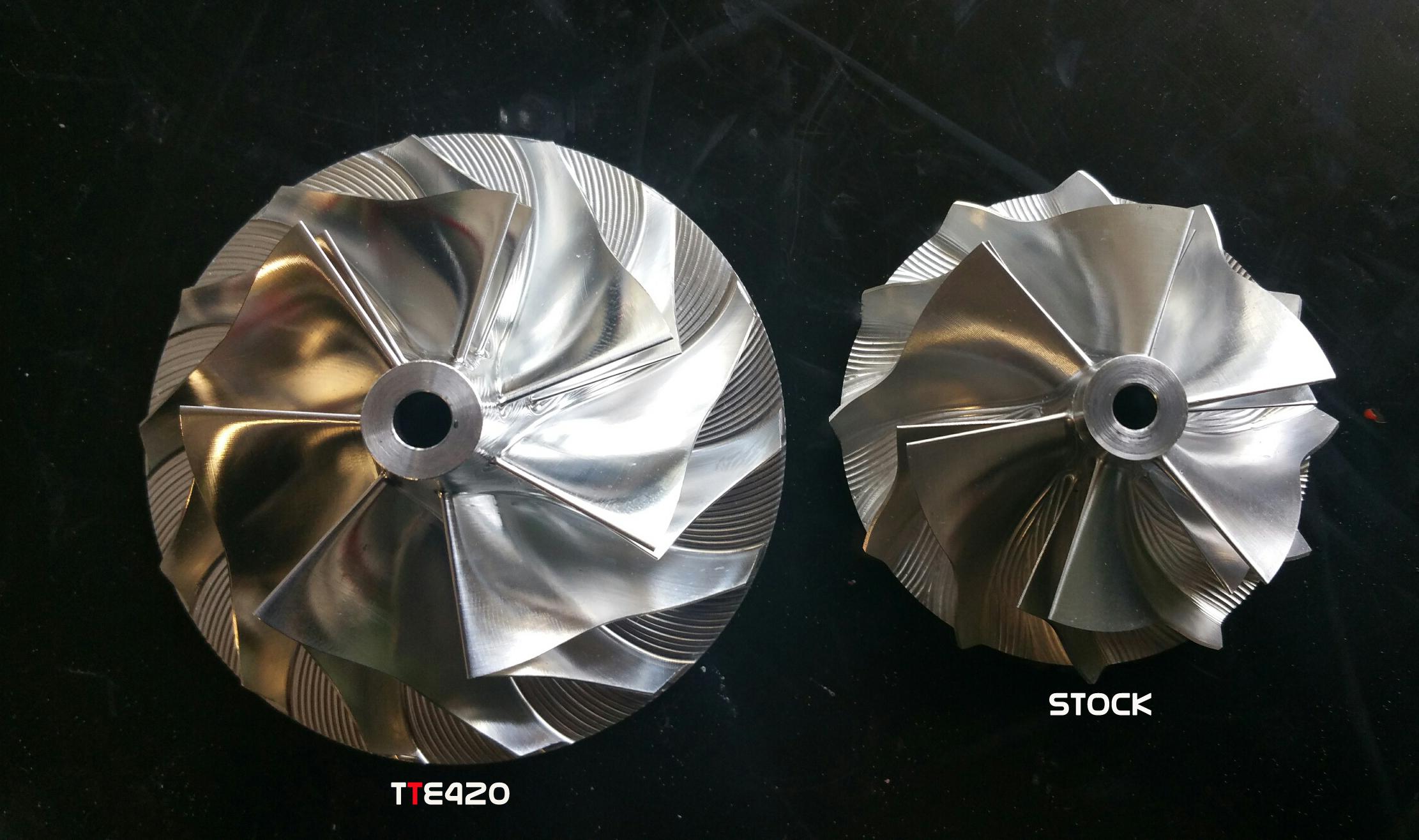

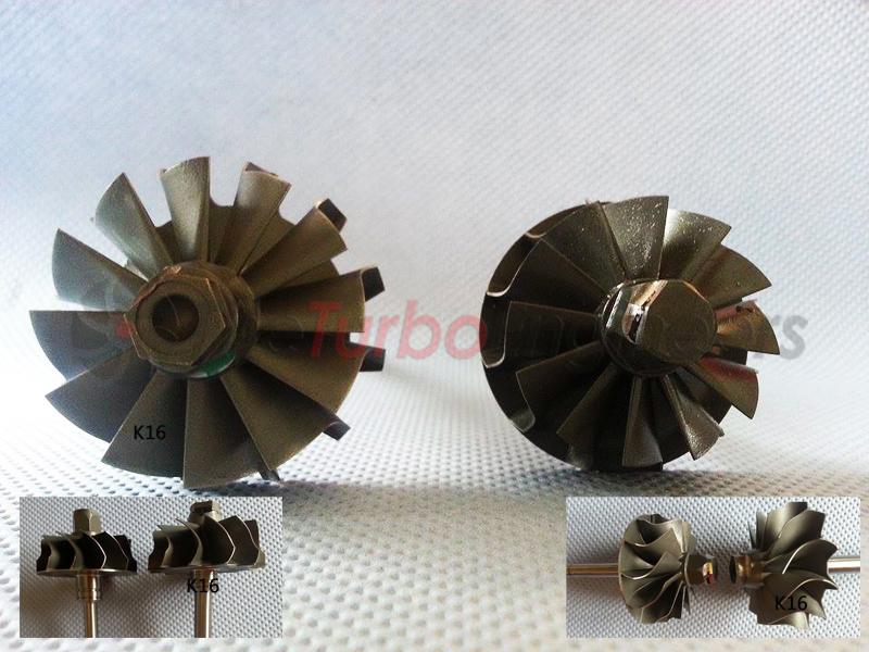

350hp from a TTE420 vs a KO4 is not daft at all imo.  Look at the size of the turbine and compressor wheels on the TTE compared to K04.  Masses more flow.  This will give a broader torque band and will achieve the same peak hp from less boost, meaning longer turbo bearing life and less stress on pistons and rods.  A slight increase in spool up time is easier on the gearbox too.
