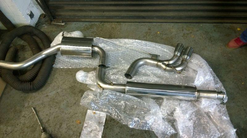

Opened box and saw exhaust for the first time, both of us amazed at diameter of pipework and finish of workmanship  :congrats:

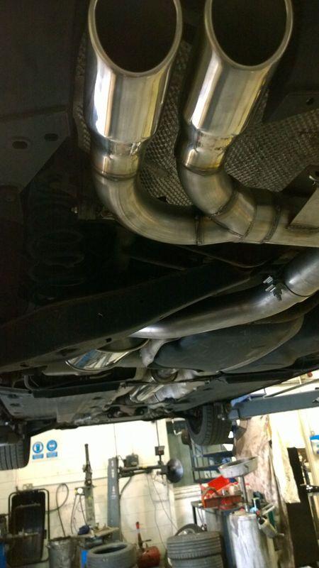

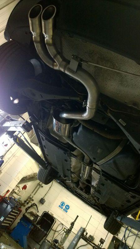

Quickly removed old section of old system and started to fit new, which as it happens only took 1 hour from start to finish, again, testiment to the quality of the workmanship. (which can't be said for the quality of the photos, not me, honest!)

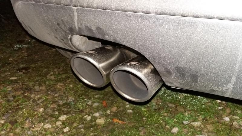

The only issue I have is the tail pipes seem to be a bit low, doesn't look bad unless you look straight from behind. Although the original was quite low, so maybe just me being fussy.
Again, not a good picture but will get better in the morning.
Overall, chuffed to fk with it, sounds amazing, fantasic value, amazing quality and good service.
Apologies for the lengthy read, but credit where it's due to @Powervalve Nige
Any comments welcome, especially on the finished height of the tailpipes and if there's a way of raising them slightly, we had looked at bending the rear hanger, but couldn't decide at the time if it was too low or not  :stupid:

Not sure what to tweak to be honest, the only thing we could see to move was the rear hanger on the left hand side. This looked bent on mine but not sure if this is supposed to be like it.

On mine there's a join just in front of the fuel tank that gives better adjustment than messing about with hangers.

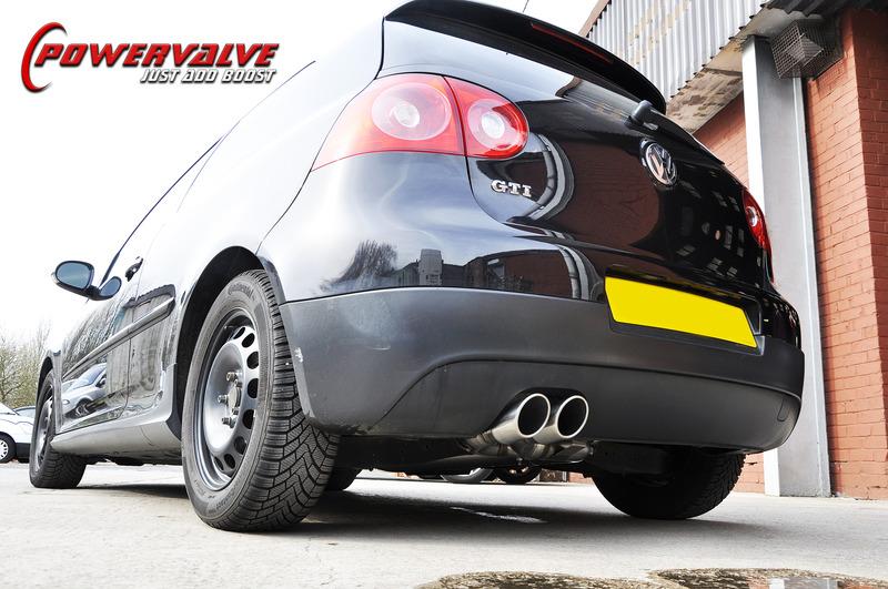

Here's the fitment on my BCS and it looks much neater. Maybe because it was fitted by Nige and his team?

definately the tail pipes are to low,needs a bit of tweaking

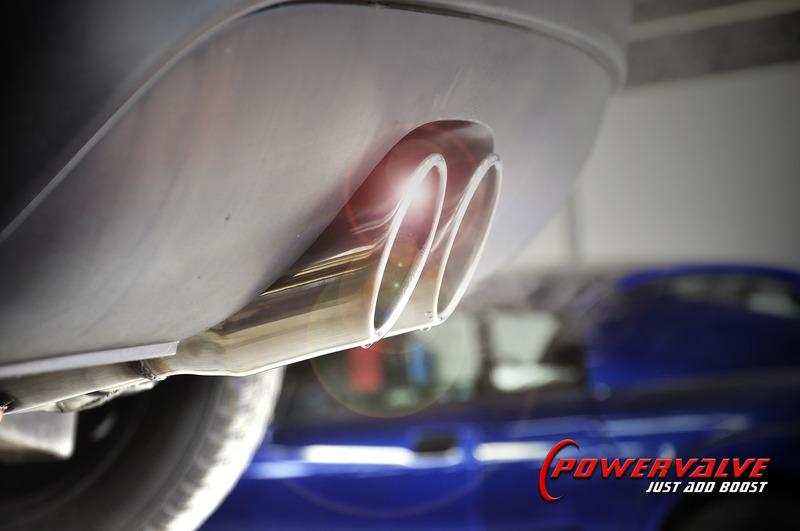

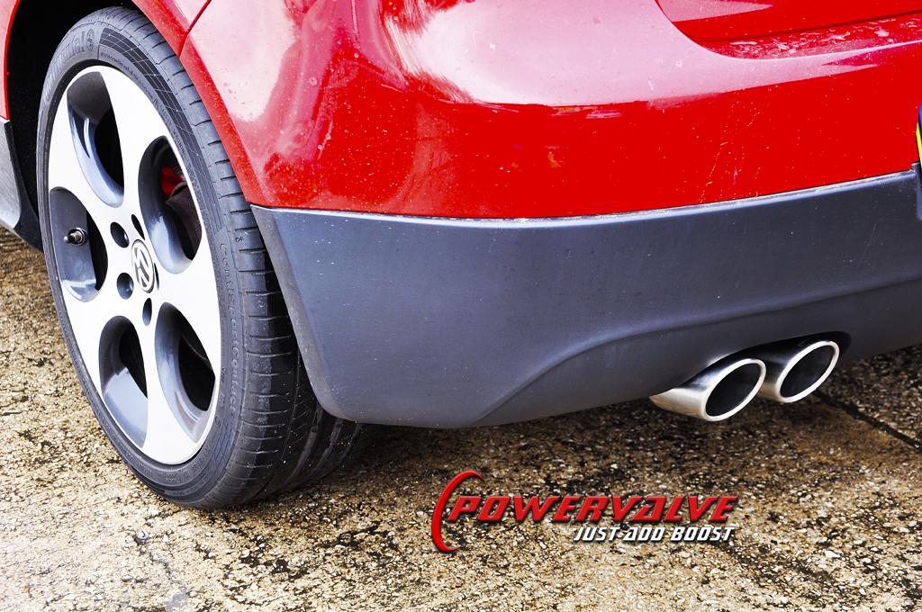

Really glad you're happy - yes that tail pipe is considerably out of alignment... certainly using the picture of the oem tails as a reference point.
We get this a lot of the time when aftermarket systems have been installed, very often oem hangers on the chassis have been bent to compensate for poor quality systems.
If you can tweak that rear hanger then you should be aiming for this...

Thanks for the replies, I suspect the rear hanger needs tweaking because if you look at first picture of my old tailpipes they were very low as well. I noticed it wasn't straight when we had the car in the air.
How robust are these? will they snap if I genty tap it with hammer or does it need heating up first?

Yes - tap it gently... that's what we do. It's mild steel so it should be ok
