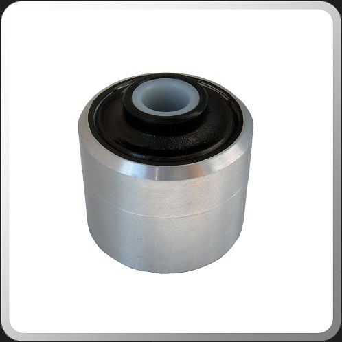

No the Vibratechnics.
I haven't tried DLI mounts but know of them in MK4 R32 circles in America.  Apparently no increase in vibration, but a big increase in noise, which is to be expected from mounts made of metal!  Again, they aren't cheap either.
For those not familiar with them, they do away with rubber / urethane completely and use a spring with some steel wool in the middle.  Well, the latter is a bit more technical than that, but is essentially what it is  :smiley:  It's damper material.

I completely understand that mate.  It cost me £450 to shod my old R32 with Vibratechnics mounts, so it's a big investment for something you're apprehensive about.
For comparison, the 034 Motorsport ones are £286 ish from Awesome, but I have a feeling they will feel great for 6 months, and then rapidly deteriorate.
VibraT are a small company, so you will rarely find a good deal on them, unless a supplier can do a group buy and swallow the VAT or something.

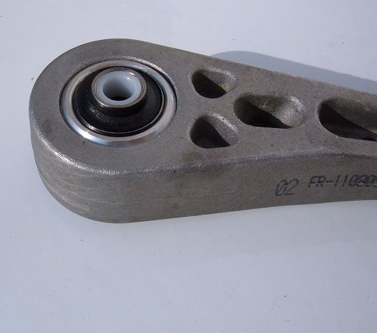

Worth mentioning Vibratechnics also do an upgrade for the other end of the dogbone:
http://www.vibra-technics.co.uk/vw/golf_jetta_bora_vento_mkvvi/666/VAG455B/torque_link_dogbone_bush_small_end
With the bigger bushes upgraded, I've found the smaller (voided) one takes more punishment and wears out quicker.
I would recommend doing both ends of the dogbone with Vibratechnics and new OEM side mounts and see how that works out.   That will significant reduce front to back slop and wheel hop, but to improve cornering stability, the side ones will need doing at some point, but they really do add a lot of NVH.
