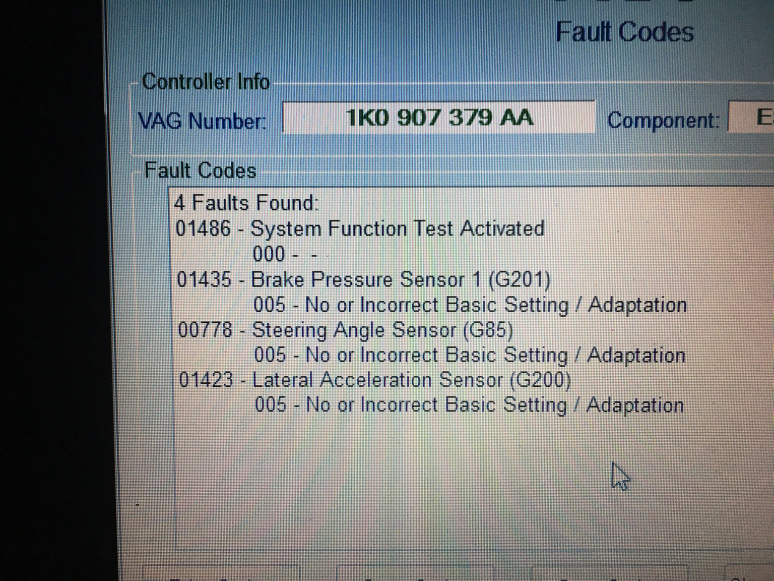

Tried removing the faults but they don't erase. I want to be able to fix it myself than spend money someone please help

The brake one I had a play when i got vagcom new and I want to return it to default

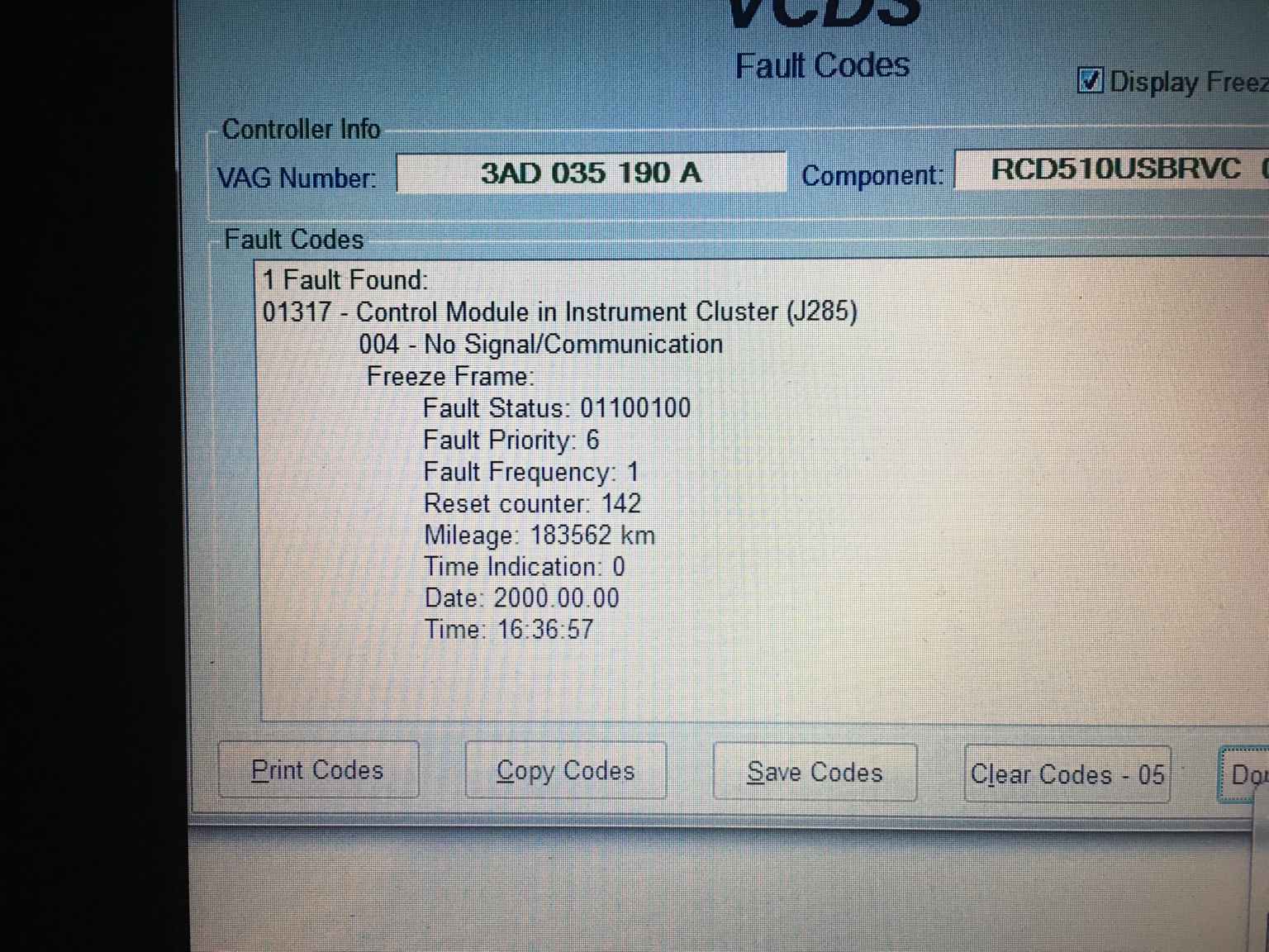

Ok second pic I noticed the date is on 2000

Youve activated the ESP calibration - you need to complete it - you can't just clear it:
http://wiki.ross-tech.com/wiki/index.php/ESP_System_Function_Test
As for the second image, take a look here but it sounds like you'll need a new instrument cluster which requires specialist coding - not a DIY:
http://wiki.ross-tech.com/wiki/index.php/01317

Perform the basic setting in the ABS
http://wiki.ross-tech.com/wiki/index.php/VW_Golf_(1K)_Brake_Electronics_(MK60)#Basic_Setting
then complete the function test
http://wiki.ross-tech.com/wiki/index.php/ESP_System_Function_Test_(Conti/Teves
I wouldn't worry about the cluster fault if it only is in the radio
Probably an issue with the Chinese radio not getting the message from a newer cluster. Might also have to do with the coding in the radio
