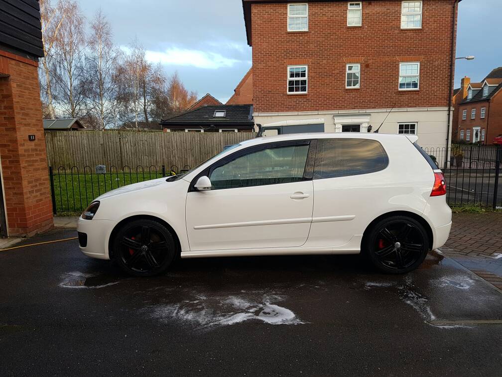

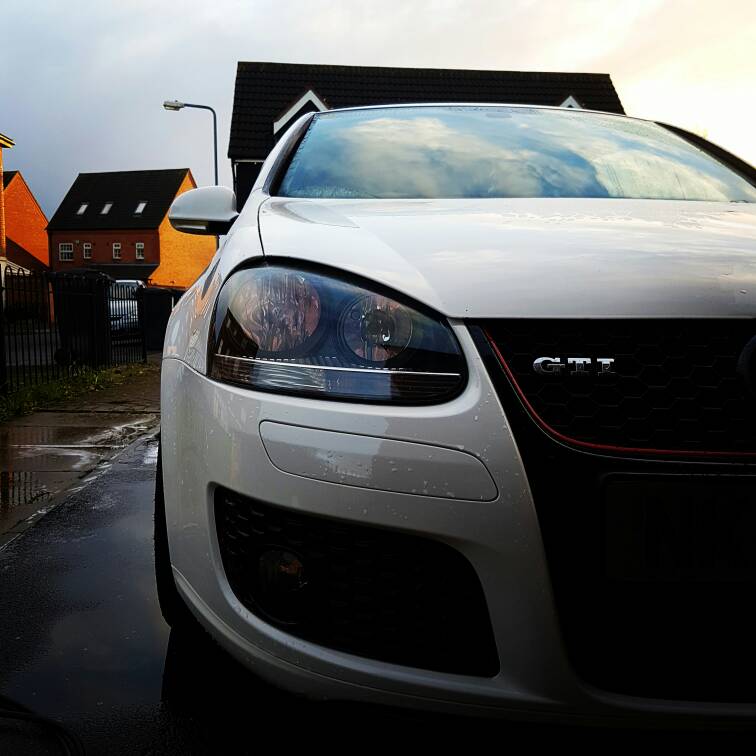

Iv just brought my first vw and it's a much waited for golf gti 2007.. I absolutely love it iv had a saab 9-3 aero for the last 4 years which ended up being 413 bhp after all the time I spent on it... Being new to the engine in the gti is there anything that needs attention at the 100k mark essential maintenance or replacement of parts?
Your help is greatly appreciated
