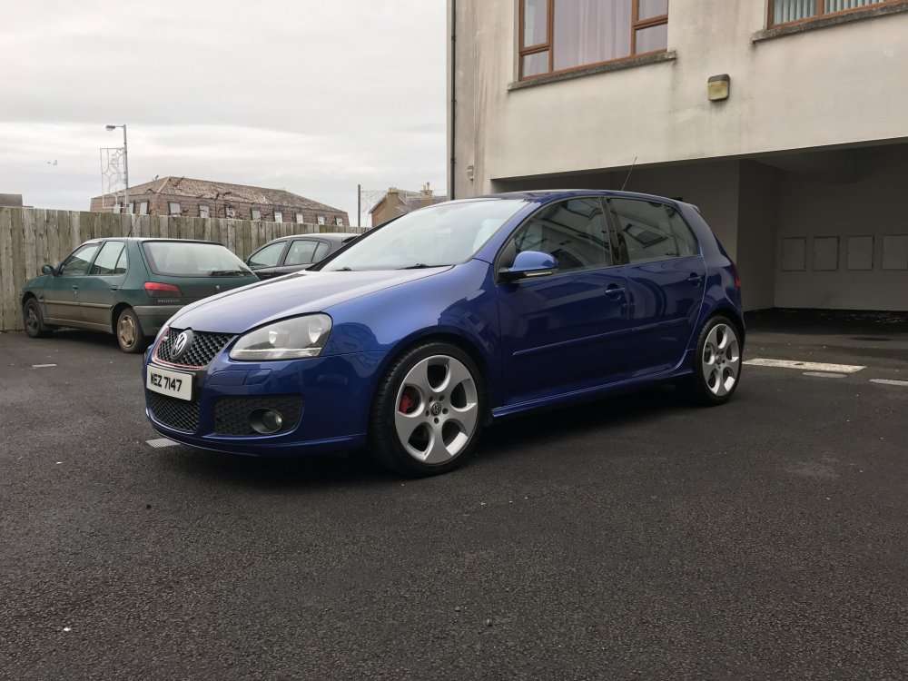

Hi there,
Just bought my first VW this week, a 2005 GTI in Laser Blue.
Coming from a very boring Ford Mondeo this little thing is amazing!
Mods so far:
Revo Intake
3" Downpipe
200 Cell Cat
Resonated center section into powerflow rear section
Forge PCV Delete
Mapped locally by Autotune
