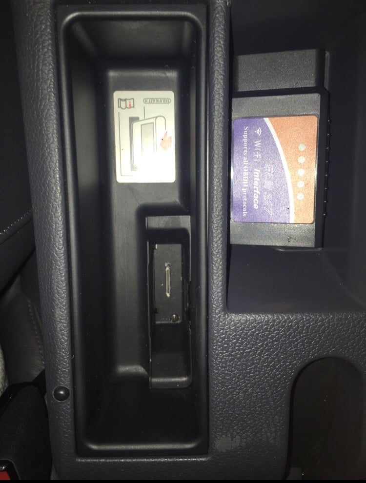

So I have this under the armrest.
I also have RNS510.

Probably the dock is too old to recognise the new Apple interface on the RNS510. Most likely you need a MDI dock and cable to get the iPhone working as intended like the one shown below.

Like PatchySan said, you need a MDI module with a lightning connector. That Ipod connector is too old and not compatible with RNS-510.
