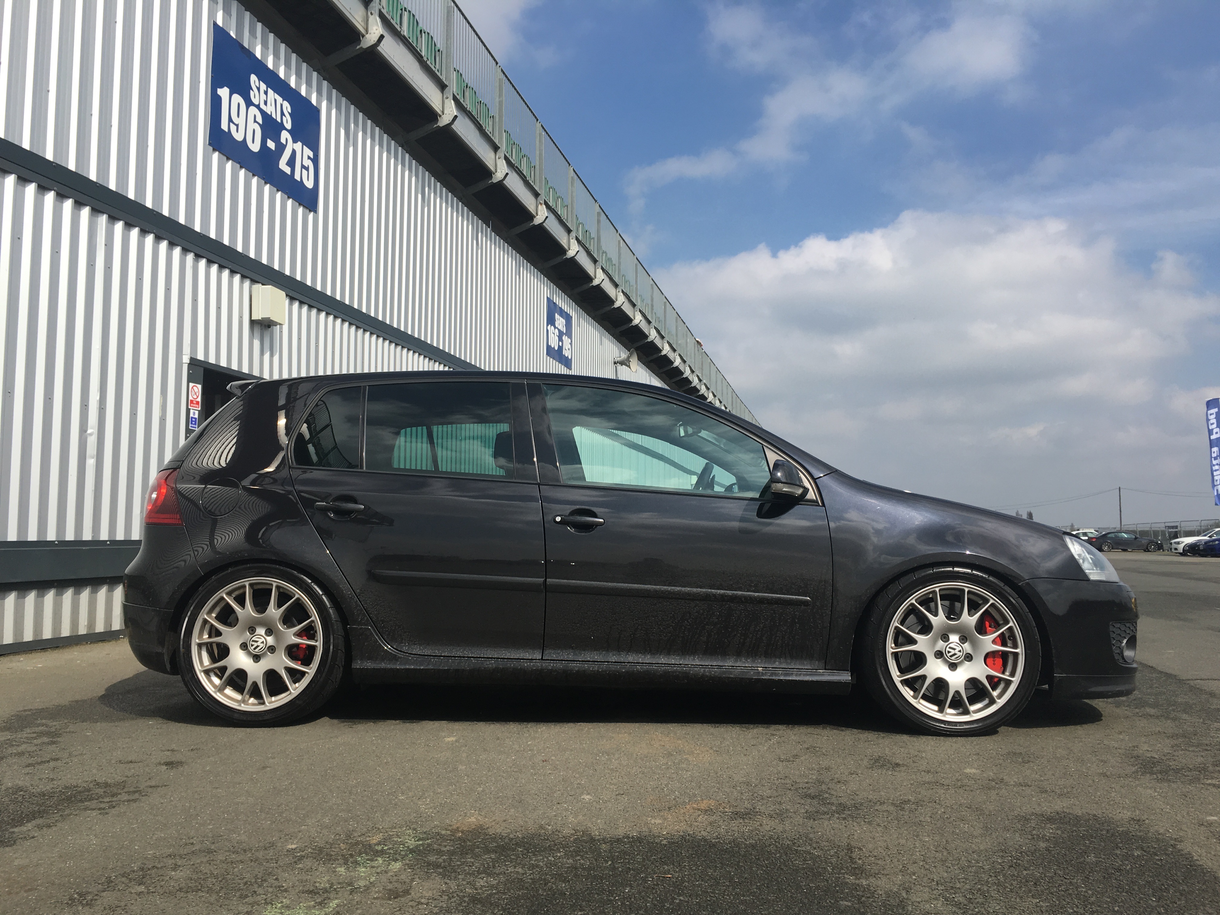

« Reply #20 on: January 03, 2017, 04:00:54 pm »
IMO this is just about perfect ride height.

« Reply #22 on: January 03, 2017, 04:06:48 pm »
Agreed. Maybe 10mm more at the front.
Is this yours on the Bilsteins?

That only looks about 20mm lower than my standard ED30!

Looks a fair bit lower than my GTI on H&R springs!
Yeah KW do 'Basic' or at least used to, which isn't stainless. Bit pointless when a few extra quid gets the proper stainless ones.
Must be a visual thing then because mine hits kerbs with the standard ride height!

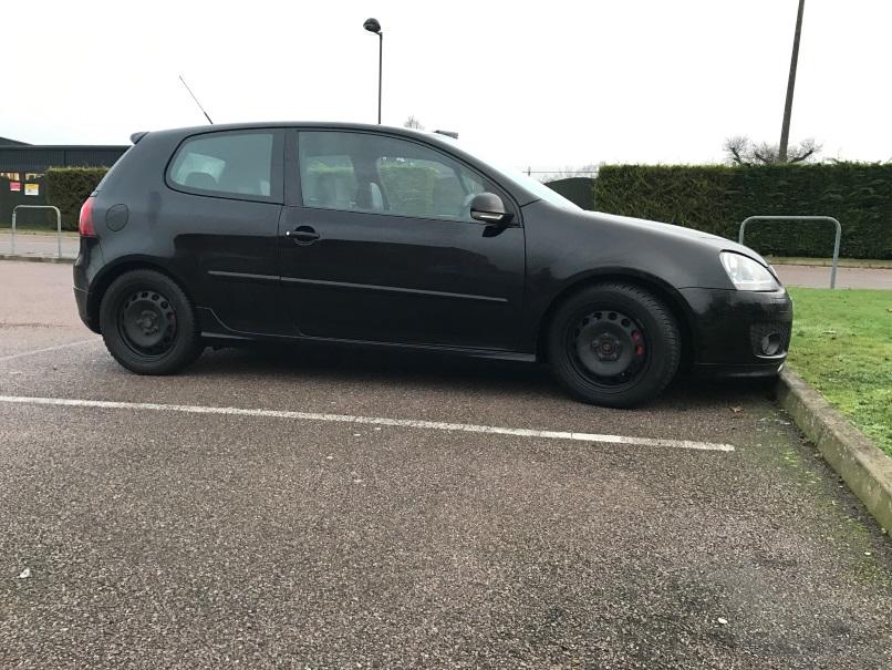

This is why floor to arch measurements would be handy to me. Two identical cars can look different heights depending on the photo.
But I can tell yours is definitely standard...  Practical winters and all

« Reply #27 on: January 03, 2017, 05:08:40 pm »
Glad it looks standard as I was thinking it looks too low for OEM!
Yeah I threw the winters on out of curiousity!  Got them cheap  :smiley:   16" = great ride quality, but on damp roads the grip is shockingly bad  :grin:    Pesceras going back on this week!  Experiment done, probably never to be repeated!
So long as you get the stainless ones mate, I forget what they call it, "Inox" or something, you'll be fine.   Unless Bilstein / HR / Koni etc have improved their strut body anti-corrosion in recent years, I won't be entertaining them again.
Nah its way lower than 20 mm... Ive not measured it but i suspect its in the region of 35-40mm
AJP. yep Bilsteins. Its actually more level than it looks in that photo because of the shadows and highlights on the tyres. I wouldnt want to run it any lower.

This is OEM..
