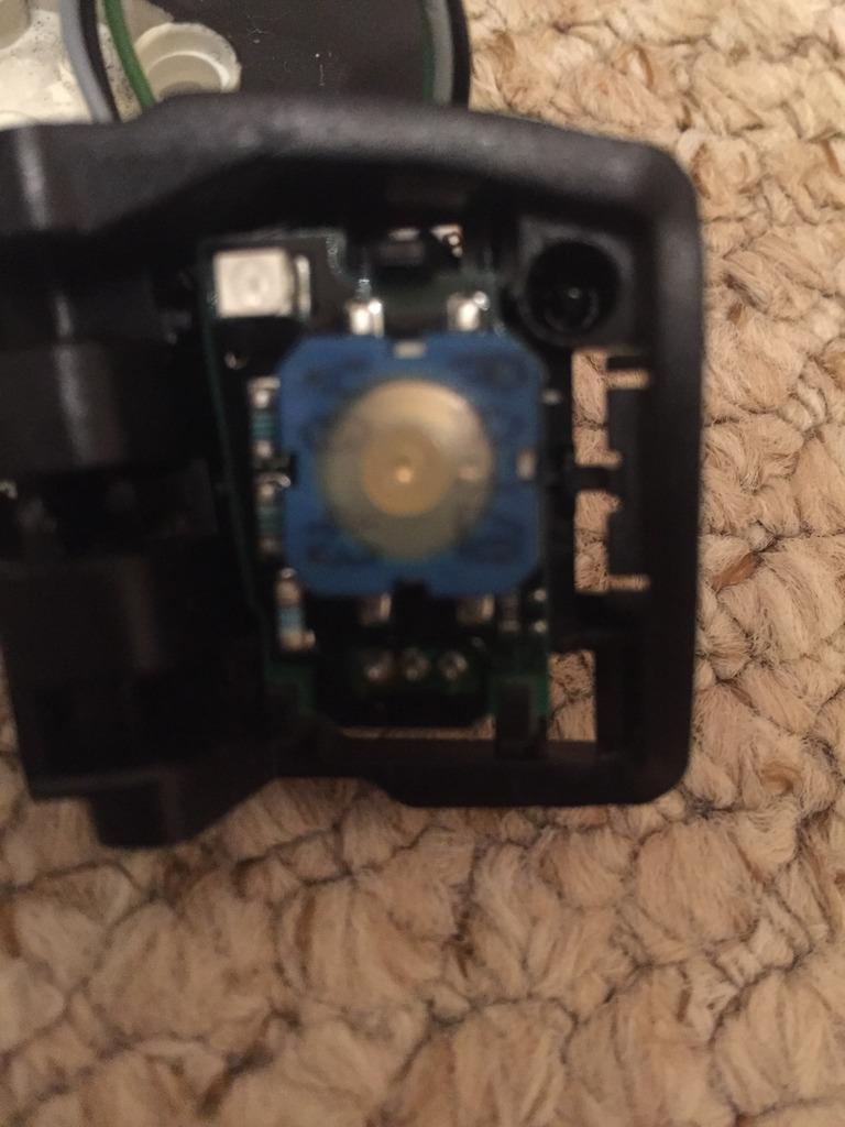

Hi all
Just noticed my - paddle is not lighting. Is there a replacement bulb for this and where does it go??

Its probably a small SMD thats in the actual paddle.

It's odd just took it apart can't find the bulb anywhere inside of it. It works fine just doesn't light up

Anyone got any idea where the led is in the dsg paddle ? Ta

Don't think you can replace the led mate probably have to change the whole paddle
https://i.imgur.com/CGZ3DaG.jpg

For future reference its the smd in the top left corner

oh Thank you so much!!!
u dont know how annoying i was finding this
