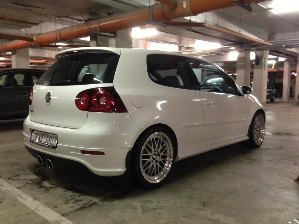

Offline mkmg76
  • Posts: 201
Re: Anniversary MK4 rims on MK5.
« Reply #8 on: January 13, 2017, 02:42:39 pm »
Offline mkmg76
  • Posts: 201
« Reply #9 on: January 13, 2017, 02:43:45 pm »
Anyone willing or able to photoshop a set of MK4 Anniversary BBS RC rims on please?
« Last Edit: January 13, 2017, 02:49:27 pm by mkmg76 »

Nice  :happy2:
I don't know if it's because your car is white, but they almost look as if they could do with being 19s for a bit more presence  :smiley:

Nice  :happy2:
The design of LMs do make them look small... odd I know

Nice  :happy2:
I agree mate, they do look a touch small but the roads around where I live would not really be what you'd call 19" friendly and I like to drive my car, not pussyfoot around like some of the posers out there! :confused:
I don't have a side on picture but the don't look as small from that angle. It's one of the reasons I have such a soft spot for the RC's, the design of the spokes running almost all the way out to the lip makes them look much bigger than they are.
