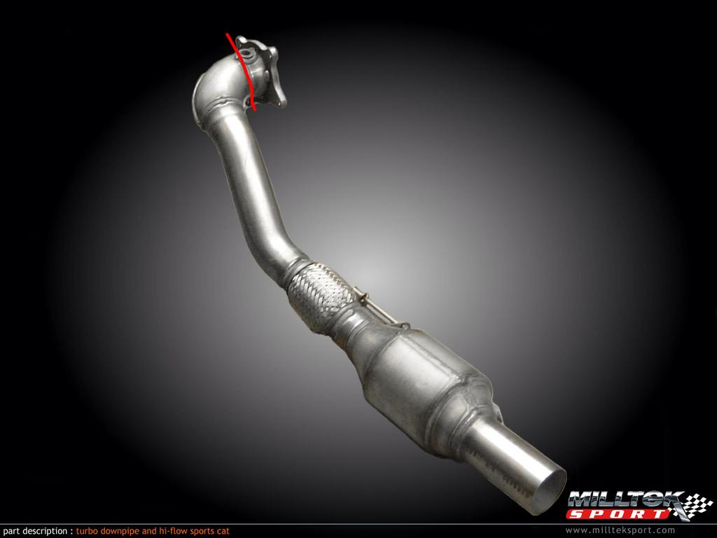

I have posted a pic of the part it has sheared off at. It's sheared off just after where the bolts are. The pic is a miltek but my exhaust is standard apart from the middle and back section which was a custom stainless steel one.
What is the section of exhaust called where mine has snapped? I don't know what to search for on eBay.

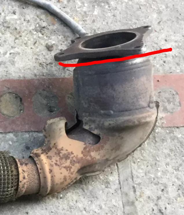

« Reply #4 on: January 30, 2017, 05:58:49 pm »
Better Pic

See it happen before.
You need a downpipe. The bulky bit is the pre-cat
