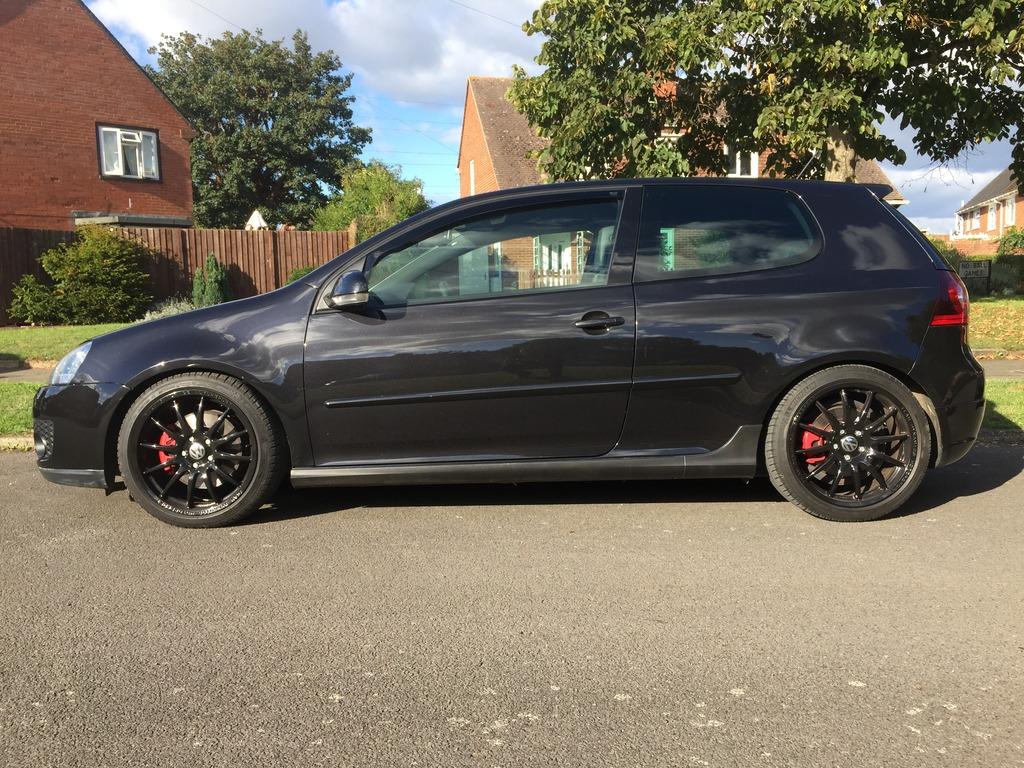

VWR springs and (new-ish) OEM dampers here.
I wouldn't want to be any lower in my area to be honest. I don't find the underside of the golf (mk4 or mk5) has very good ground clearance. Even at this ride height, the underside occasionally catches on narrow speed humps. I'm in South London and those barstewardss are everywhere. Something to keep in mind. I had a silly low mk4 gti and slowing down to a snails pace to get over speedhumps gets annoying really quickly....
2007 Golf Gti DSG | Leather Wingbacks | Xenons | VWR Springs | Tinted Windows | 18" Audi Speedlines |
