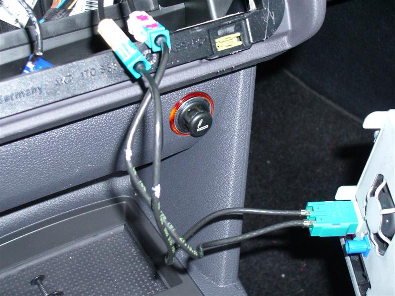

1) I've been informed said to me that as I had factory-fit MFD2 that I do not require the twin-jack FAKRA adaptor:
My MFD2 has got two (2) discrete wires with (2) FAKRA connectors... are these really "plug and play" or do I have to find this adaptor? I have a feeling I have to source an adaptor.

you need VAG com to reprogram, but you possbily wont ever notice if its not programmed (other than error codes you wont see), ps you dont have Soundack do you ?, when i changed mine i didnt get the two cable converters, i just removed the FAKRA plugs from the ends of my harness and they plugged straight into the RNS510, the older ones dont fit onto the new ones if you dont remove the Fakras as there to close together for the new unit (of far apart depending on how you look at it)

theres a guide for removing the plastic Fakra bits http://vwnavi.com/forums/showthread.php?t=7561
