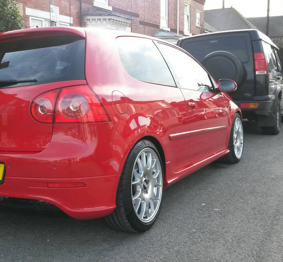

Have a quick search - there are a few threads just like this where people have posted up pics and what springs they're on.
But in the meantime, here's mine on H&R springs, around a 30mm drop:

« Reply #2 on: March 28, 2017, 07:44:51 pm »
Snap....H&R sports springs....
