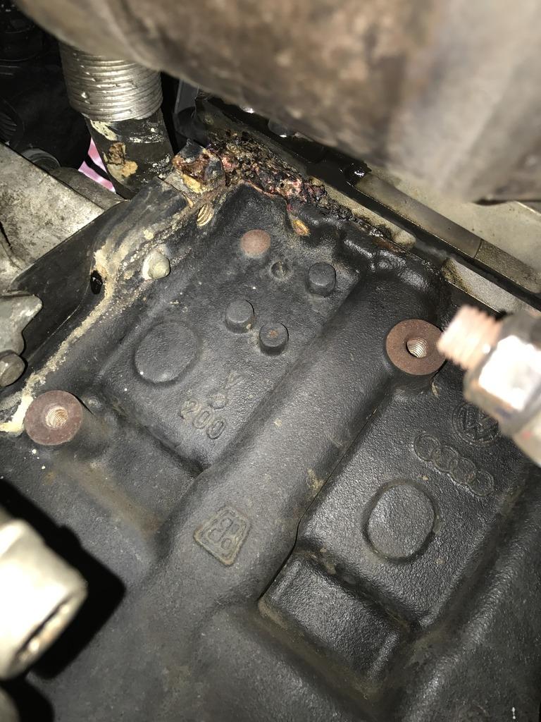

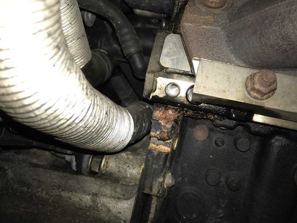

Next time you're under the car, have a look at the top left of the engine block, adjacent to the gearbox.  If you do have a head gasket leak, it's like to be there.  Quite common on KO4 engines apparently.  It's just a slight sweat of coolant and not getting into the cylinders, so nothing to worry about.  Pics below.  Mine's been like that for 30+K miles and not got any worse.  A new HG is on my to-do list.
