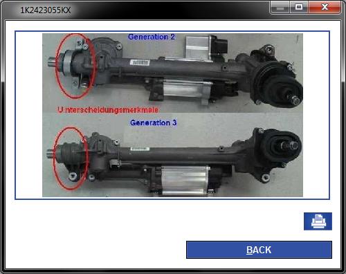

Remove the undertray and look at it from underneath, paying attention to the nearside and how it mounts to the subframe. This differs on all 3 Generation racks.
Gen 1: Uses 2 bolts to bolt the rack to the subframe directly
Gen 2: Also uses 2 bolts but utilises a U shaped clamp that goes over the rack and bolts to the subframe
Gen3: Use 1 bolt

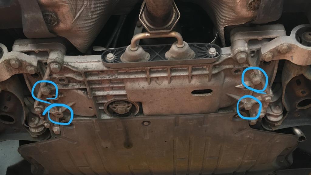

If I remember later i will find a clear image of each Gen rack so you can see what you are looking for. Throw some pictures up of your car when you get underneath it and I/we can tell you which generation you have

Is this info stickied on the forum somewhere?  It's really useful info.
Stumbled on this earlier:
