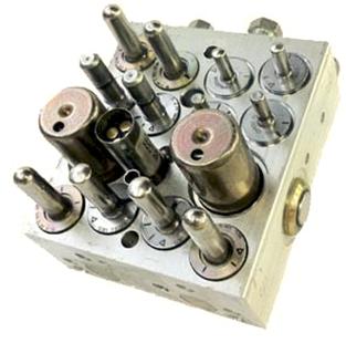

The pressure sensor is built into the abs pump and is a common fault mate. Few options you can buy a repair kit from the dealers or send yours off to be repaired.
Is the repair kit a bunch of seals and solenoid valves by any chance?   History repeating itself it seems!  Had the same issue with Corrado ABS pumps back in the day.  The valves used to seize up through lack of use......hence why it's important to cycle the ABS when doing fluid changes to agitate the crud and flush it out.   Kicking the ABS in on a quiet road occasionally probably wouldn't hurt as a long term maintenance thing.
