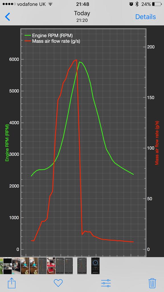

« Reply #8 on: May 08, 2017, 10:05:07 pm »
I did a hard pull to redline in 3rd this is what I got.

I believe logging the MAF sensor (g/sec) doing a full throttle run in 3rd is another good way of estimating BHP.
This is probably the best way.  around 185g/s is right for an ed30 so around 230bhp

« Reply #10 on: May 08, 2017, 10:17:31 pm »
She's had a map then. As she's a gti not an ed30 :wink:
