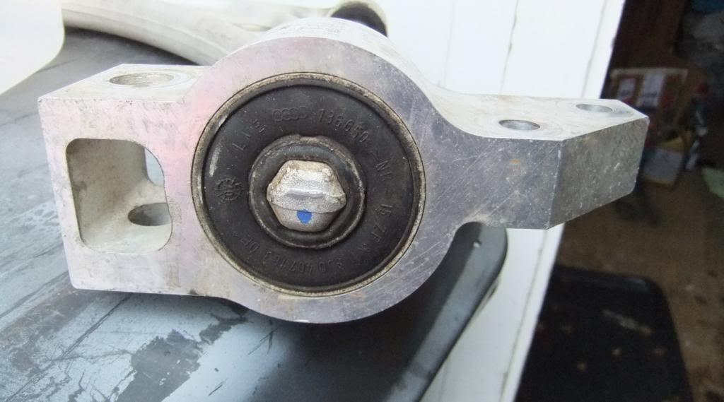

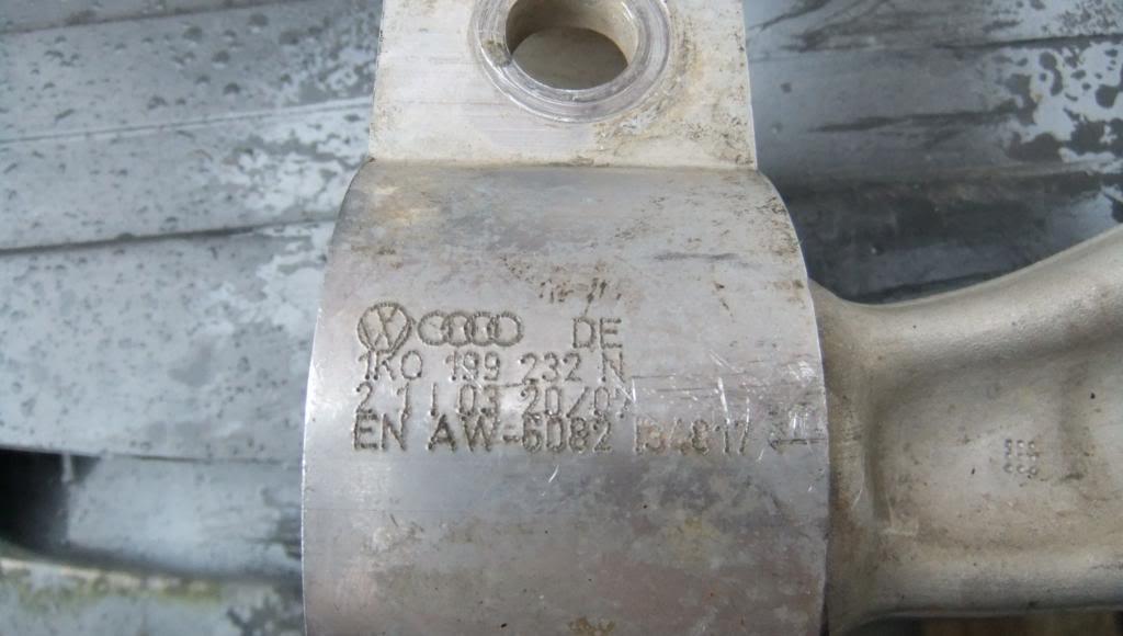

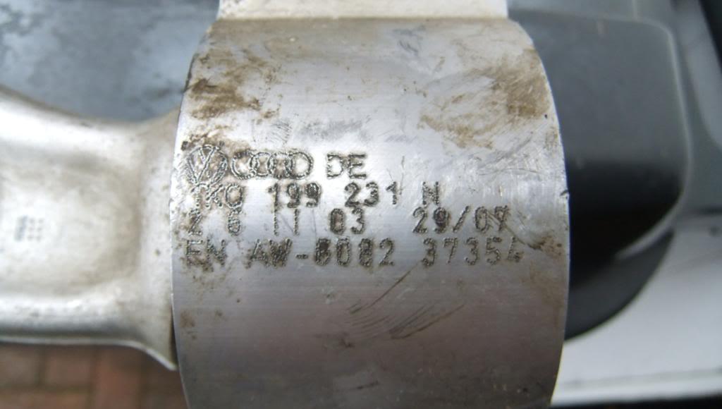

Here are the part numbers: -
And the key difference, the S3 on is solid  :happy2:
Offline QD MBE
  • -Receive: 102
  • Posts: 2497
Re: Front arm lower bushes - replace with WALK or stock?
« Reply #9 on: February 02, 2010, 10:19:55 am »
My thoughts exactly.  One solid bush is better than a bush made of 2 parts.  Just my thoughts and as ever ETTO.
