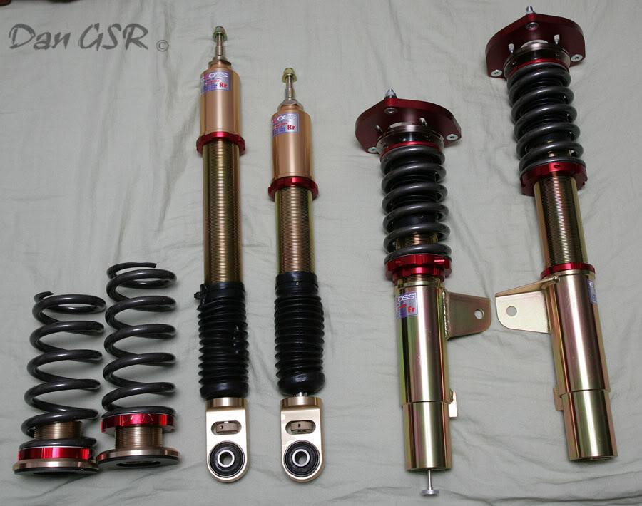

IMO i think the Cross Competition coilovers are the best on the market
It has all the features that most other coilovers do not have
1. Adjustable shock body length
        This allows you to lower your car without sacrificing shock travel. Most other coilovers achieve lowering by lowering the spring, this compresses the shock when the car is motionless, which means for each inch you lower the car that is 1 inch less of shock travel, which is bad for suspension. Without suspension travel there is no damping. You can see in the first picture the min and max settings for shock body length.

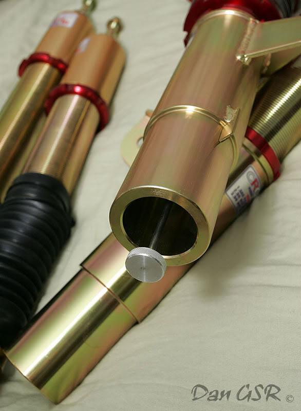

2. Camber Plates
        The only way to pick up camber on the mkV is with camber plates, something that most coilover systems do not incorporate on the mkV. Seen in the second picture.

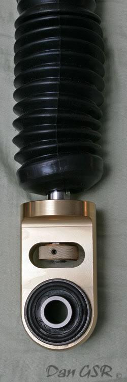

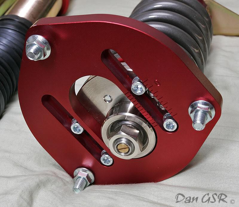

3. Easy access damping adjustment knobs
       Most systems that offer adjustable damping are easy to adjust for the front. But the rear seams to have been a challenge for some manufacturers. Some require you to unbolt the shock from the car to adjust damping. Which is very time consuming. The Cross Competiton coilovers have a easy access adjustment knob on the bottom of the shock that allows quick adjustment without any tools, and takes seconds. Front knobs are in third picture, rear knobs are in fourth picture.

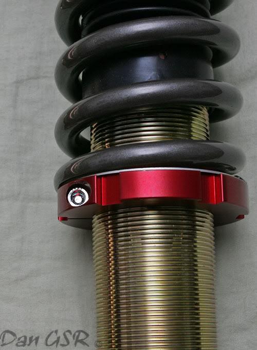

5. Bolt down spring perches
      Most coilovers have spring perches that require you to interlock two perches onto each other, by screwing them towards each other. This often can become loose. The Cross Competition coilovers have an allen key on the spring perch to prevent them from spinning. As seen in the last picture.

to understand this, you have to understand how different coilover systems achieve lowering
most kits ( bilstein, koni, h&r, kw, fk, patec....etc) achieve drop by lowering the spring perch
I will show for example how this is done
in the first picture you see the coilover how it comes out of the box
in the second picture you will see the spring perch lowerd about 2"
this is how the "other" kits would achieve drop
so when the car is taken off the lift and put onto the ground, the shock will compress 2" before it becomes in contact with the sping
Also by doing this you are reducing the life of the shock as it has to work harder to dampen the same amount of force thru a shorter distance
reason why lowering this way is bad? well the shock has about 3.5" of overall shock travel
this will compress a little under the weight of the car, so now you have about 3" of shock travel to work with, now if you lower the spring perch by 2", you now only have 1" of shock travel that you are acutally using, it is VERY difficult for any shock to properly dampen a car with only 1" of shock travel. The longer the shock travel, the longer the duration the shock has to properly dampen a compression cycle.
In this next example you will see how the cross coilovers are superior when it comes to lowering the vehicle without compromising performance of the shock. In the third picture you will see the coilovers taken apart to show how the length of the shock body can be lengthed to maximum height. In the fourth picture you will see how then can be shortened to minimum ride height.  In both settings, shock travel is unaffected. So you have the full 3.5" of shock travel available ( minus droop from the weight of the vechicle).
In the fifth picture you can see the shock assembled with minimum and maximum ride height settings side by side. Again with the same amount of shock travel in both settings. Also by having independent adjustments of body length and spring perch position we can preload the spring. Doing so can make the spring more responsive.
