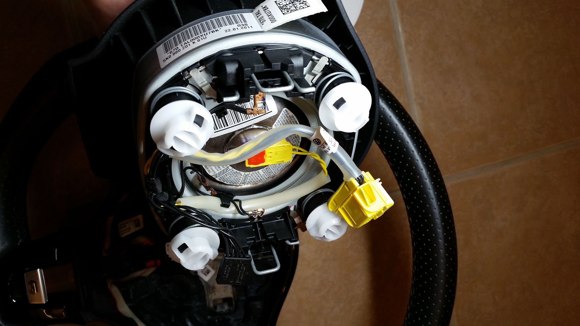

just recently bought a mk6 airbag to go with my wheel but not sure where the pins go on the airbag to connect it up.
anyone have any pics or guides on how to connect the loom to the airbag?

its the only pic i have, hope it helps

@SI-R32 thanks for that I can just about make it out which helps
Can any of the pins go onto where the hooks are? I’m just worried about blowing they airbag once the battery goes on!

When I did mine I put the pins anywhere on the hooks and it's been fine ever since so I'm guessing so !

@Kai96 just don’t want the airbag blowing in my face when I reconnect the battery! Lol

Shouldn't do I remember just plugging mine into any didn't even think about them having a specific placement . Let us know how you get on

@Kai96 fitted it today - looks and feels much better!
No blown airbag thankfully!
Cruise control not working however - not getting picked up reckon might be a dodgy stalk. Horn out of action too..
