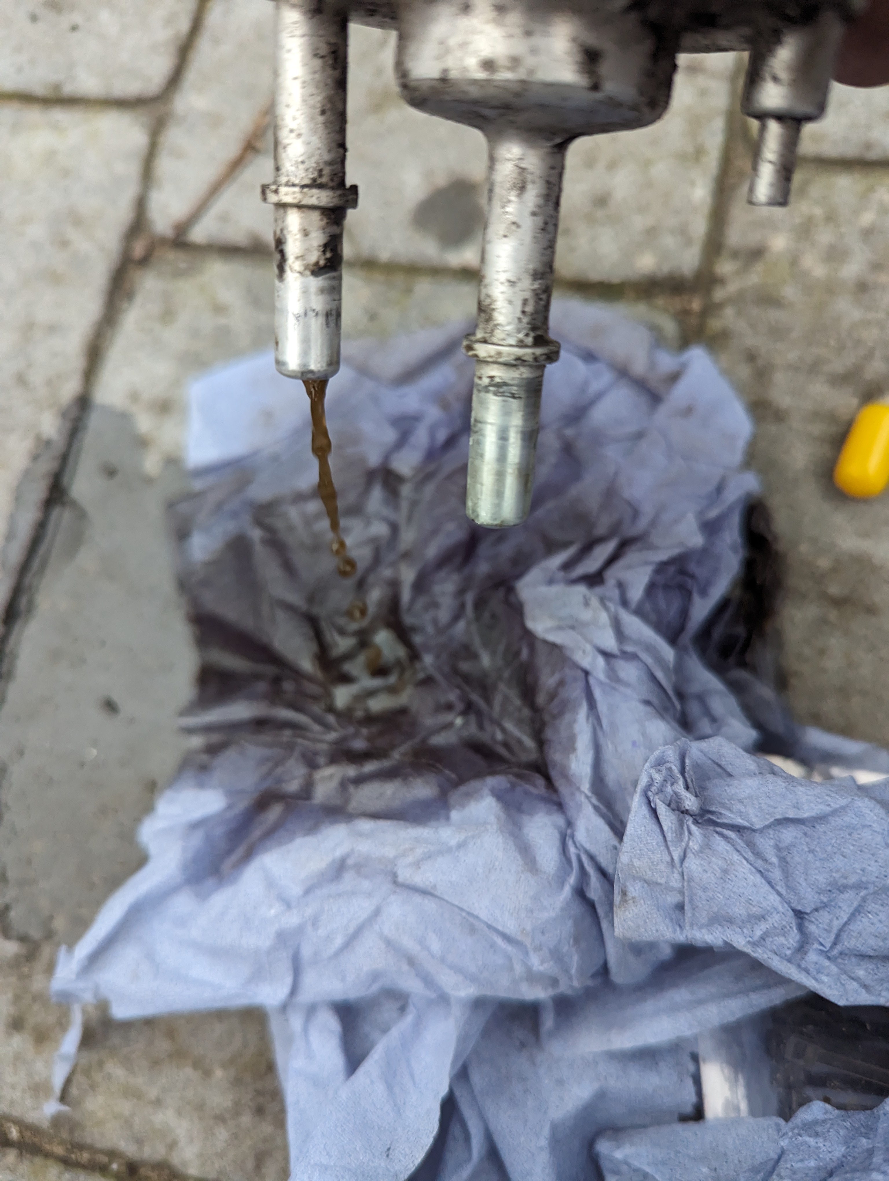

It was time for a major service.
Oil and filter, Millers 5W40, Bosch Filter

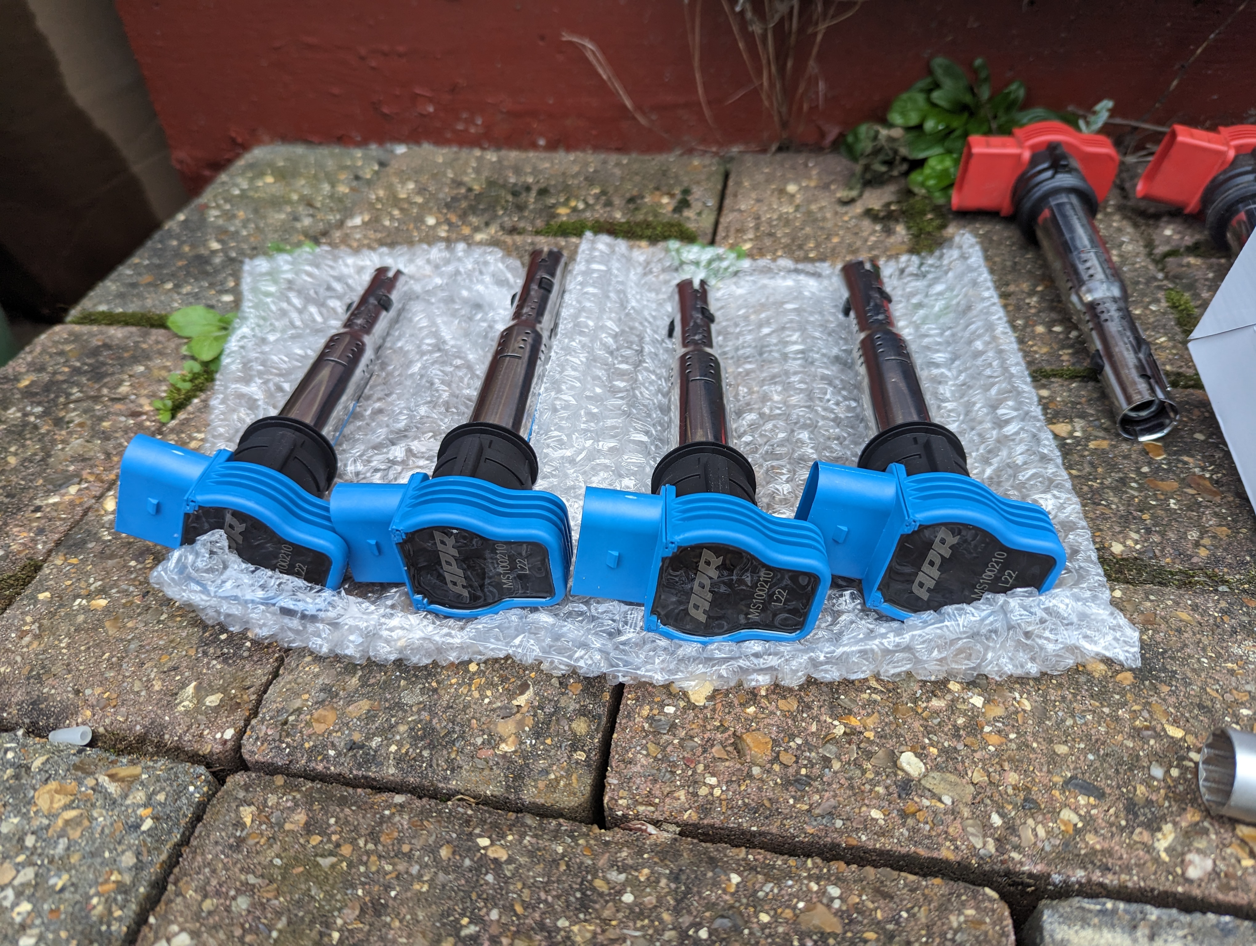

Spark plugs and coil packs. NGK Iridium X and APR Blue Coil Packs
New Filters for the Twintake
New Fuel filter
Bosch Wiper Blades
Replace Forge front to back short shifter since new gearbox, add side to side and solid bushings
Top up Screen wash etc
Tyre pressures
Replacement coil packs were more of a cosmetic decision, but looks like it was needed for one of them.

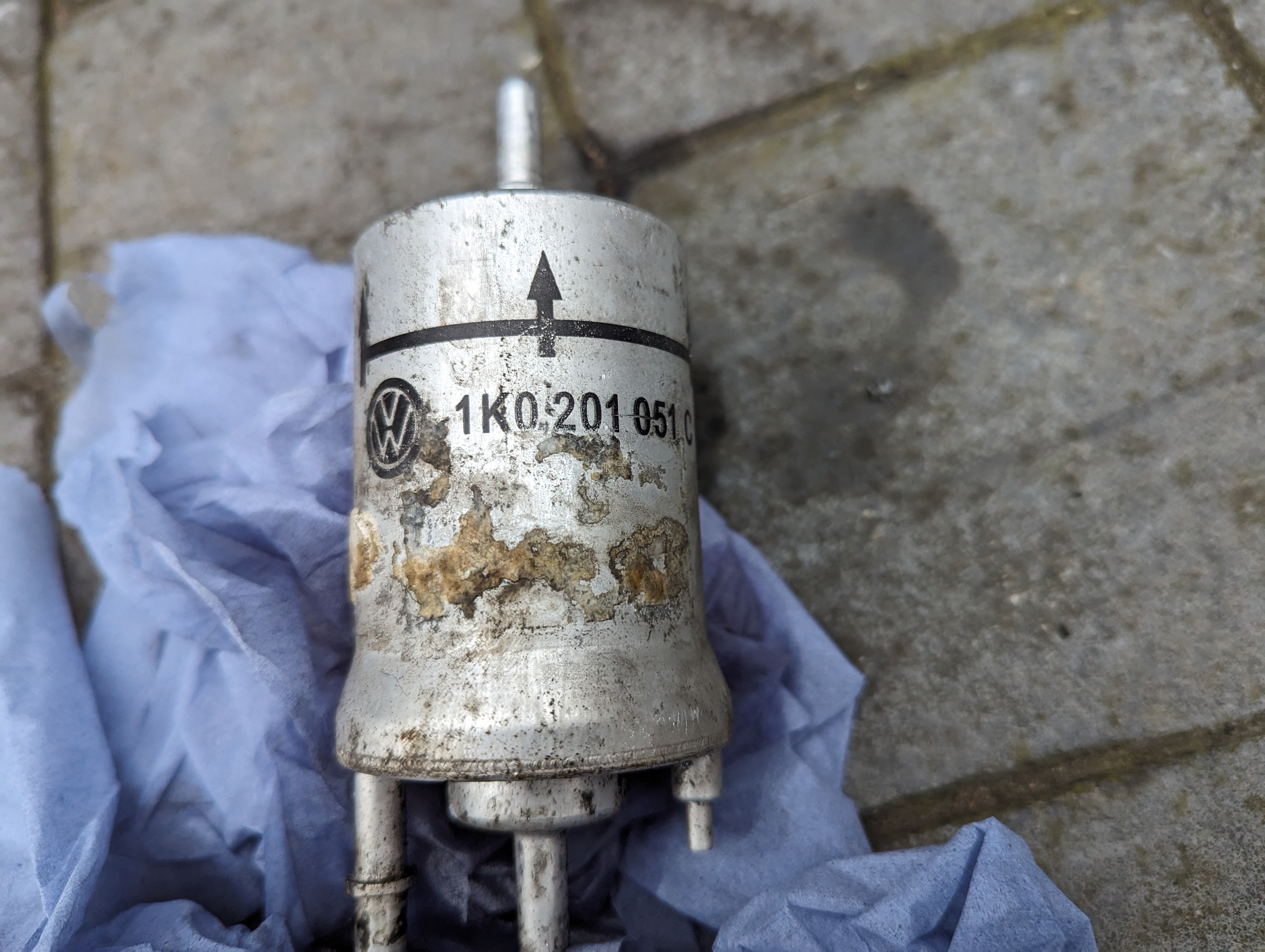

To be honest its the first time ive change the fuel filter myself. Could be the same filter that it left the factory with for all i know, It has VW branding. The one preivous owner had all work done at the dealer though so who knows.
Filthy black fuel, not a good sign. Car defienlty has less lag as i put my foot down now.
And the bottom bonnet latch needed replacing, the sensor cable had broken. (the low oil warning light wouldn’t go away after being topped up as it resets with the bonnet opening and closing.)
The Cam Follower is the only thing I haven't done this time. I have VIS HPFP internals and a brand new Hitachi pump to fit at the same time, the new pump comes with the bamboo fitting attached and I have the ancient banjo bolt on the car.  Once i have the right fitting ill be doing the lot.
