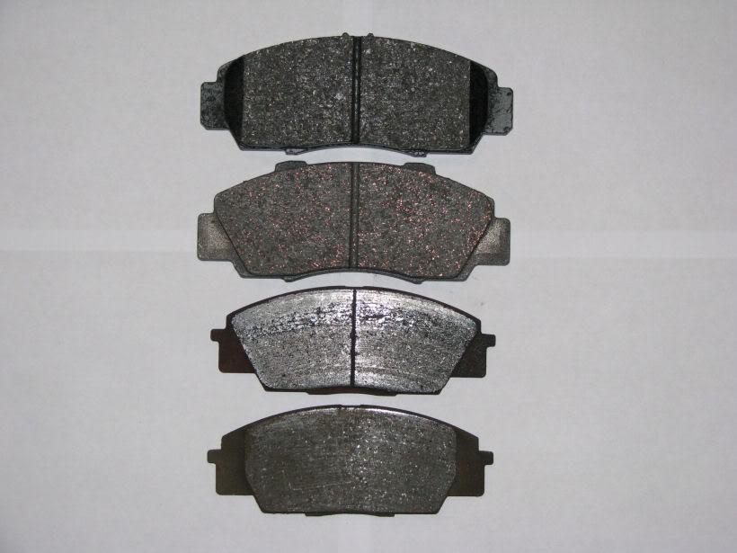

I had the DS3000s and had exactly the same problem with the juddering that your describing,
I ended up putting a leading edge onto the pads (like the top ones in this pic)
Its a thing we do on the pads in the race car to give them more feel and a little less bite in the wet, Matt did mention that the grooves in the disks are at a very aggressive angle, since i have put the chamfer on, the brake wobble has completely gone!
If your running the DS3000 pads make sure you dont let them get glazed tho, they really need to be kept at a high temperature for them to work properly!
Dont let the wobble put you off though, there absolutely awesome brakes and the feel you get from them is mega! (for a survo'd system anyway)

What did you use to chamfer them, Luke? I've got some naughty pads that could do with the bite easing on them.

i am running with DS2500 pads and they look identical with the first pads from top in the picture. I have the same vertical cut through them. Also the DS3000 have the same vertical cutting on the middle. I won't let this problem put me down although the wobble is very hard and the more faster i go and brake at higs speeds the wobble is more powerfull and a dirturbing noise is produced from the brakes.

the pads will have the cut through them yes, but i was talking more about the 45 degree slopes off the ends of the pad, (shown to the left and right of the pad in the pic)
Tony, i just used a bench grinder, you could use a sander or a hand file i guess (be preparred for lots of dust tho) :laugh:
