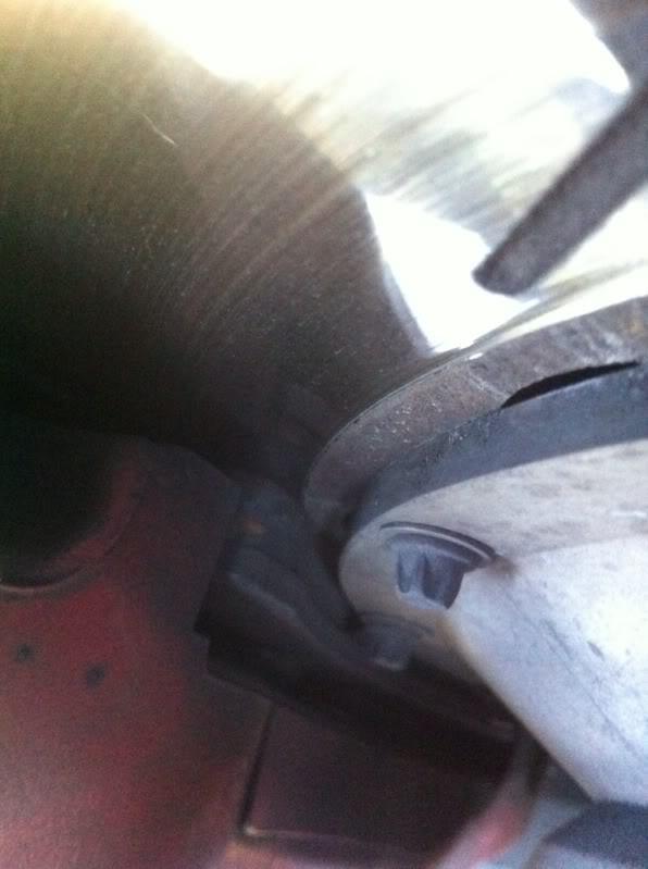

These are mine after over 20k plus maybe near 30k
And god do they stop you quick  :signLOL:

That's a bit crap isn't it.  Do you know if that's being changed at all?
3k road miles and a few trackdays is not really alot of mileage.  So eating an entire pad is horrendous.  Which pads steve?
How come yours and neils have done that but Matts haven't?  Are they the same setup or do you just 'use' yours more than him
To get me through the second day at Spa I had to swap over pads with NeilM, these are going to be coming off the car this week so will be sending these back to VWR as I think it's crap.
The race cars get around it by flipping the pads upside down at 50% life I have been told by KPM. They run the DS3000 and I am running the original DS2500 that are supplied with the kit so it's not down to the pad compound either.

I looked at Steve's brakes at Spa, and it is not right, and IMHO dangerous, unless you are happy to check/change pads more than you change your undercrackers.
I don't honestly believe enough testing and development was carried out.  Porkers/Lambo's don't have this problem.

Jesus, I used one and a half sets of pads for my Alcons in 2 years, and look at the miles/abuse they took!
Sounds to me like they don't back off enough or the piston sizing is on the piss. DS2500s are soft as butter mind when used hard, they'll just dissappear.
