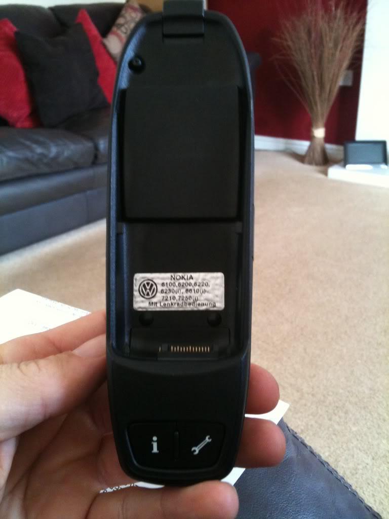

Hi
Thanks for the reply, my cradle is for a nokia 6100, 6200, 6220, 6230i, 6610i, 7210, 7250i and looks like attached photo, also did your adapter look like this when you removed the  nokia cradle
is it a case of pluging the bluetooth into the cradle or the adapter
sorry for all the question as i was at vw yesterday and they didnt have a clue.
stu

mine is different from that, much smaller! my cradle is for a 6230i but is very different from what you have on your car. I will try and get the part numbers for you when i get the car back mate.
Cheers for the reply, is the bit that the cradle attaches to the same(the bit with the red sticker), if so it sounds like i need another cradle like yours then the bury sould slot into that, so the part number would be good when you get chance.
By the way the bury kit looks good.
