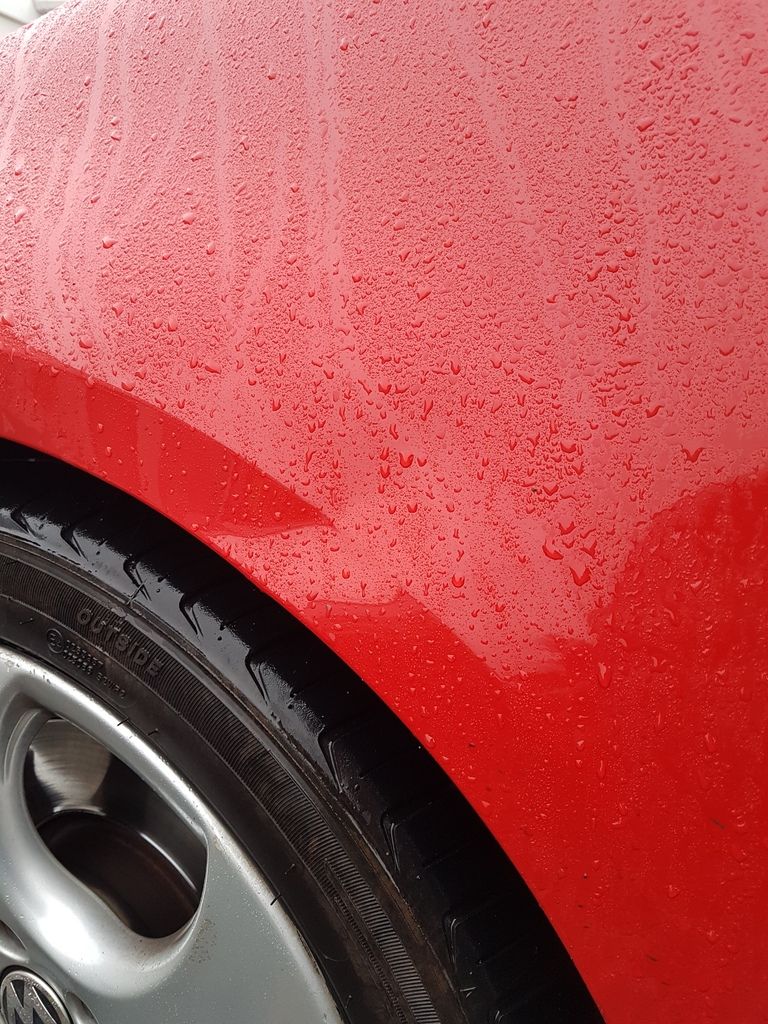

« Reply #6 on: February 06, 2019, 03:02:43 pm »
« Last Edit: February 06, 2019, 03:05:23 pm by DBXdarkangel »

« Reply #7 on: February 06, 2019, 03:08:28 pm »
It's hardly anything on mine. I'm surprised how weak and flimsy the metal is

its not as bad as i'd imagined to be fair. but how bloody annoying!! maybe try tapping it out then, it might even "pop" out, you never know. if it doesn't though and looks worse, go ebay route  :wink:

« Reply #13 on: February 07, 2019, 02:42:12 pm »
Just had a quote of £150 to do the dent with paintless dent removal. Will report back on Thursday next week when he's done it.

That was a good shout about getting a dent man in, don't know why I didn't suggest that as I had one in a while ago to do mine  :signLOL:
Anyhow it's hard to see how much damage there is from your rainy pics but hope it goes ok. Is that price just knocking them out or some paint too?
