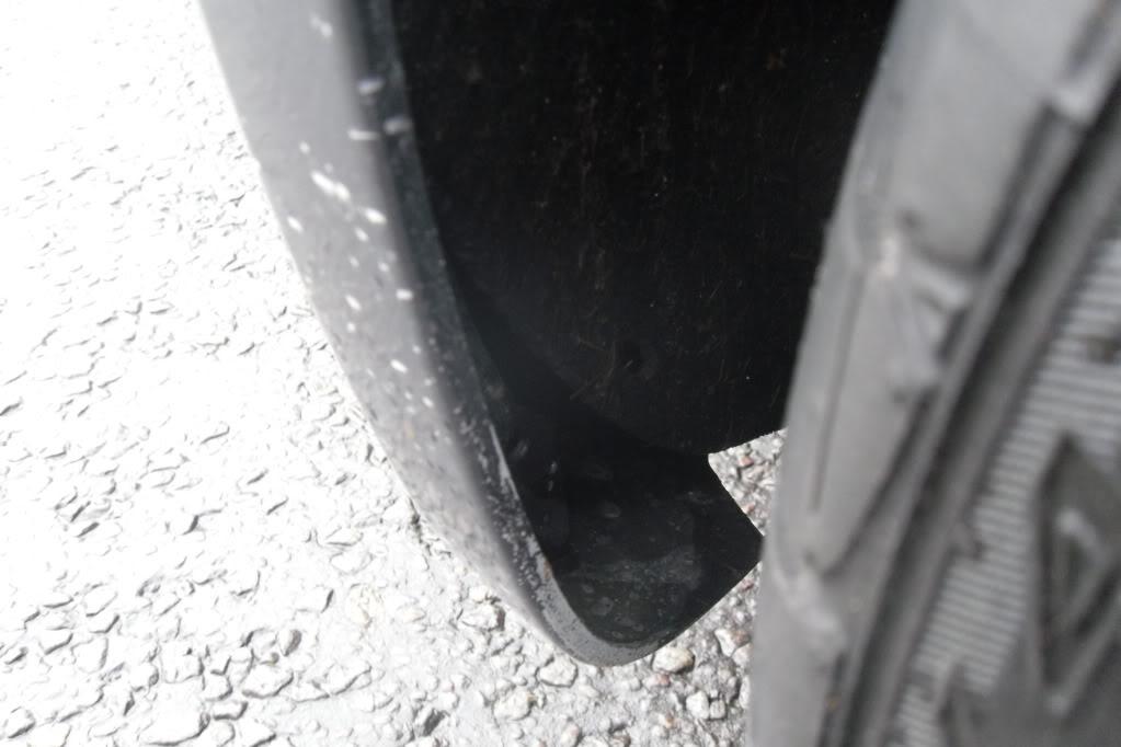

Yeah stick to the GTI valance and get a bodyshop to do it should cast you around £100 smoothed and sprayed which is still £200 cheaper than the ED30 part.
Ideally you need the GTi liners as the gti bumper is a little wider at the bottom so you will have about 1cm gap at the very bottom. I didnt bother changing mine but if you are fussy i belive the gti liners are around £20 each.

Here are the pics of the arch liners on my car excuse the pics a pro i am not :wink:
