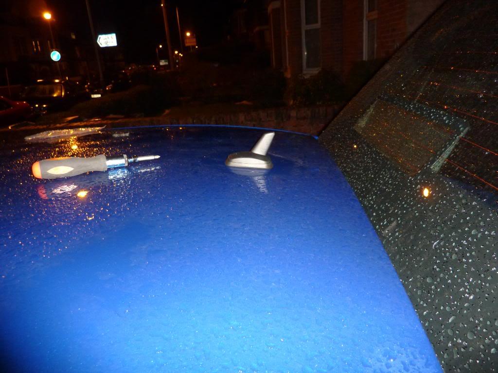

Ok here is the OEM shark fin Antenna - Part no. 1K0 035 507 J

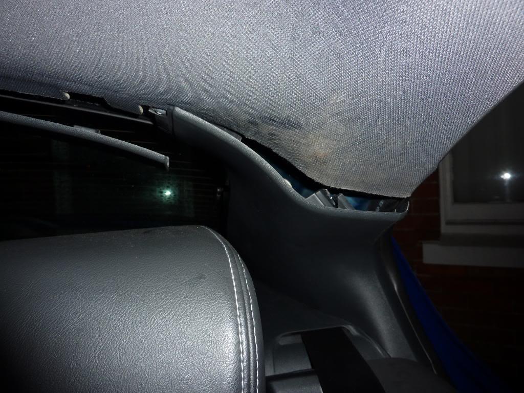

To install this firstly remove the trim from the C pillar and then across the back of the rear windscreen. Oh and that's not muck on the headlining its cos my hands are dry etc from this week so its actually my skin  :grin: oh and it was raining hence the wet bit as one hand was wet.
Carefully then pull the headlining down to reveal the bolt holding the antenna in.

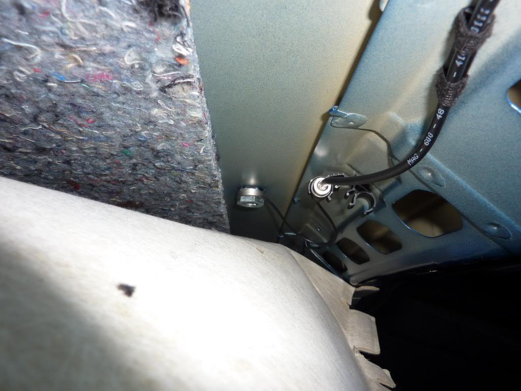

Now all you do is undo this bolt (you require a 22mm socket/spanner). Disconnect the wire. Put the other antenna in its place. Connect the wire and fasten up the bolt. Remember only do it up hand tight then half a turn.

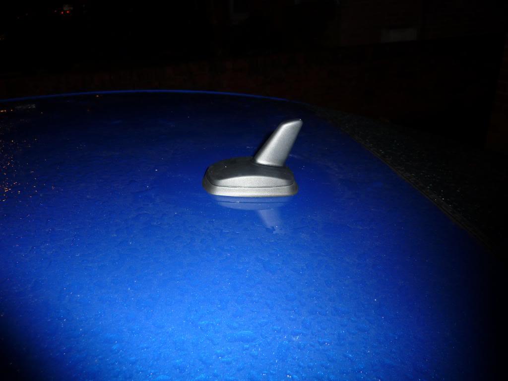

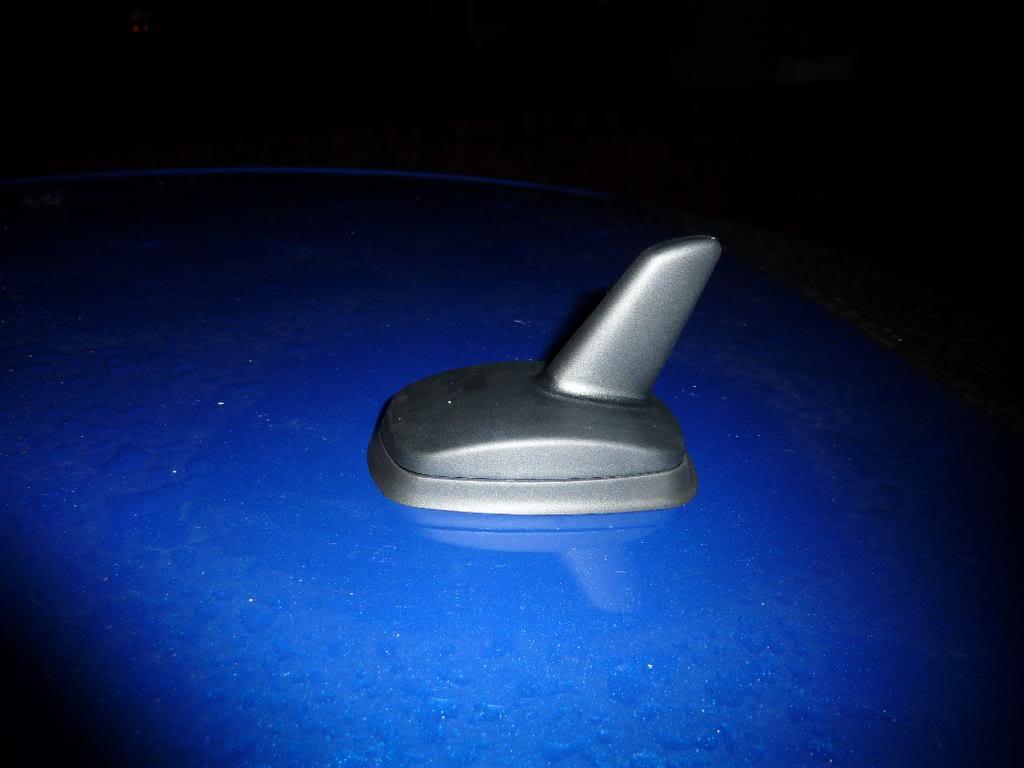

End result is

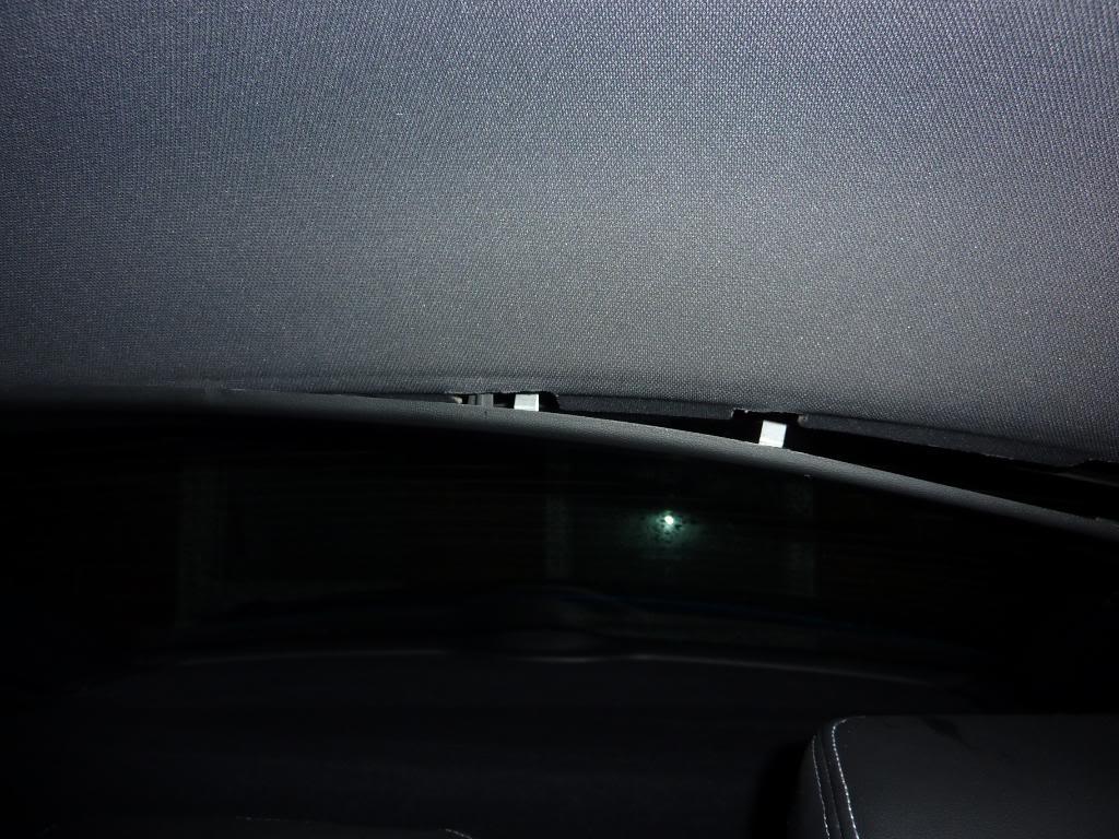

When finished. Carefully return headling back and re attach trim. Took me all of 20 mins and that was taking pics aswell.
Carl :happy2:

I'm not taking the headlining off completely but it will be moved down so i can get access to the bolt and then re-fitted.
I have had it down before in that area when looking for the best position for the GPS Antenna Puck.
Quick question. Is there a specific torque setting or anything like that or is just literally hand tight?

All done and complete

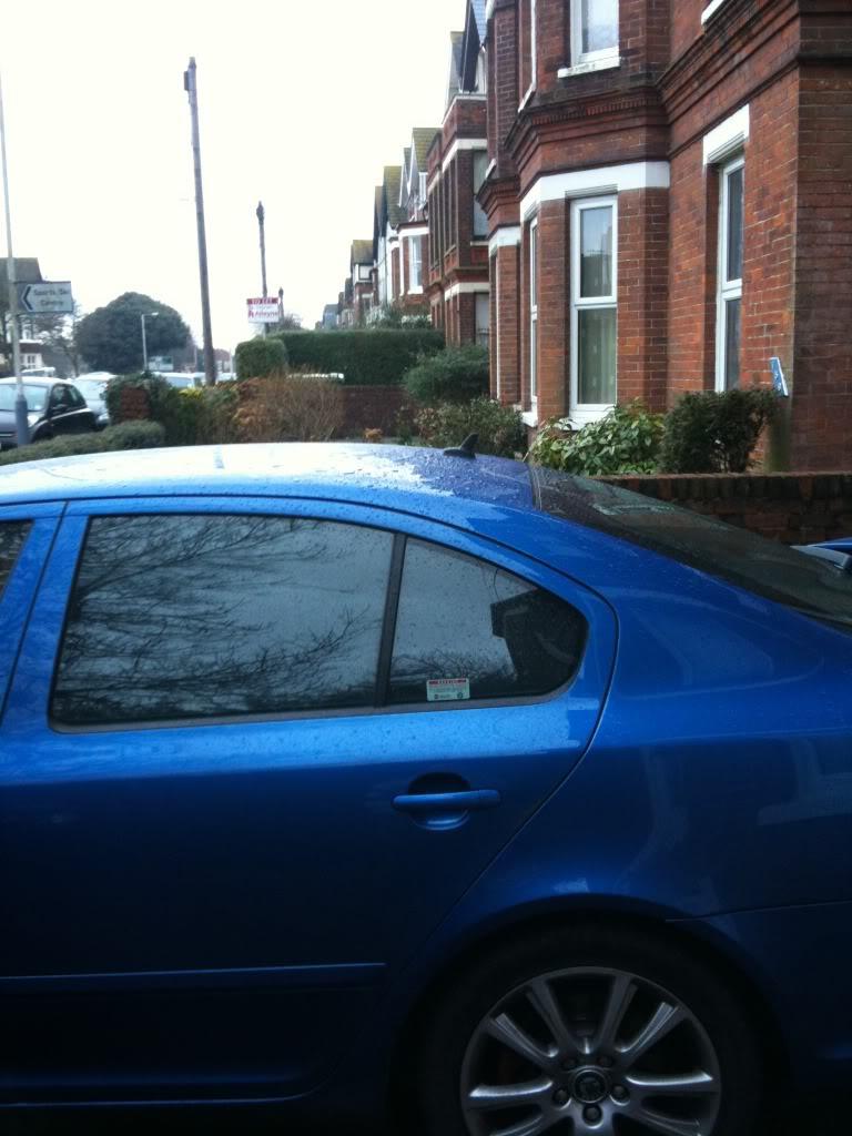

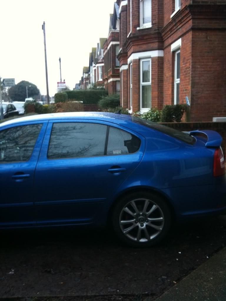

Bit of an Update
The Radio reception is Spot on. No different (well not sat outside my flat) to the OEM antenna

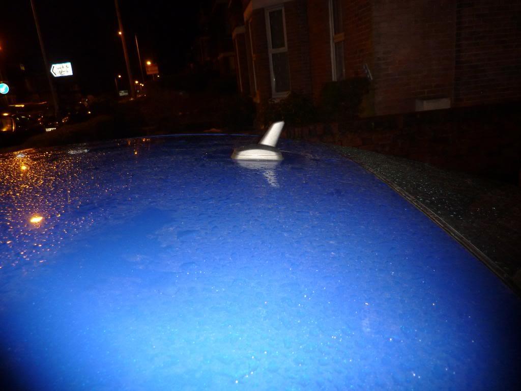

Here are a couple of daylight pics further back
Carl :happy2:
