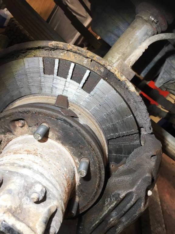

I ditch mine when half worn.  As above, I don't like the pistons extending too far.  Like tyres, brake pad compounds 'go off' from the constant heat cycling, so it's best to bin them off before they even get close to the wear limits.
