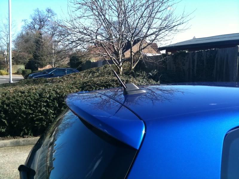

Finally the weather was good enough for me to fit my sharkfin combo  :happy2:
FM/AM works perfectly and I also ran the GPS cable so I don't have to use the 3rd party one above the RNS510 although I don't see any more satellites
Whoever built my car managed to wrap the FM cable around the airbag cylinders making the removal of the old cable harder than it should have been
My version from ebay de also came fitted with the telephone and aux heater remote control, which I left unconnected

Probably because the shark fin is NOT used for radio reception! Even if you replace the standard aerial for a shark fin it will still not be used for radio reception and in the hidden menu's of the higher head units it will say antenna not connected.
Cars fitted with a shark fin from factory use the rear screen for radio and shark fin for GPS  :happy2:

So getting a shark fin combi as in the pic above will not improve radio reception?

pic above is shark fin combo NOT shark fin, so picture above will maintain same radion reception as whip only  :happy2:

I have got a shark fin already, So what is the whip for in the pic?
Better radio reception or better mobile phone/GPS reception?

the whip replaces one of the antennas in your rear window to cut production cost

The whip actually replaced the one in the rear window as the rear window alone is not great reception. The initial rear winodw only was the cost cutting exercise... then VW realised it was not quite good enough and compromised on the shark-fin/whip combo. All the connections are still on the rear window if you want to use them. All you need is another amp like the one fitted to most mk5's windows anytway (all but the most basic use one on the rear window, the shark-fin equiped cars used 2)
