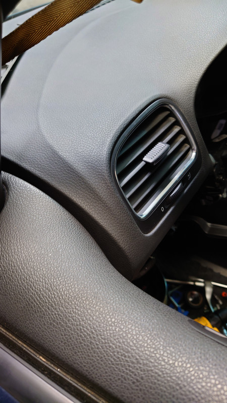

Well over the Easter Bank Holiday weekend I successfully installed the Mk6 dash  :happy2: So, as there is not much information out there I thought I'd do a little 'How To' for anyone considering the swap in the future. There are a few ways to skin this cat depending on your preference but Ill try and outline the different options, what I found and ultimately what I did along the way. So first things first...

I think that gives you as much information as I had/have but Im bound to have missed something so feel free to ask anything below and I can always update the guide as necessary. Some pictures below to show the transformation. At this stage Ive lost the Sunlight Sensor I bought from Germany and we're in lockdown so cant go anywhere to get the clocks coded but once both are complete Ill update the pictures!
Preview of the clocks -
