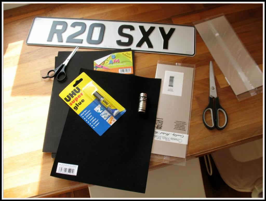

Tools and materials needed.
Alu numberplate from Dubmeister.
Alu inserts found in Hobby shop.
adhesive backed foam sheet.
adhesive backed felt.
10 magnets.
and the appropriate glue.  :happy2:

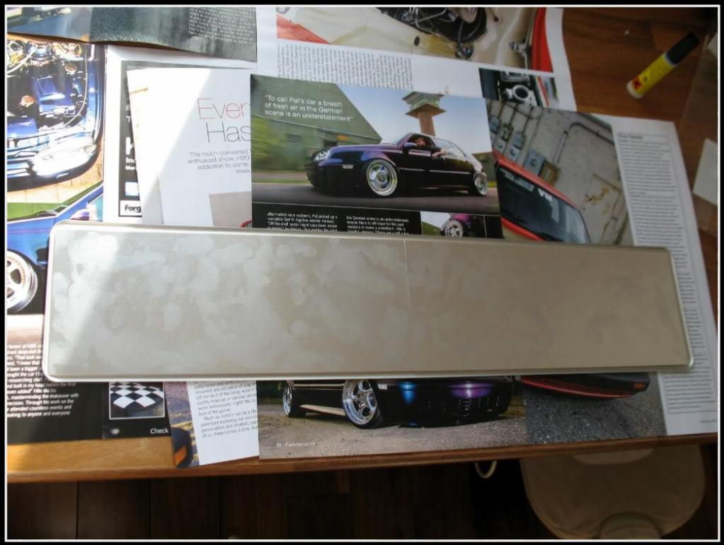

The magnets i have used are too strong really. I used the correct glue but because of there power, they had pulled off the plate a couple of times. Also after a time a mark had started to appear on the front of the plate,  the plates are alu and very thin, not much thicker than a can.  :chicken:. So this Mk 2 version needed beefing up.
I Started off by backing the plate with these alu strips i found, hopefully this should give the plate a bit more solidity and stop the dark marks coming through the front.

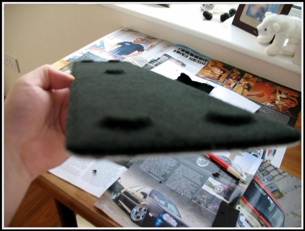

Next is the added extra, i found some adhesive backed felt and put this over the magnets, hopefully this should cure the magnets pulling off the plate, and also help protect the mask as well.
 That is the main bit done really, the only thing left is to stick the other 5 magnets onto the back of the mask.
