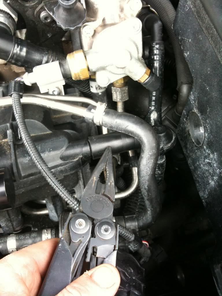

Yes i had something similar not so long ago and this pipe had a hole in it. Once replaced all was fine.
So i'd check that. Mine had only gone though as i once had the Forge DV on there before relocating the DV to K04 position (i've got a Skoda Octavia which has the K03s Turbo) and think i may have been over zealous with the jubilee clips
Not saying it is that but it's something to rule out.

If the problem is still there then even if the fault is cleared and the light goes out i would be pretty sure it would come straight back (or fairly soon anyway)
To check if it is that pipe start the engine and put your head near it and you will hear it hissing. The hole could be at the back (which mine was) and may not be visible until removed.
